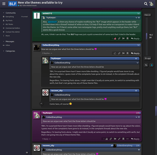

New site themes available to try
I think I got mobile support working. At least, it works when using ?mobile_view=1 now.
Also, I figured out how to theme the scrollbar(s) and timeline slider… which I just now noticed also affects the editor, so the scrollbar there now fits the theme too.
… and the post editor:

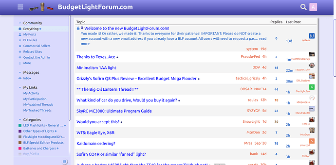

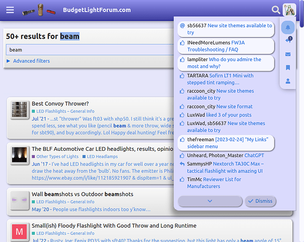

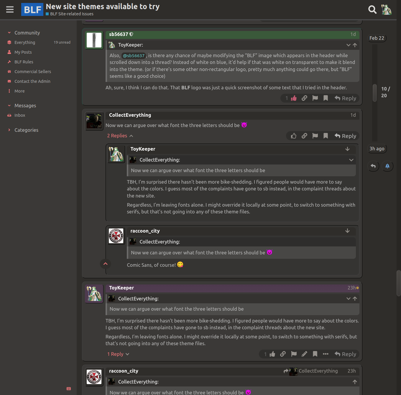

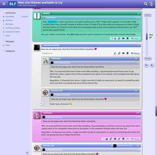

Just a few more screenshots, showing some different views…
The editor in night mode. Also, the “last visited” marker, and the minimized timeline progress bar.
Another night mode shot, just viewing an old thread. This shows a wider view than prior shots; it can extend pretty wide before it starts putting space on the sides. Also, the shadows really make it look like each post is a separate card floating above a dark backdrop.
Day mode, with a few regular posts and the timeline slider themed to look more like a scrollbar. Embedded posts are inset to make it clear they’re contained within a parent post.
It has been a while since I did any stylesheets, so I’m having fun. There aren’t many parts of the site left to theme though, so I think it’s getting close to done.

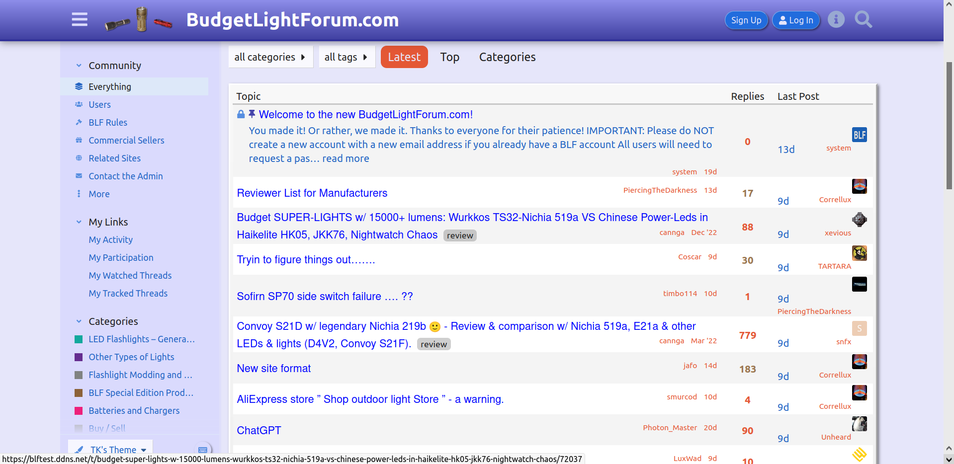

I finally got around to adding these themes server-side on a testbed instance. It looks like they apply fairly cleanly and generally seem to be very close to what @ToyKeeper intended. The only error was with this single line:
.contents.ember-view, /* front page topic list */
The Ember.js framework generates CSS dynamically, so CSS rules for Ember elements can’t be specifically defined. I imagine that’s the reason for the problem with vertical centering of some of the information in the Topics (Latest) list:
Would there be a generic non-Ember selector for those frontpage elements?
Another little problem (at least in this server-side implementation) is the N / T post indicator in the timeline slider that is missing the T total value.
I haven’t played around much with the color scheme, not sure yet if I’ll add the color definitions directly into the Theme Component (which would require two copies of the theme for Light vs Dark mode since the colors would come directly from the theme and not from a separate named color scheme) or if I’ll try to add a named color scheme to go with TK’s layout CSS.
I tried to find one originally, and failed, but I’ll have to look again.
(edit: okay, that wasn’t too difficult… fix uploaded)
I noticed that was getting cut off sometimes, and fixed it. The code is updated on github.
