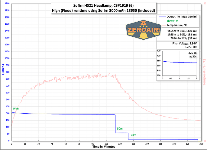

Here is ZeroAir’s review of this headlamp:
