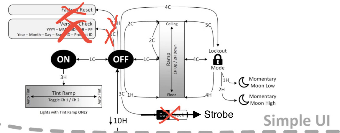

This would be an example for a simple UI mode, I have read in Github extended simple UI mode.
Then you have to add the battery check etc.
I have eliminated the factory reset because on my lights I do it by removing the tube and put it in by pressing the button.
The battery check no one used it in my field test, no one cared about it, take spare batteries.
