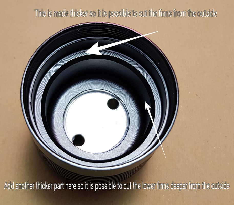

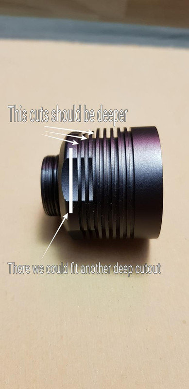

I think i found a way to improve heat dissipation (without changing the look). But i only have my tablet with me in hospital. So i search for someone that can help me to make a pic or 3d model to show BLF (and LuckySun if most people think its a good idea) what i have in mind.
If you want to help please PM me.
I hope it is clear to see on the pictures what i have in mind.
By adding material on the inside (creating another 2mm step a few mm below the first one) we could cut the lower finns deeper. So more surface area is in contact with the air (better heat dissipation). And if we make the driver cavity 2mm less deep we could add this 2mm to the led shelf (it is very thin at the moment).

Do you have the ability to test the effect of various fin designs? I’m not an expert in the field but my engineering background makes me suspect that if you decrease the spacing or deepen the fins, it may not have the airflow and thus, the heat dissipitation you want.
Logically speaking, what deeper fins between the body and head can probably do is lessen the heat transfer from the head. Decreasing the mass snc increasing the fin area there “should” help out by keeping the body cooler…and holding it longer.
Thermal cameras and empirical testing is our friend. ![]()
By adding mass on the inside before cutting the finns deeper from the outside the total mass stays ~the same.
Only the surface area on the outside increases. But i agree with you. If i would only cut the finns deeper without adding mass on the inside i would probably reduce the heat handling capabilitis.
And adding 2mm to the led shelf (from ~1mm to 3mm) should help increasing the heat transfer inside the head.
