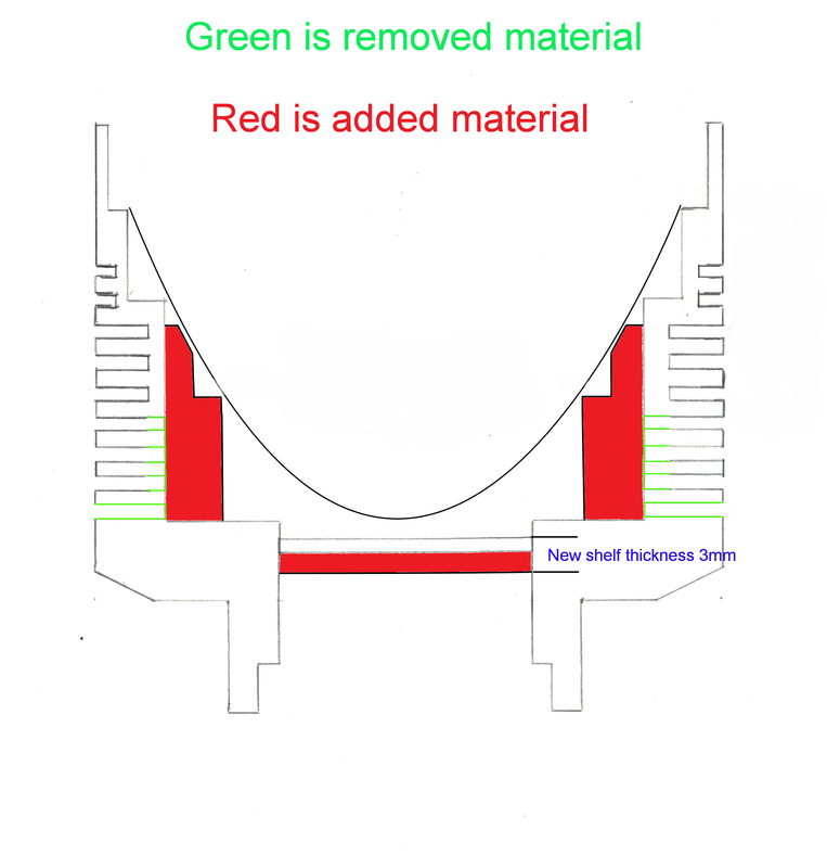

If someone can implement a stepped design instead of the tapered section (my cousin did) i could send it to LS. I tryed to do it on my tablet but it looks crappy. And i do not have a laptop with me in hospital. I would also prefer a stepped design because it makes it easyer to mod the head with spacers (for tripple or quad optics).
But i need help to change the drawing. Or can someone name a good app for android so i can give it another try myself.
That looks good to me, much better than having to fill the whole cavity with a heavy spacer.

Can you modify the cooling fins on the left side of your drawing to show any changes you might have in mind?
Exactly, even 70% effectiveness will be a big improvement over what’s there. In the end we’re going to overheat it on turbo anyway.

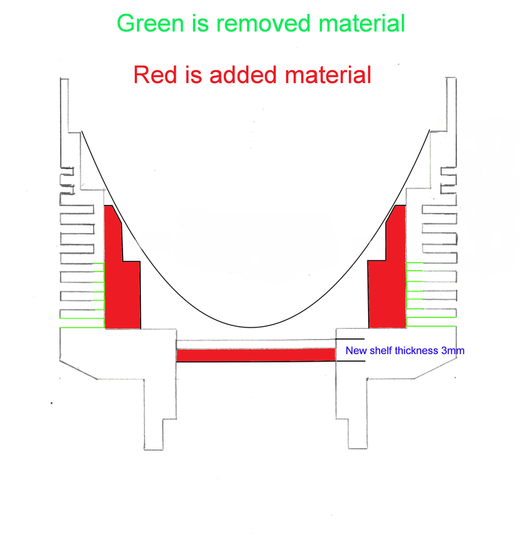

Here the last drawings. Added less material on the inside and removed a little bit on on the lower finns.
I have seen what you were refering to djozz. Now it should be better. @Spartan
Most people and LS fear that the head is becomming to heavy. So we reduced the mass a bit. But we still have improved the heatpath.

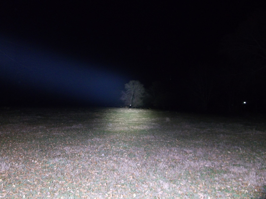

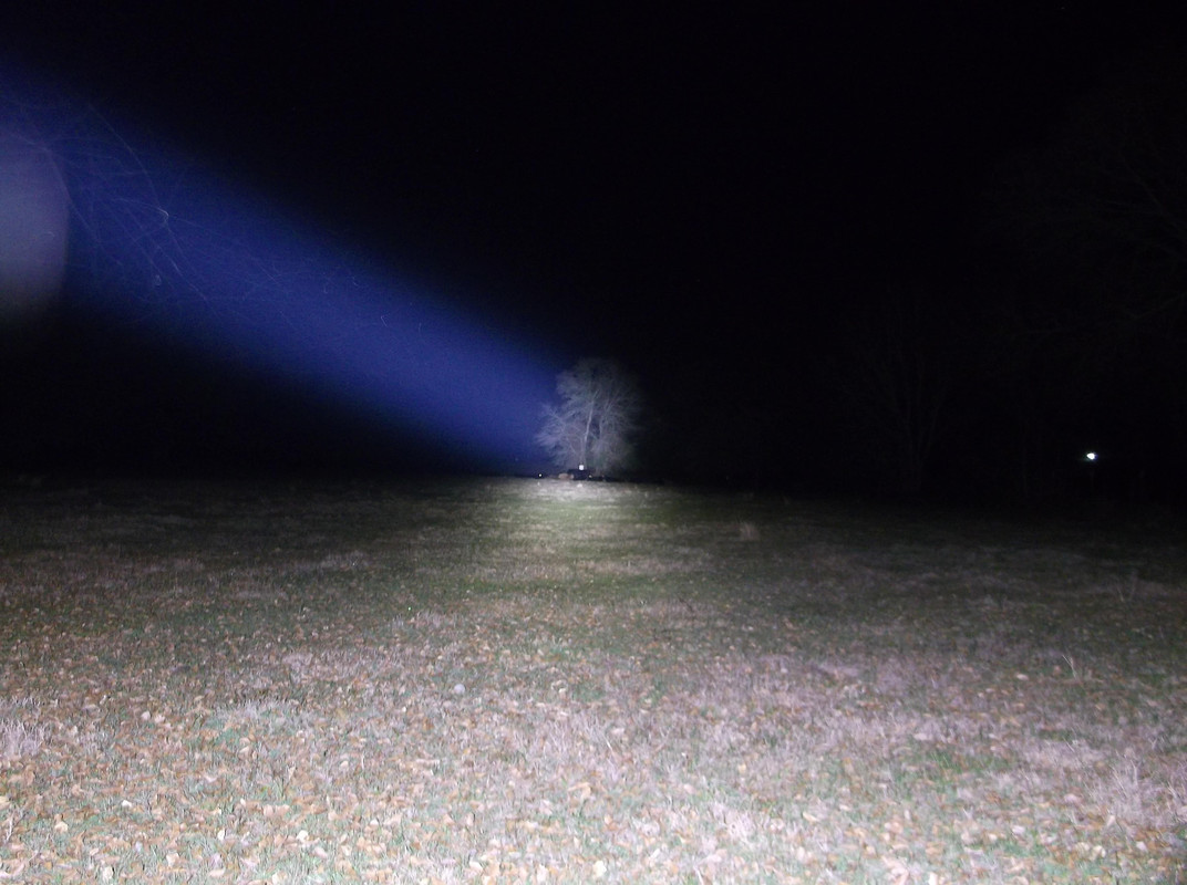

I like my D80’s and with some simple tweaks they can do some serious throw for their size, as has been discussed already. Here is the 2 that I got from the GB , with one being totally stock and the other one I modded with FET driver / XPL-HI 1A emitter (on Noctigon) , spring bypasses and did just a little bit of sanding on the bottom of the reflector and centering ring to get the focus dialed in.
Original D80 Left / Modded right,
Original D80 175 yards………
Modded D80 175 yards……….
