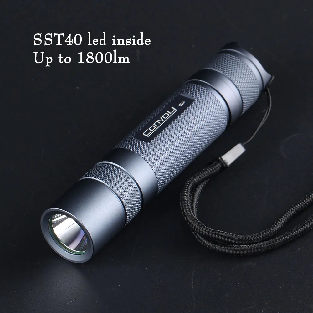

I recently got a Convoy S2+, 12 group firmware. I initially saw it had some kind of memory which you can enable or disable. Great, or so I thought.
Now that I’ve gotten it and paid closer attention, the memory is “next mode memory” rather than “last mode memory”. With memory enabled, next mode memory means every time you turn it off and turn it on, it will use the next level in the sequence. Why is the world would anyone want NEXT mode memory? What usecase does this solve?
Last mode memory makes sense, as long as the memory excludes strobe/turbo. But next mode has me perplexed.

I can think of a couple of ways NMM would be easier to code (one less timer) than regular mode memory. That would be my guess.
ETA: Are you sure it’s NMM? Or are you maybe turning it off too quickly (which can look like NMM)?
Sorry, which flashlight is this?
I have my flashlights mixed. CONVOY S2+. Edited my original post, sorry for confusion!
Ah, yeah you mean easier to implement. It’s definitely next mode (both behavior and product description).
Care to share a link where you bought it. 12 mode groups is usually a Biscotti driver. No NMM there that I can remember. Been a while since I bought a S2+ though. Lighted tail switch maybe?
Preventing NMM in reverse clicky lights would require a timer running when the light is switched off. Can be a capacitor discharging, or one keeping a timer alive. Open source firmware is available for this, just takes a µC with a free digital input pin and a capacitor if I understood Lexel correctly. Or a µC whose timer can be kept alive by a capacitor.
Yeah, got it from Aliexpress:
That is the linear FET driver (formerly 4 mode driver). I would be surprised if it was designed with next mode memory. Maybe there is something wrong with your light. Ask about it in this thread and post that same AliExpress link.
Never heard of any Convoy lights ever coming with NMM, not even the much-loathed 3/5-modegroup drivers.
Might be a counterfeit, or might be a legit but buggy light.
I have two lights with the Convoy 4-mode CC driver and neither has NMM.
How long are you waiting between turn-off and on? Like most tail-switch lights it takes a few seconds of “off” time before memory is activated vs simply cycling to the next mode.
If it turns out to be a buggy driver and you are in the US I don’t mind sending you another driver. Will save you some shipping time if you are. I don’t have any of the 4 mode only drivers but I do have some 3/5 mode and some Biscotti 4 and 8 chip drivers. All guaranteed to be NMM free. :slight_smile:
Adding a lighted tailcap without a bleeder resistor will certainly make it NMM. I found that putting in a 470 ohm resistor makes Biscotti on a Convoy driver behave like its suppose to.
it can be - like other said - that you are not waiting long enough before turning back on
usually 2 seconds is long enough, if it is longer, you may have a malfunction
( these time periods are usually set with a capacitor/resistor pair, if one is the wrong value, this can happen like yours is doing )
try leaving it off for an hour, 2 hours, 4 hours etc, and see if there is a point where it is same-mode and not next-mode
as far as i know next mode is a thing of the past unless in really really cheap lights
convoys should not be doing it
