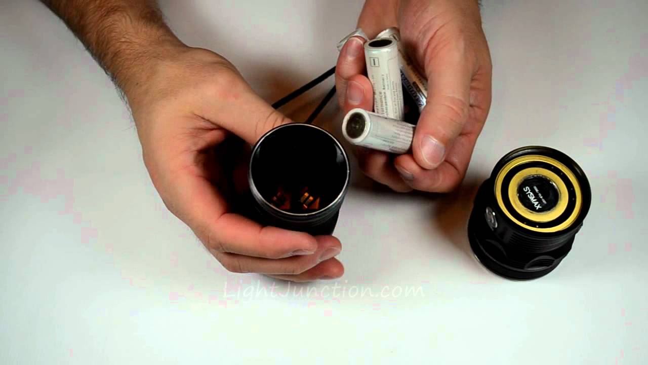

Interesting:
It runs on 4 x 18650 AND 8 x Cr123A, BUT this guys says it can run on 1 x 18650 or 2 x Cr123A also.
It's 4-cells in parallel, that's why it's ok. 1-2-3-4 all can run. Driver is smart to detect cell voltage, like the TK70 it would just not run and kickdown to the next mode if the sag is too much.
If they are in parallel , how can 4V run 3 x XM-Ls?
Not if, they are. Probably LEDs are parallel too.
I see , all the positive ends are making the contact with the same ring on the head.
The driver boosts the voltage. This is what the TK70 does, it can actually run with just 3.4-3.6V under sag 3-cell (Alkalines) and is runnable with 1 x Li-Co. It is wired in series.
