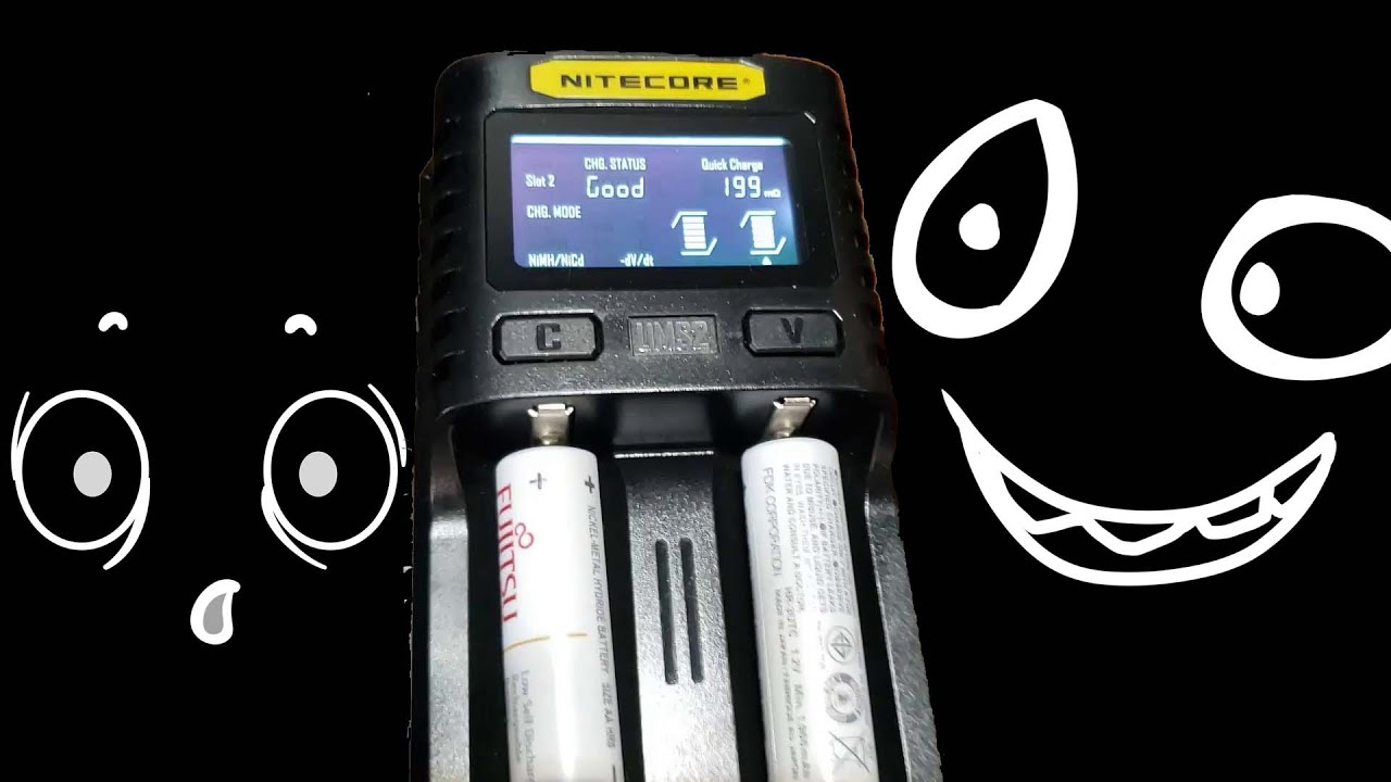

Hello, has anyone experienced problems while charging NiMH batteries with the UMS2? My charger doesn’t stop when the batteries are full—it keeps charging with overcurrent, screen flickering with buzz noises, and the batteries get really hot.
example with same problem in the following videos (the author is not me):
My batteries are new and have charged without issues using the SkyRC NC2200 (Eneloop white, Fujitsu pink, Ladda 1990, and 2450). Any advice would be greatly appreciated.
