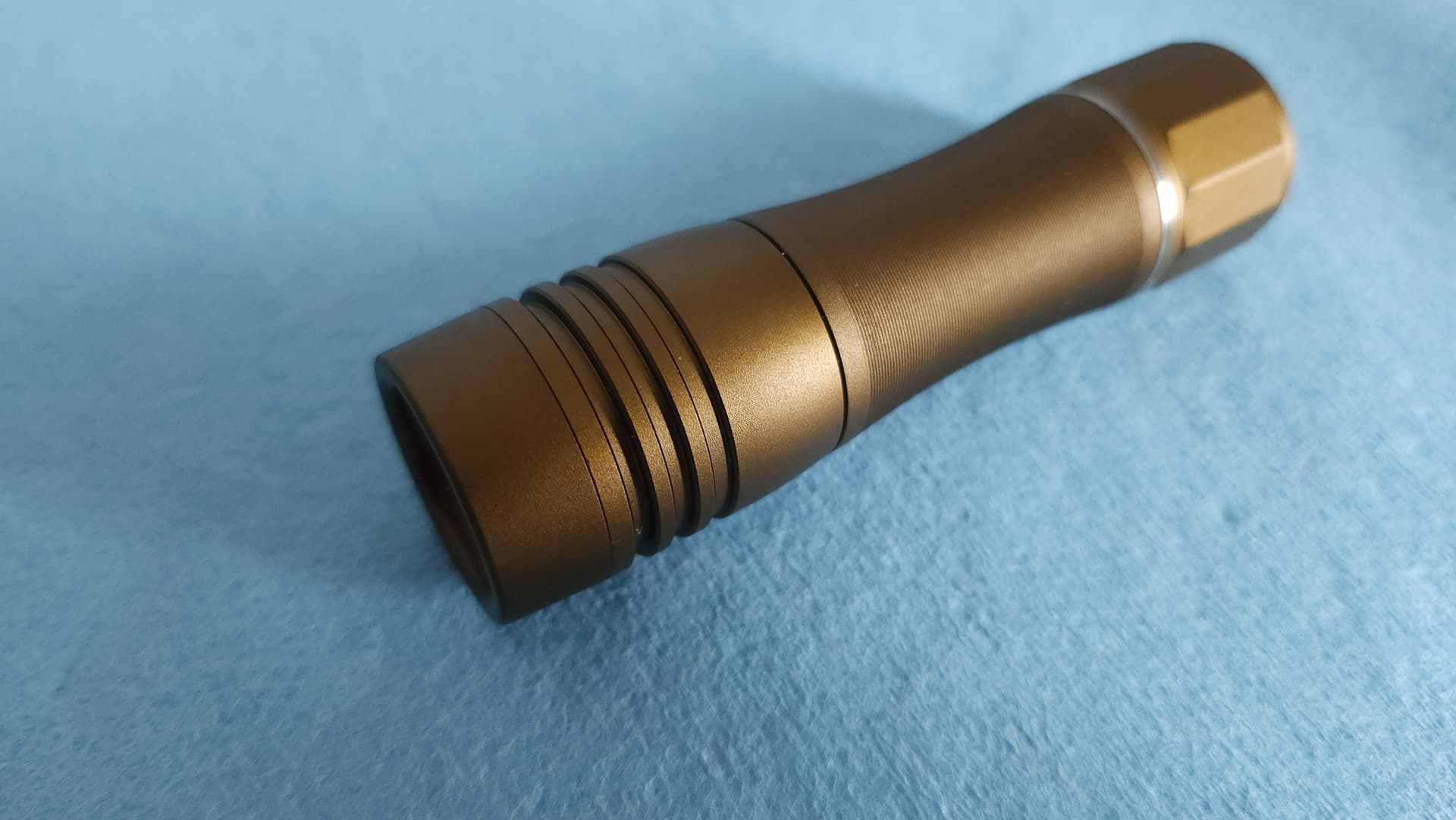

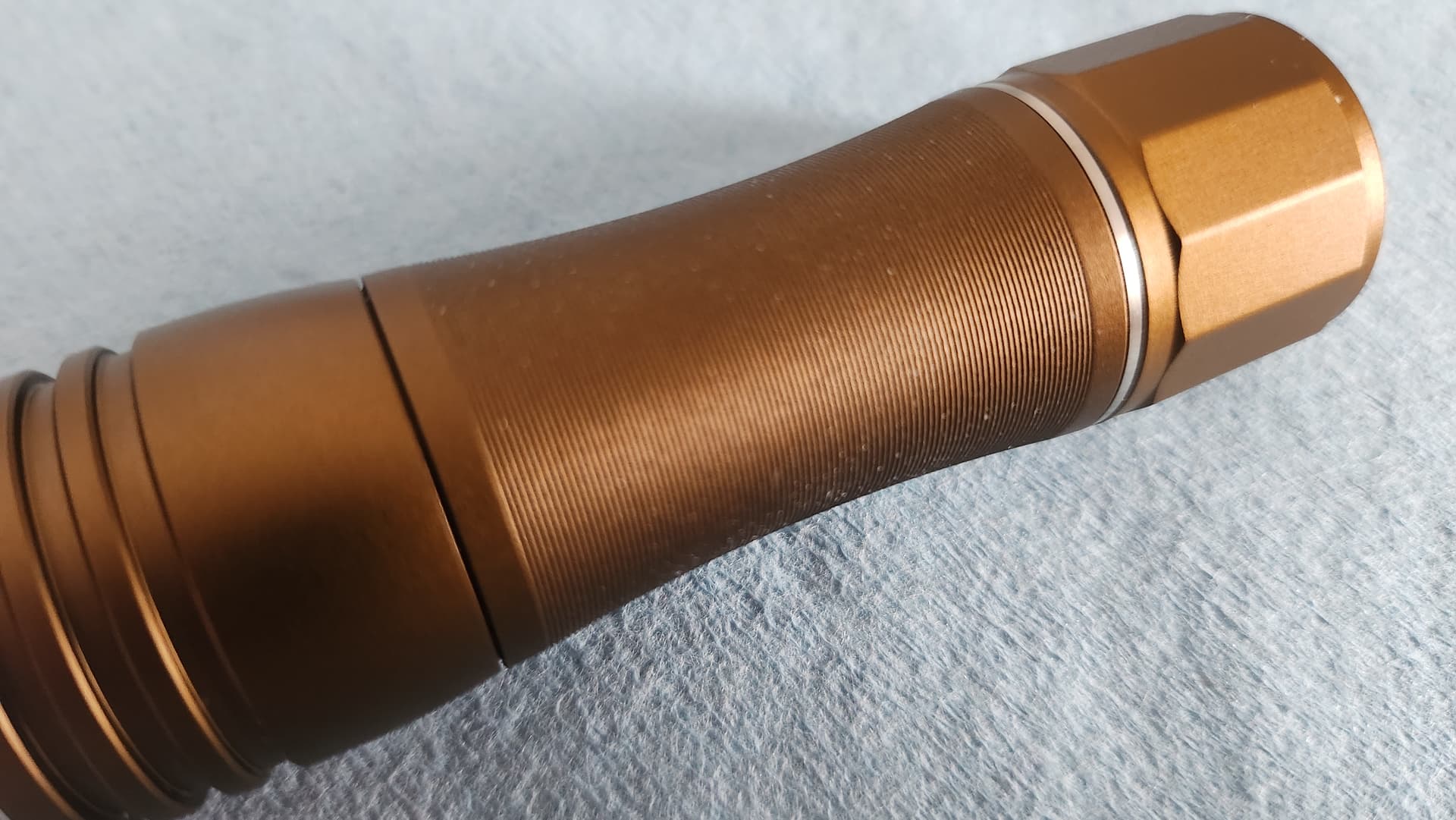

Ughhhh it’s doodoo brown :smiling_face_with_tear::cry::sob:
At least no one will steal it…

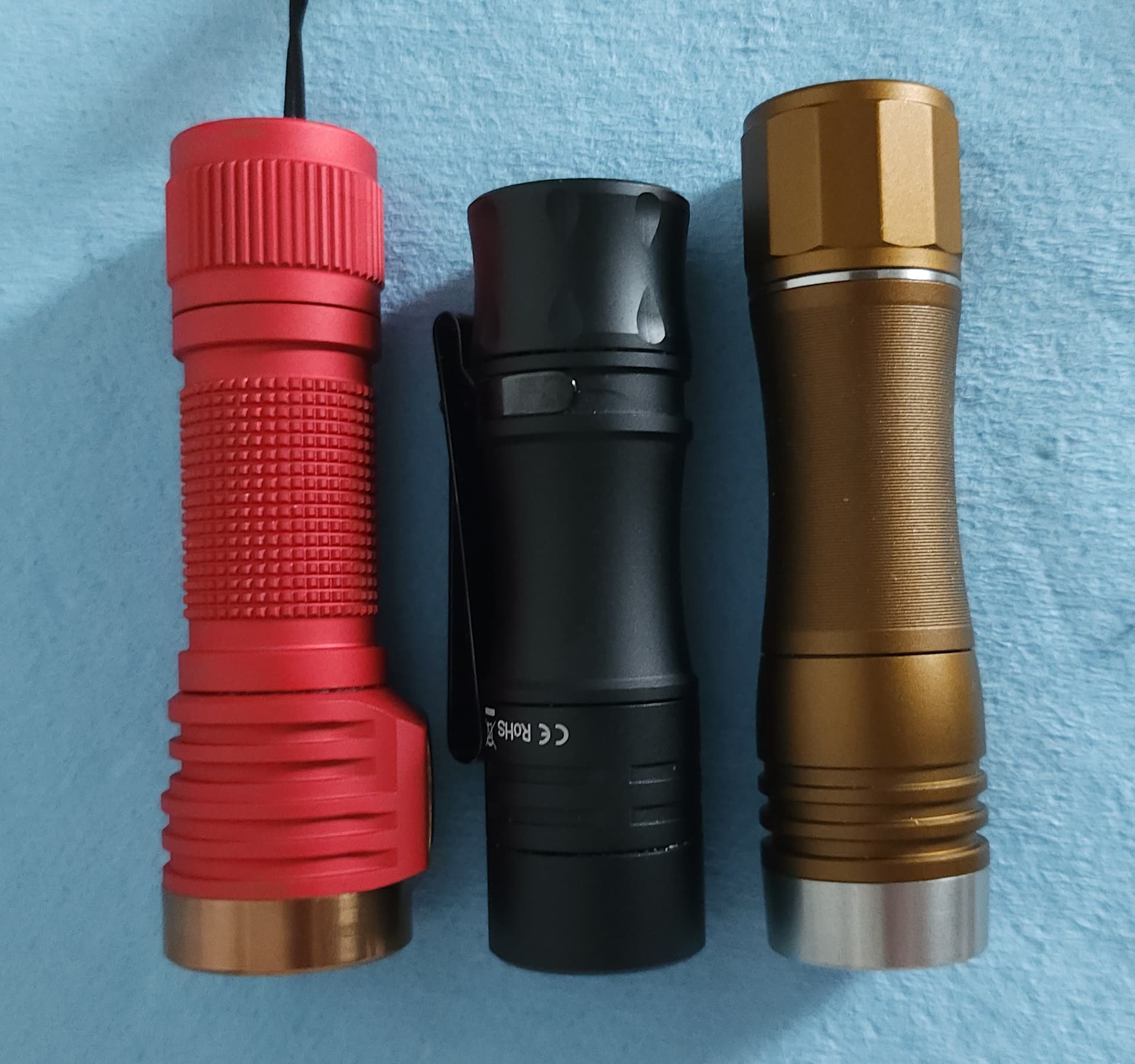

Size comparo.
(With Olight 2500mAh NiMH in either light, d3aa Al bezel is 72g, kr1aa steel bezel is 69g. The Al bezel on its own is roughly 1+ grams, but by handfeel weighs roughly 1/3-1/4 as much as the steel.)

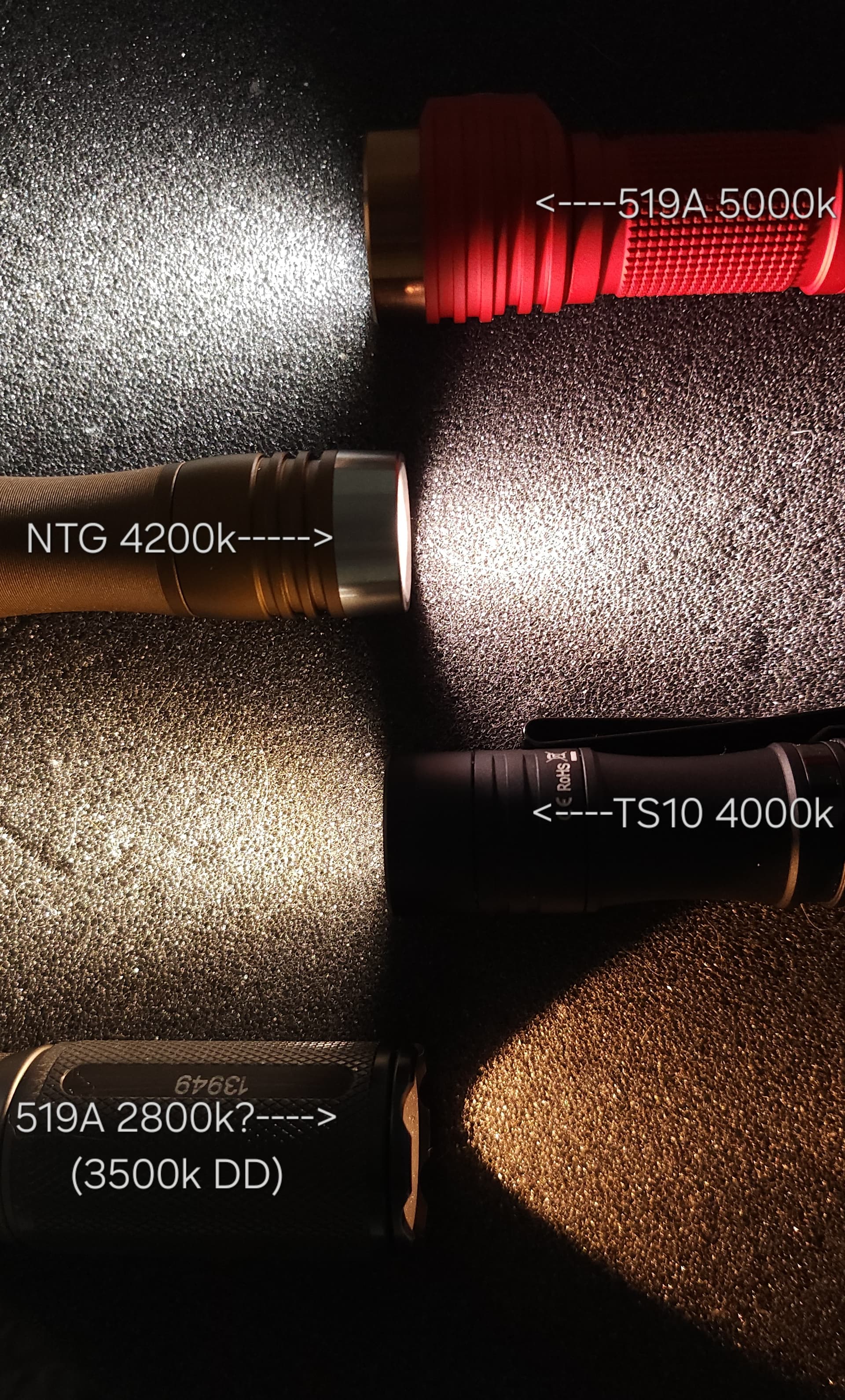

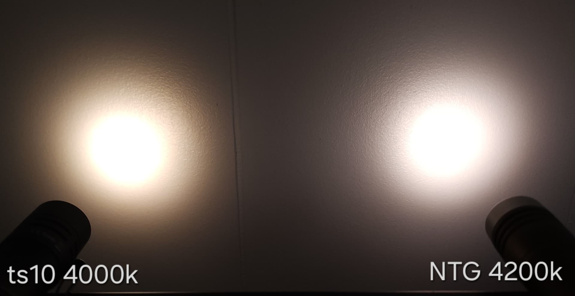

CCT comparo
Quick summary of impressions:
The NTG 4200k is rather rosy rather like a very pale end of a cherry blossom. **-It makes the TS10 4000k look like pee in comparison…what a combo, pee and poo, lol…although, it’s not a fair statement, because even relatively neutral DUV like the Nichias in my D3AA look kinda green in comparison- The body ridges lend well to the cigar style grip, and the switch feels similar to a camera shutter button, feels exactly as expected, like a membrane infused eclicky. The sound tickles my brain, if not for the slight grindiness of metal on metal. The threads are quite thick and squared away.
The inner body tube could use some work, as it’s kind of gritty looking…so far so good though.

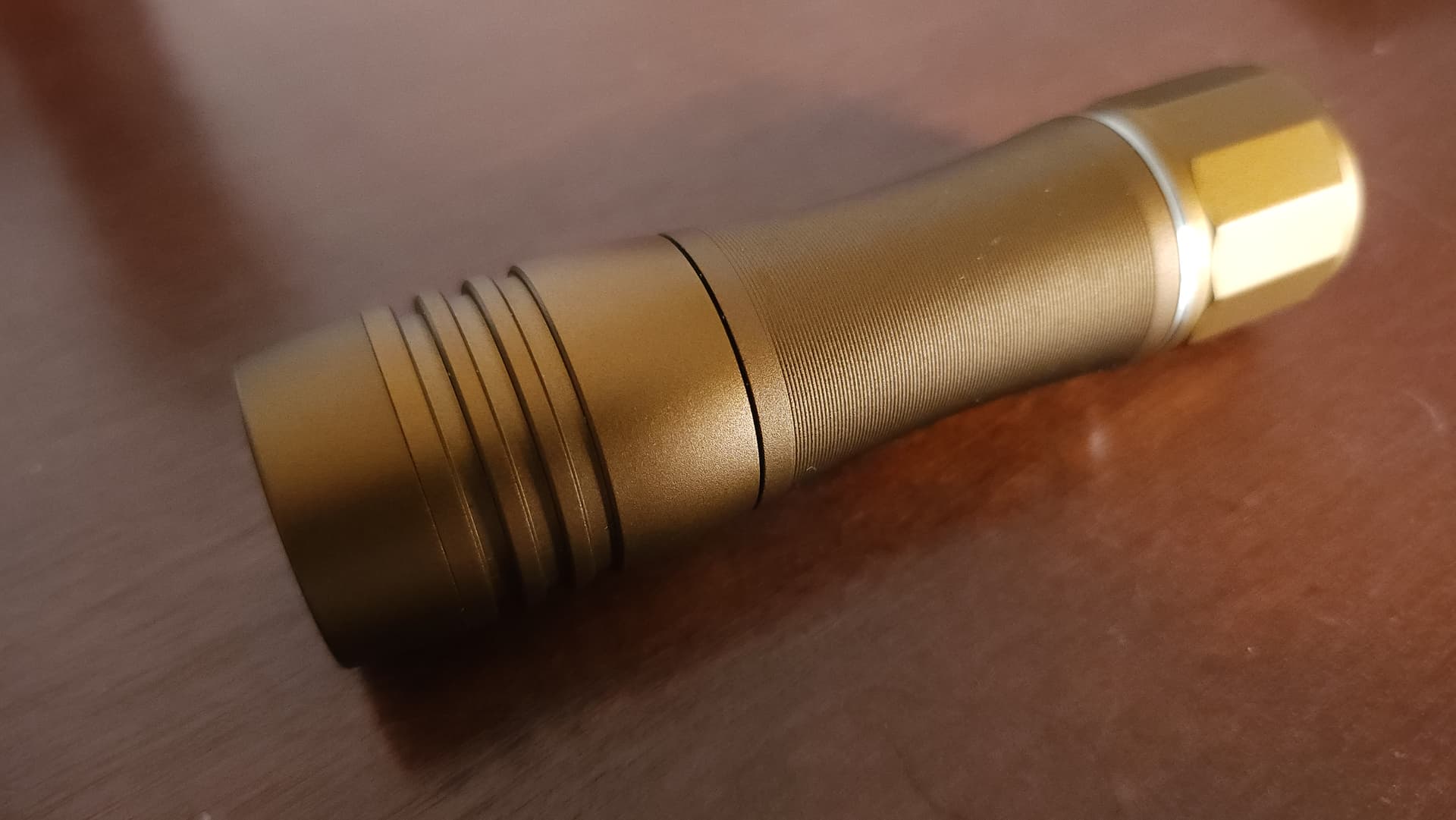

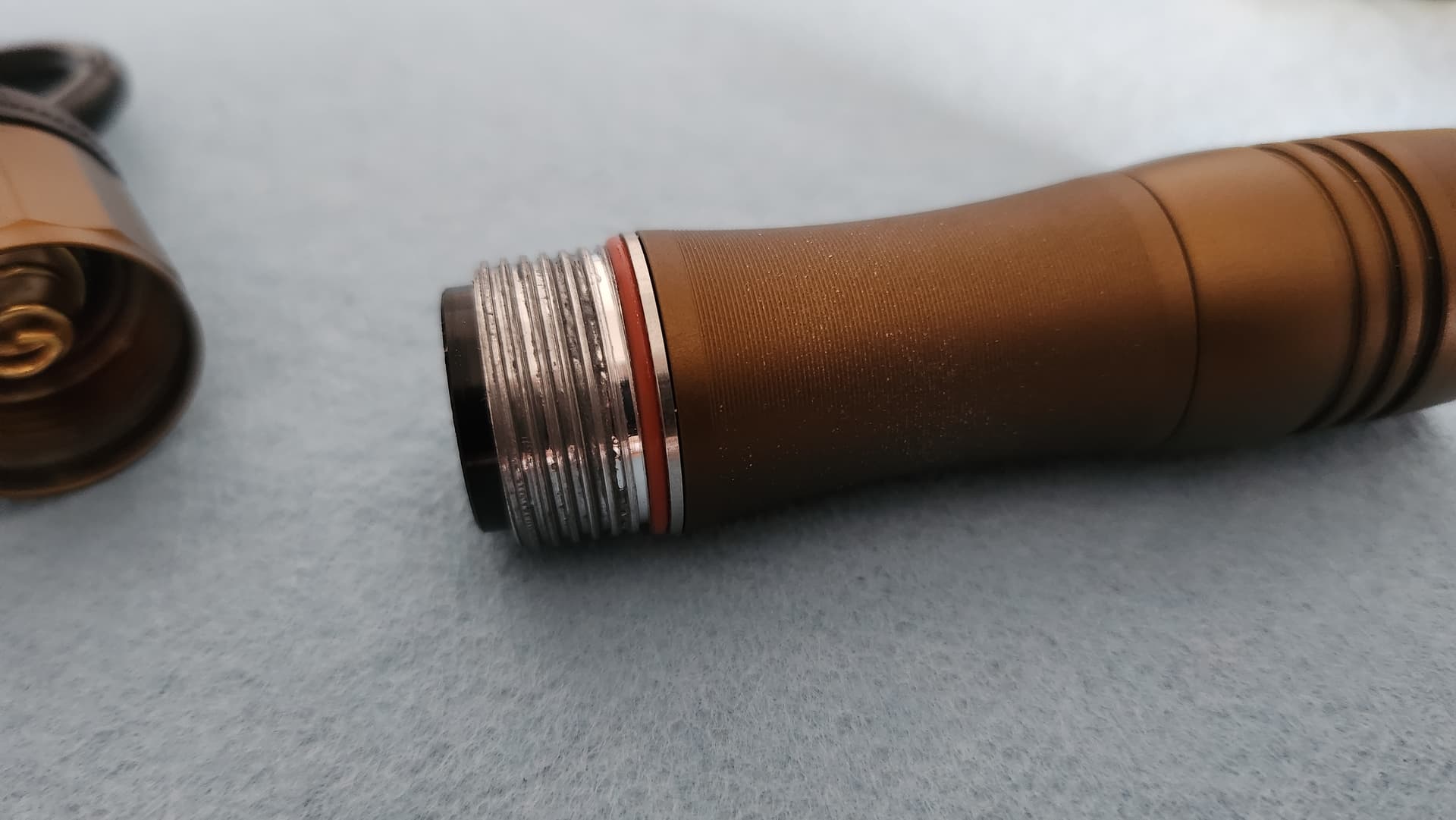

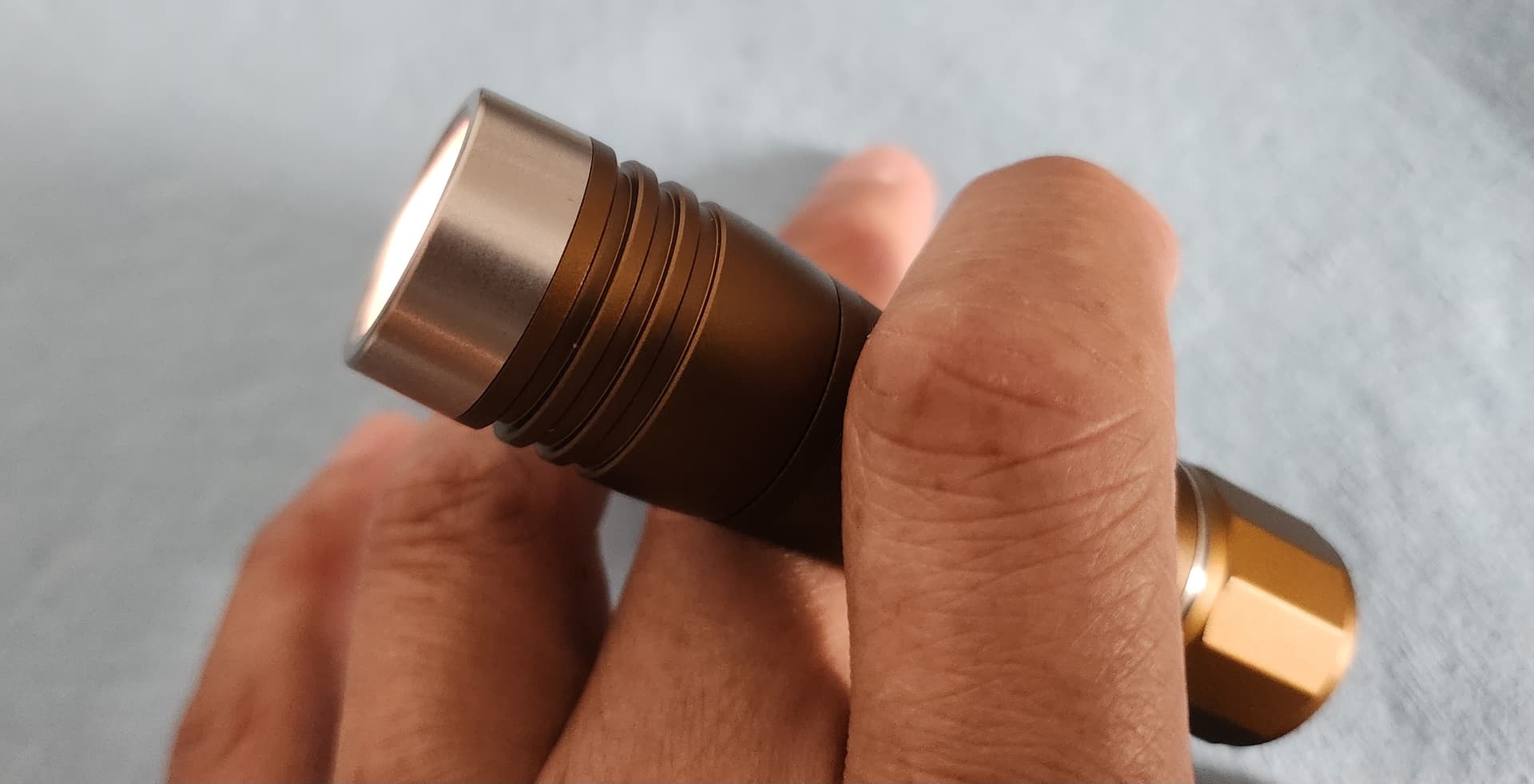

Body portion with intentional machining knurling, surprisingly comfortable for cigar hold, offers A LOT of traction. More comfortable than the WurkTS10.

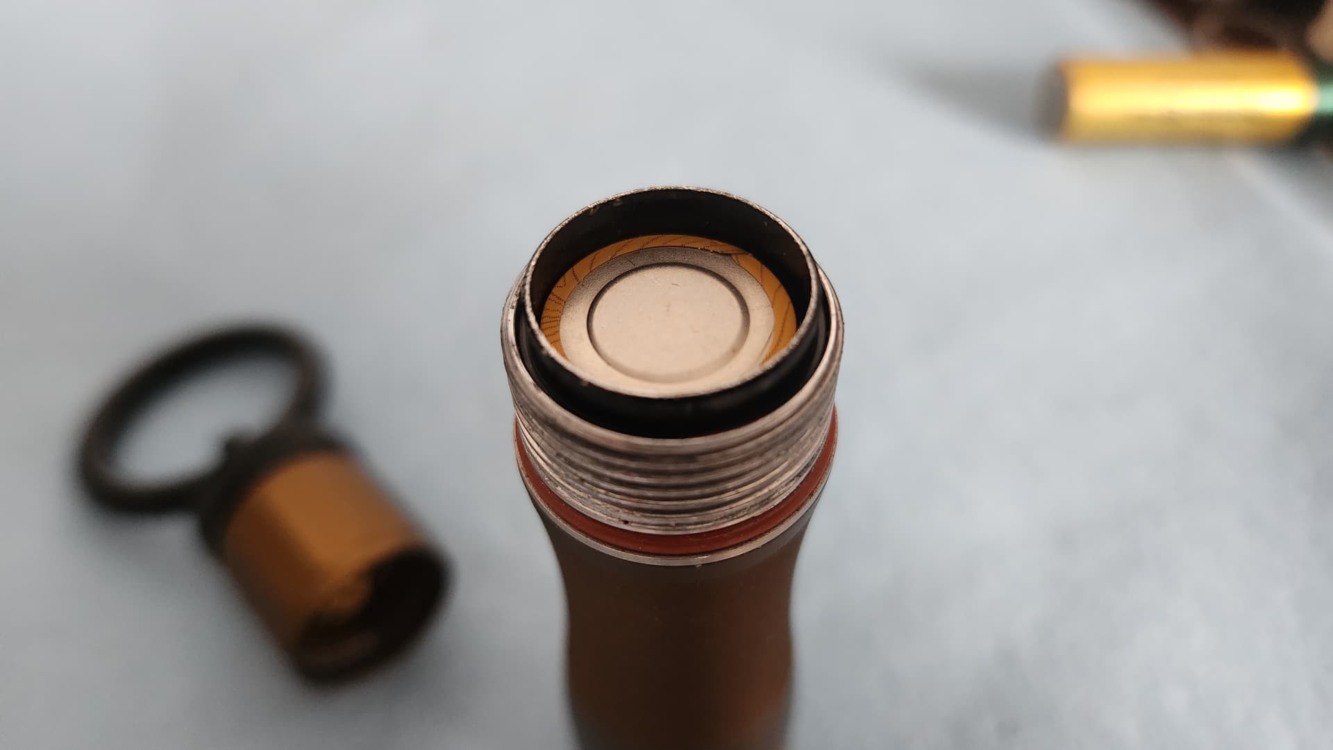

Square cut threads, typical lube. Cleaned it right off and put my own, to remove any factory metal shavings
The inner body tube, looks to be plastidipped or similar

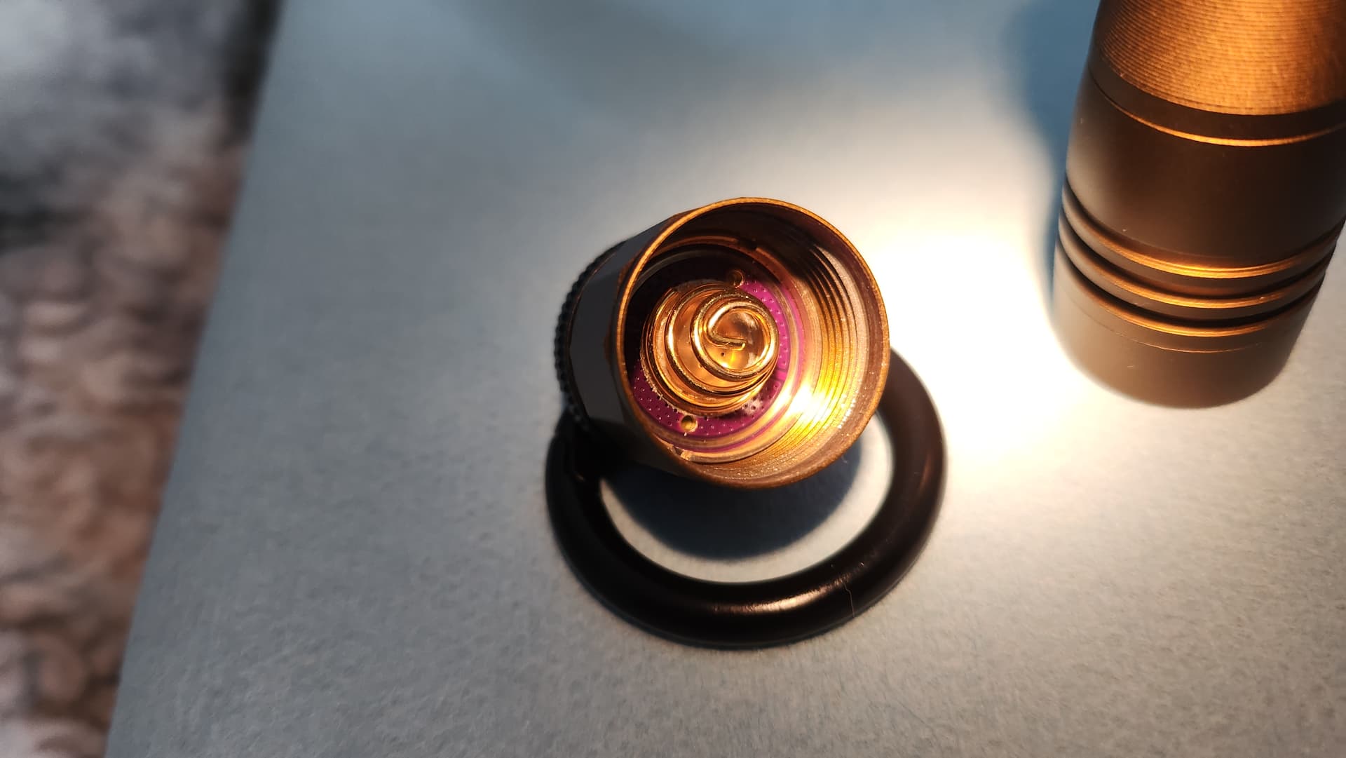

The tailcap, unfortunately the magnet orientation is opposite the polarity of the Olinks, will check later to see if it is not glued

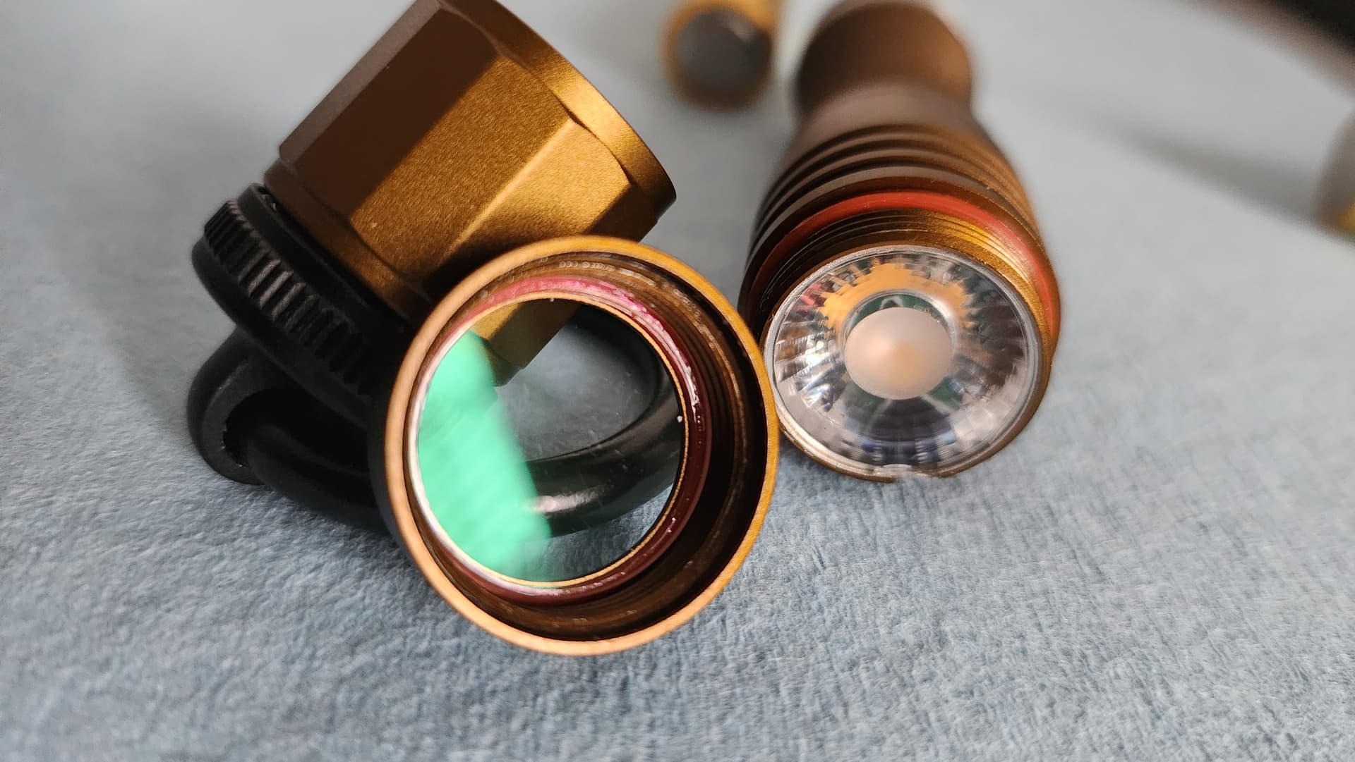

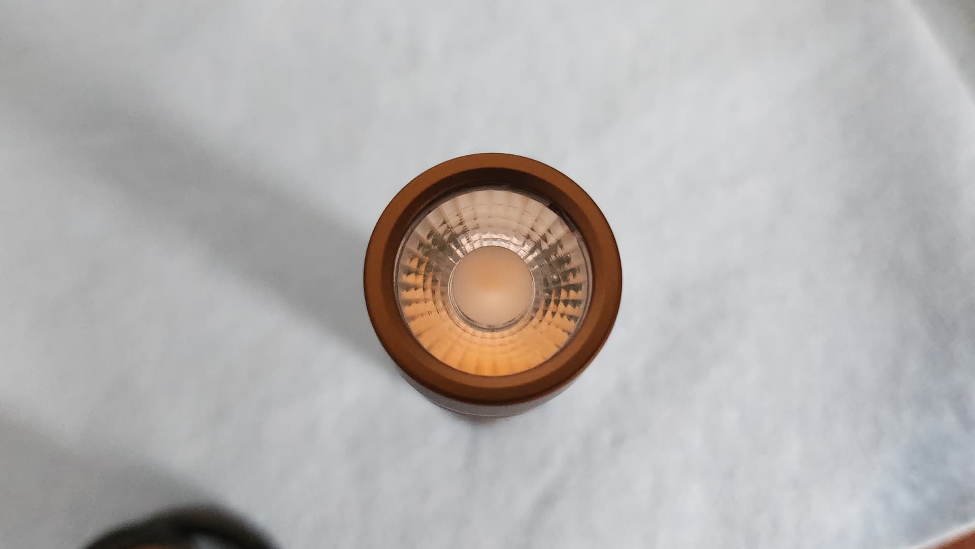

The business end
There is indeed an AR coated glass, with an oring sealing it against the bezel. The bezel does have an inner lip where the oring sits.

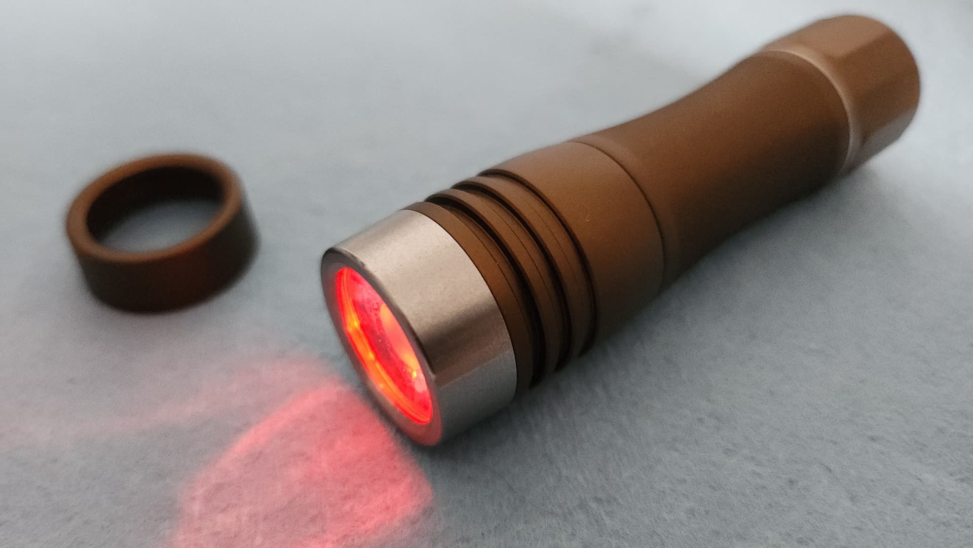

Silver bezel with the silver filler ring, would be classier if the brown weren’t so poo colored…the SS Bezel does add a noticeable heft to the overall carry weight

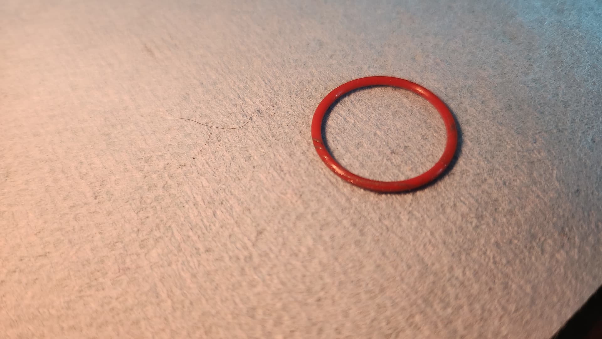

The tail oring, had some small flecks of aluminum on them, but cleaned it off and relubed.
**the tailclip does rotate rather freely without the oring installed, but the oring gives it enough compression to act as an anti-roll when fully tightened

Had a feeling you weren’t going to like it after I posted the pics of mine! I was also hoping for more of a brown…but it grew on me a bit. The loose clip is driving me a little nutty though, not sure if you got one.
I did get the clip, it’s JUST retentive enough that it doesn’t spin if used as an anti-roll on a 10ish degree surface.
**on a side note, I am GLAD I got the silver parts for high contrast, it makes the poo look less poo, lol

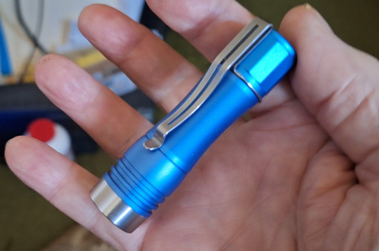

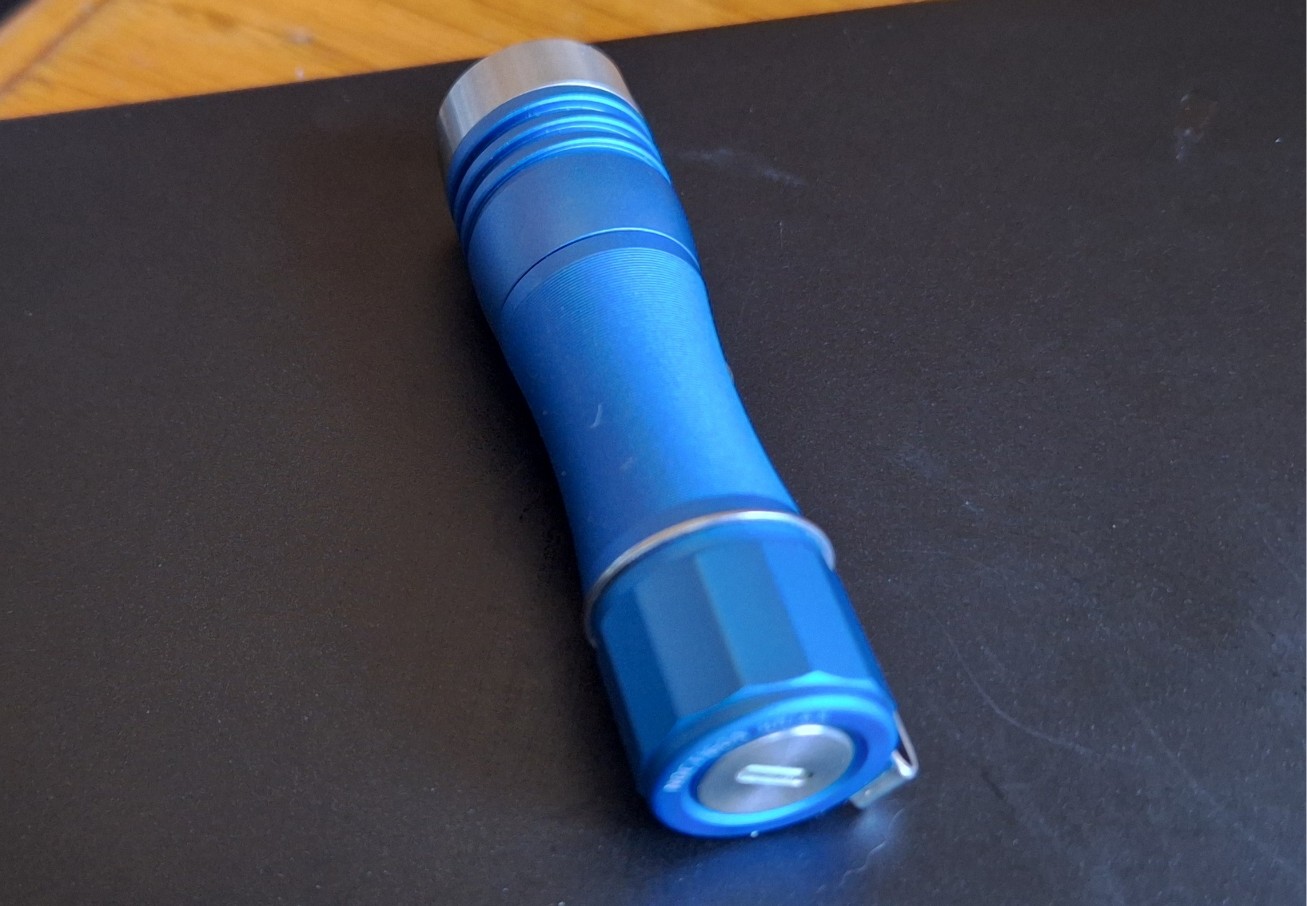

Well, I finally got my KR1AA yesterday. I ordered on 12/8/2025. So it was right at three weeks for delivery. So far I like it. I got the NTG50 5000K 95CRI version in Cyan with polished SS bezel and clip. I added the green Tritium vial to the SS (silver colored) switch.

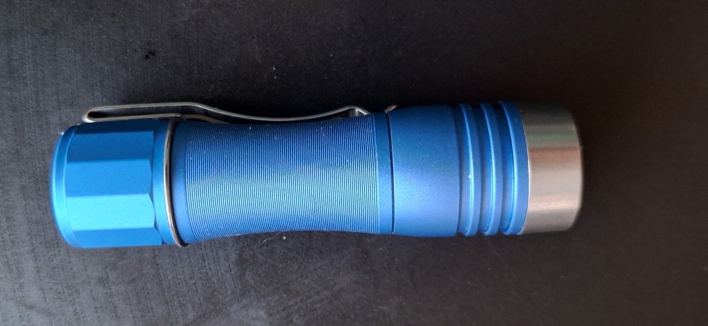

The switch has been fine. Is has lower effort that my TS10 V1 that I normally carry and is not as “clicky” . IOW a bit soft at actuation.
The light is comfortable in the hand. The micro grooves give it plenty of grip without being a cheese grater like my D3AA. I can see already that those grooves will gather dirt. This can be seen in the pic above and below.

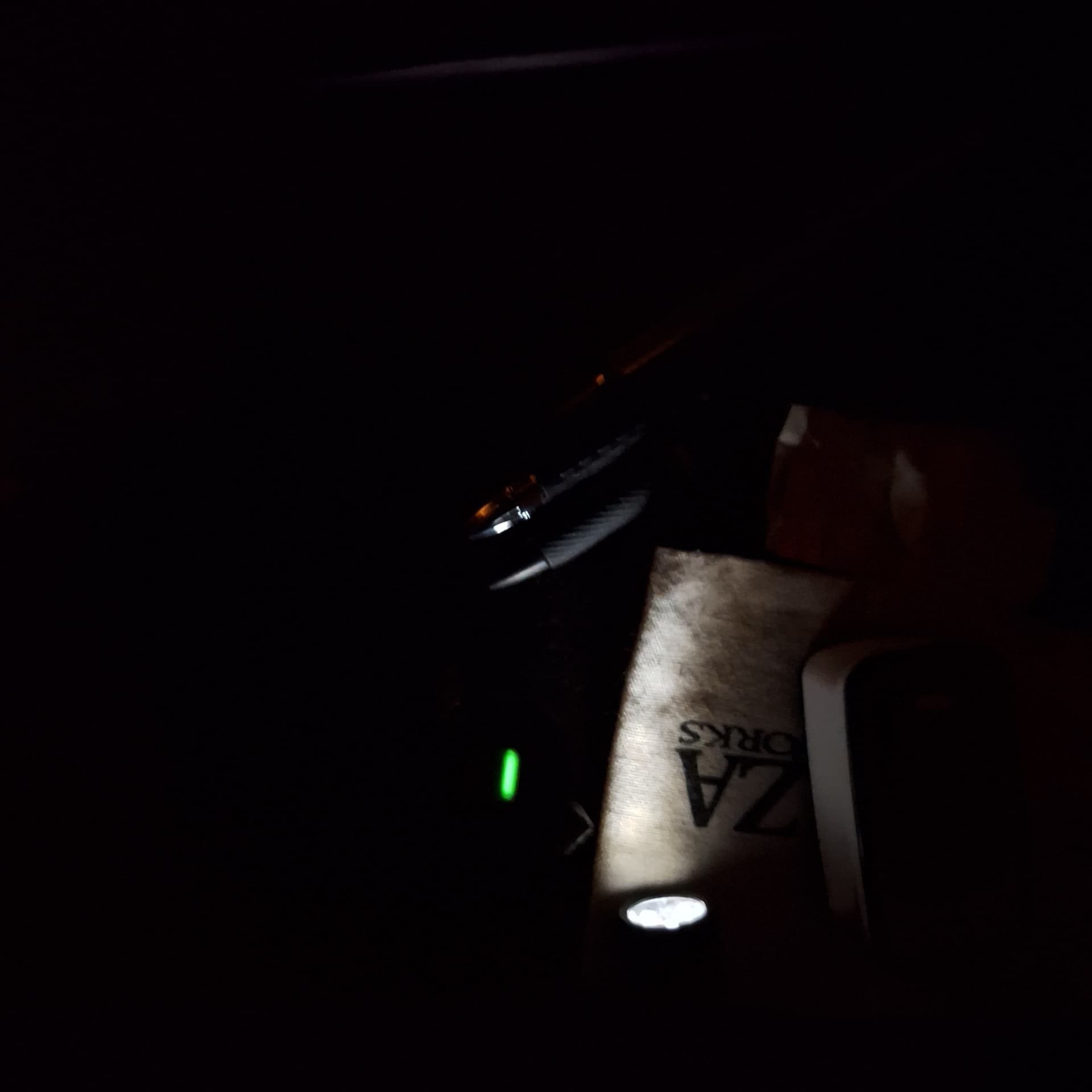

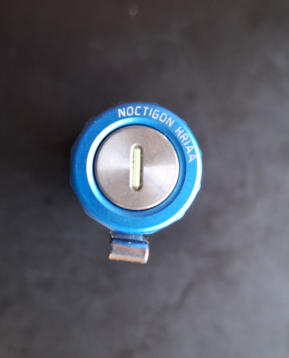

The tritium vial is not very bright. In pitch dark it is only visible from a few feet away. I tried to take a phot, but I couldn’t get the camera to show it anywhere close to what my eye sees.
In this pic, I would have expected to be able to see some glow from it, but nothing there.

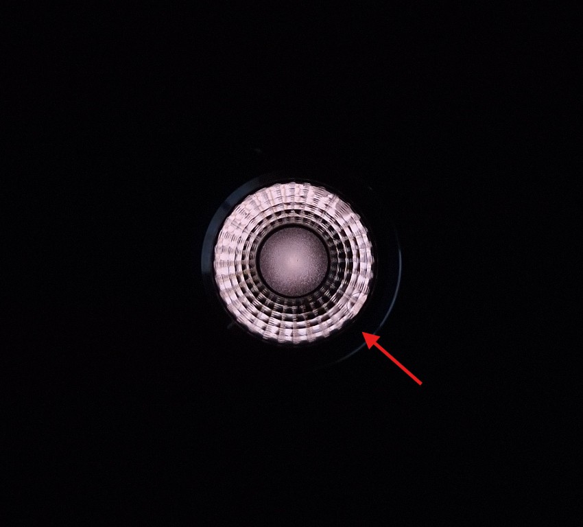

As to the chip in the optic caused by breaking it from the stem that holds sever together. It is pretty much a non-issue for me. It is not visible in the beam patter and Even when I am looking for it it is hard to see.

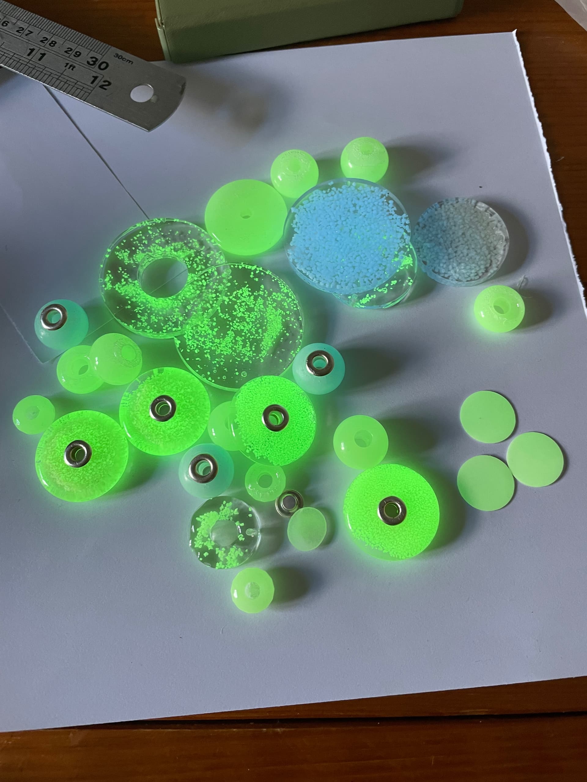

GITD powder and UV resin can be very acceptably put into tailcap slots, I’ve done this to my reylight, the tail of the light actually catches ambient light nicely, when I come inside on a sunny day the brightly glowing tail always makes me chuckle!

I have had watches that used tritium. I also have gunsights that use it. I don’t think that the one on the Ke1AA is as bright as either. I look forward to readin what others that may have more experience with a wider range of tubes have to say. I took a pic last night, but the camera makes it look much brighter than using the old eyeballs.
As mentioned, In a fully dark room, with the thing sitting on my desk I have a hard time seeing it from maybe 5-6 feet away. BTW the flashlight in the pic was a a TS10 on 5/150

I think when I get round to buying a new tailcap for my KR1AA this is the way I’ll go. The UV resin is so much easier to work with than mixing epoxy, and it shouldn’t degrade and yellow over time. The beads work really well with high grade powder, the sandy stuff is even better.
Is this different than most GITD options?
I find they start too bright (depending surface area) and are invisible 8 hours later.
8 hours? Yes, very probably invisible after that long.
