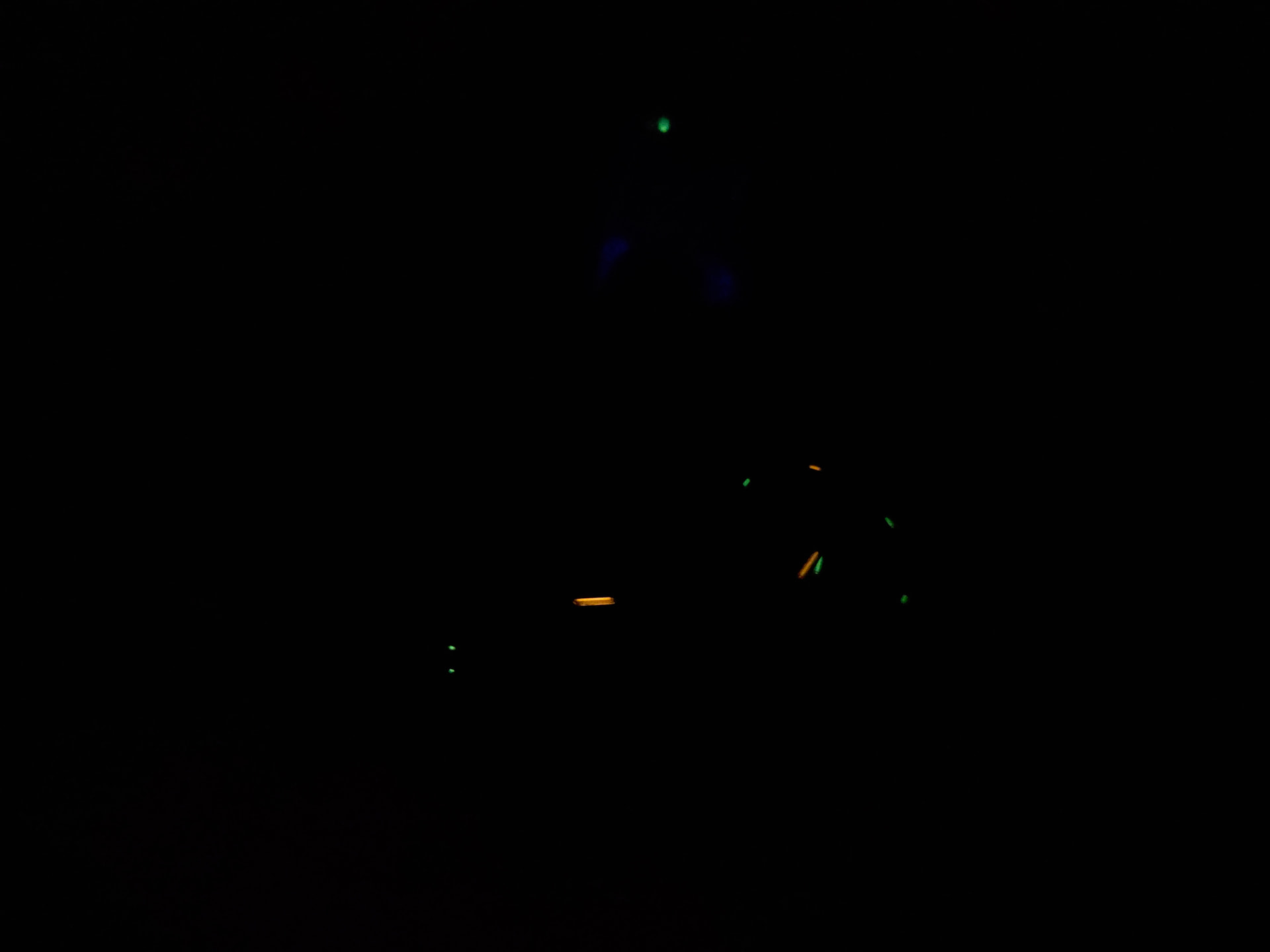

Did your orange trit ever come in? How’s it look?
The Vapcell 14500 1500mah cells actually has discharge capacities of around 1500mah measured on my Xtar charger. But if you run it at higher amps, then Im sure you won’t get 1500mah but I usually use my 14500 flashlights on low modes.
I did! I personally love it. I leave the aux leds off, even on low they’re too bright for me, so the tritium is a wonderful option that im glad to have.
Some people have complained about the brightness, but it is what i would expect from tritium. Low compared to the aux, but perfectly visible in the dark or near dark. Here’s a picture I took when i got it in. It’s a little hard to tell what’s going on, but its fresh night sights on a pistol on the left, a luminox watch on the right, and the kr1aa in the middle.
7 Thanks
Nice! That definitely looks much brighter than my pink ones, lol…I’d wager the pinks I got are less bright than the Luminox…Thanks for sharing!
I know we discussed the brightness of the green trit I got in mine. Initially I was disappointed. But it does the job. With dark adapted eyes I can easily locate the light sitting on my dresser from maybe 10 feet away.
Yeah, I remember your problems with the pink one now. I really hate that yours ended up being so dim.
mine doesn’t, lol…probably just a bad choice in color on my part. Pink might be one of the dimmest colors available
