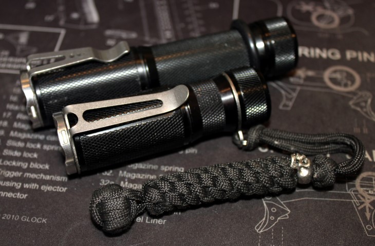

On to the moddin'...
There is no way these drivers will come out in one piece, had quite a job breaking it out as it is fully potted in hard black resin.
Aluminium heatsink filed into shape to fit the fit the internal contour of the flashlight head and make contact with pill insert, potted in place.
22mm brass tube cut & filed down to fit inside the aluminium pill with brass mounting ring inside for 17mm driver, all soldered to contact board.
2mm thick aluminium disc installed in pill. Copper contact soldered to driver board.
Another 22mm brass tube section cut for optic/ MCPCB surround to support O-ring, fitted in place.
Copper tape around pill for snug fit.
Cut out slot for new clicky switch in switch board, soldered in place.
Brass ring soldered onto board, spring attached, wire bypassed, potted.
Felt lined battery tube. Reassembled.
NovaTac 120T - Triple Nichia 219C 5000K - H17Fx - 18350 - Rv Clicky Sw - 2300lm.
Triple Nichia 219C D320 5000K on 20mm MTN DTP MCPCB
10507 Carclo optic
22mm x 2mm ARC glass
Cyan GITD glow disc
Dr Jones H17Fx driver
Reverse clicky tail switch
Lockout-able
18350 cell compatible
Length – 86mm
Width – 26mm
Weight – 96g (with 18350 cell)
I have it set up like this for the moment:
Mode 1 - M/L - Level 2 - 0.1% - 3mA
Mode 2 - 35lm - Level 12 - 3.0% - 95mA
Mode 3 - 260lm - Level 18 - 25% - 760mA
Mode 4 - 1010lm - Level 22 - 100% (8x7135) - 3040mA
Double Tap Mode - 2300lm - (Level 24)
