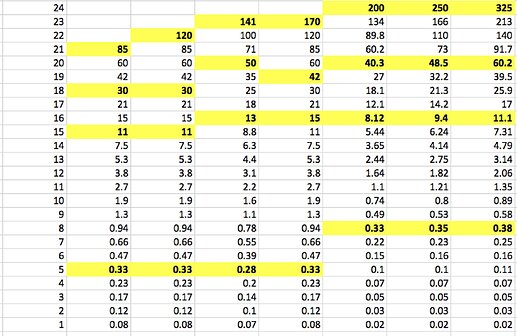

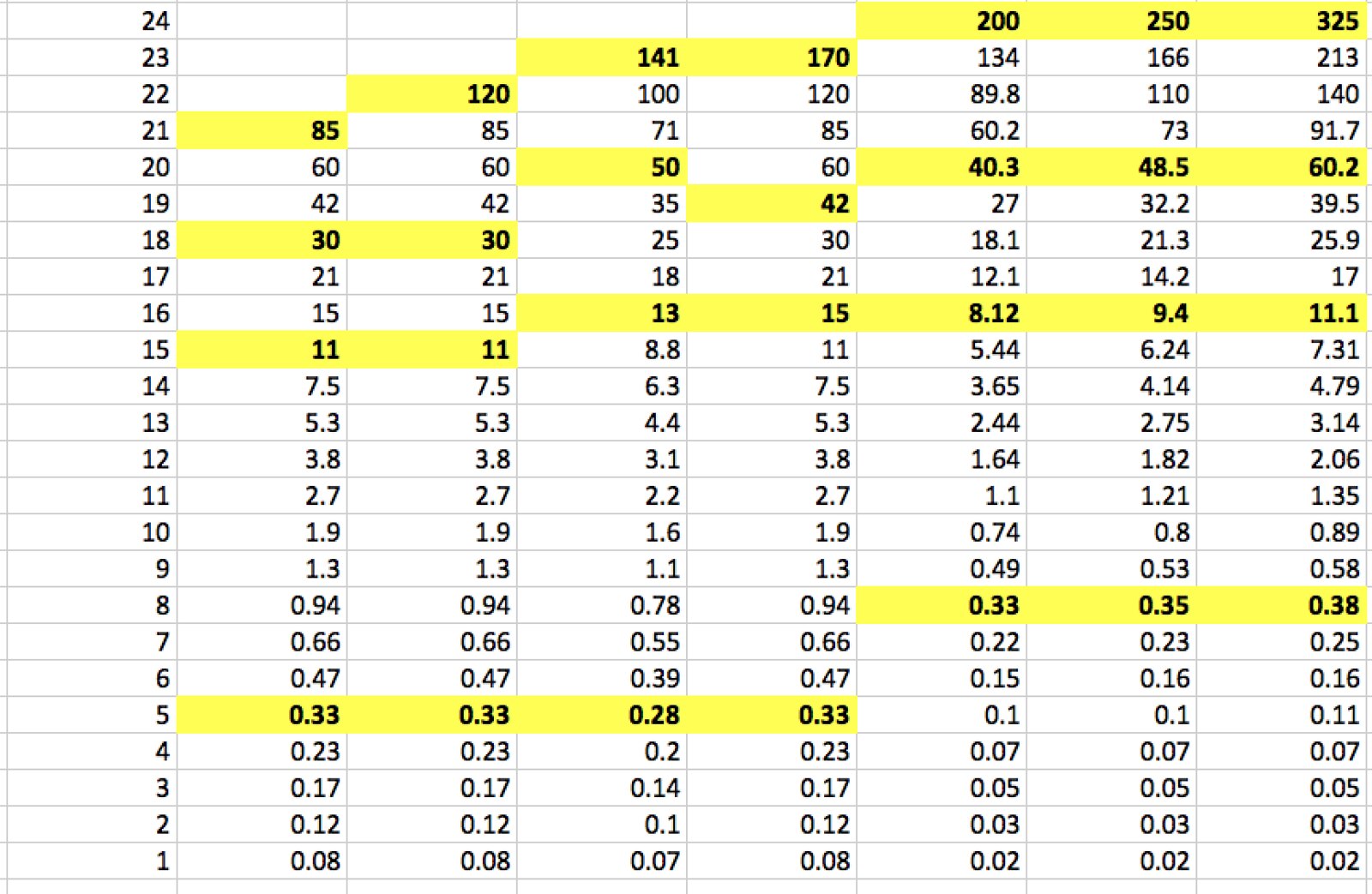

Here are the theoretical mode spacings for various HDS models (the 120 column applies to Novatac). The Yellow values are the factory defaults.
Although in my reality Novatacs do not really have 120 lumen outputs, not even the ones from Tucson.. they actually had outputs between 70 to 90 lumens (on my meter, calibrated to a 200 lumen HDS)..
the reason for the discrepancy, is that Hogo mentioned he used a special calibration factor to account for the cool white LEDs color temperature. iow, 80 lumens adjusted with his special factor, was 120 lumens on his calibration tool.

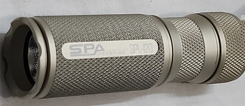

here is an example of a light that came w locked 120T programming.. I did the 250 clic unlock and reprogrammed it more like a 120P:
That is a transitional light, branded as an SPL-120, but it uses some of the surplus parts from the OG Tucson lights.. notably the Blacked out Stainless bezel..
Later SPL-120 produced in China come w Aluminum bezels, anodized to match the color of the lights.. such as this example:
