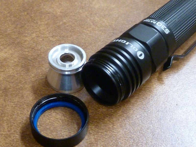

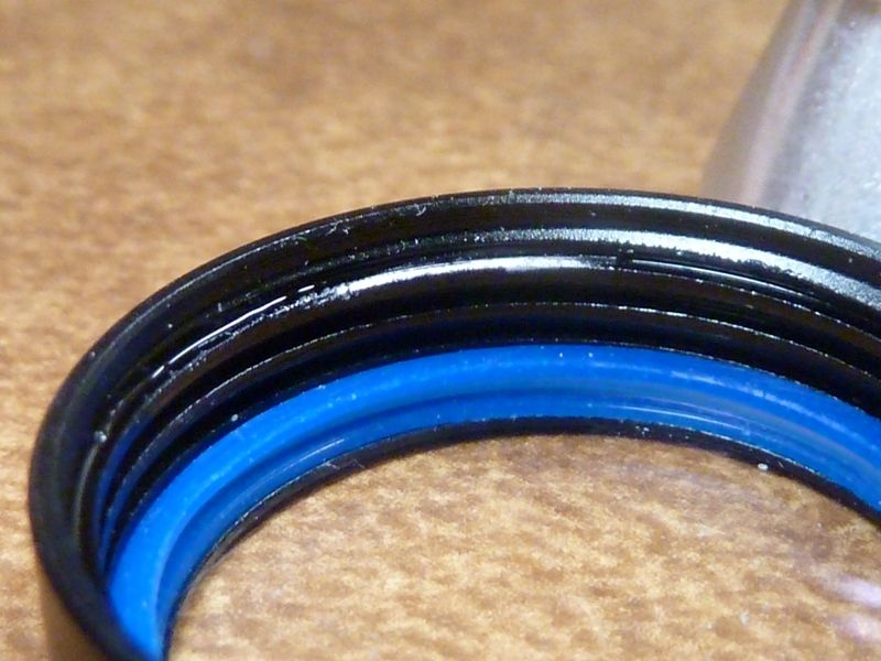

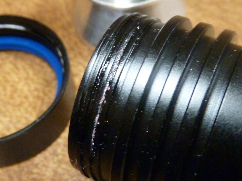

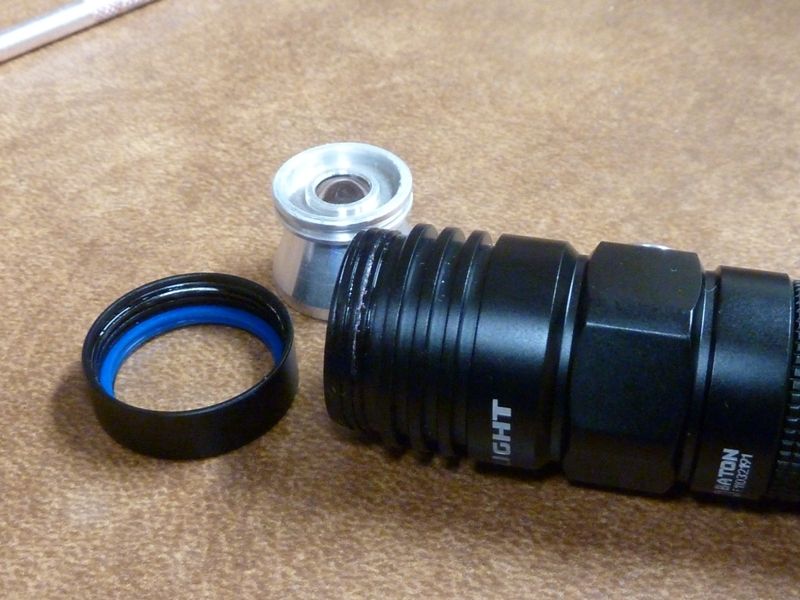

Update: tried more, finally got movement - was pretty tight - found out why. Looks like a little red LockTite. Here's the pics:

Ok - did more reviewing on this light, and I can only conclude (best guessing that is...):
  • the screw in the pill top is only there to keep the MCPCB from spinning (the pill top is threaded itself), appears to hold nothing
  • the pill top appears to be part of the body, uni-body design
  • only way to get access to the driver is that there must be another threaded connection, and I kind of/sort of see where it is - right where the tube knurling ends towards the head. Based on measurements from the inside, it looks like the threaded tube tightens up against the alum retaining ring over the driver, around the driver spring
  • I tried by hand/gloves to unlock the threaded connection, but no luck so far. Great timing - tomorrow before the turkey, my son-n-law can compete against my other daughter's boyfriend for the break-the-LockTite / win the "last part of the turkey over the fence" contest
  • if no winner, I'll bring it into work. A guy I work with is like a body builder - gym rat, huge arms. He'll have the muscle for it for sure...

That was Red Loctite on the bezel - Red is the most permanent of all Loctites (http://us.henkel-adhesives-blog.com/post/All-About-Threadlockers/The-Difference-Between-Red-Blue-Green-and-Purple-Threadlockers/).
If they are using Red on the tube thread connection, it's gonna be worse because of more threads, and very dependent on the amount used. Spec sheet here: http://www.loctiteproducts.com/tds/T_LKR_RED_tds.pdf.
It says heating to 482F and separate parts when hot. Tried a butane torch, no luck. Read here on BLF a while back about hot-cold-hot (torch-freezer-torch) can break it, but not finding anything online. Still working on it.
