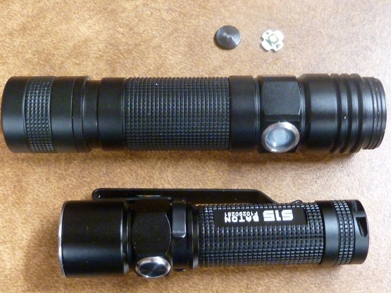

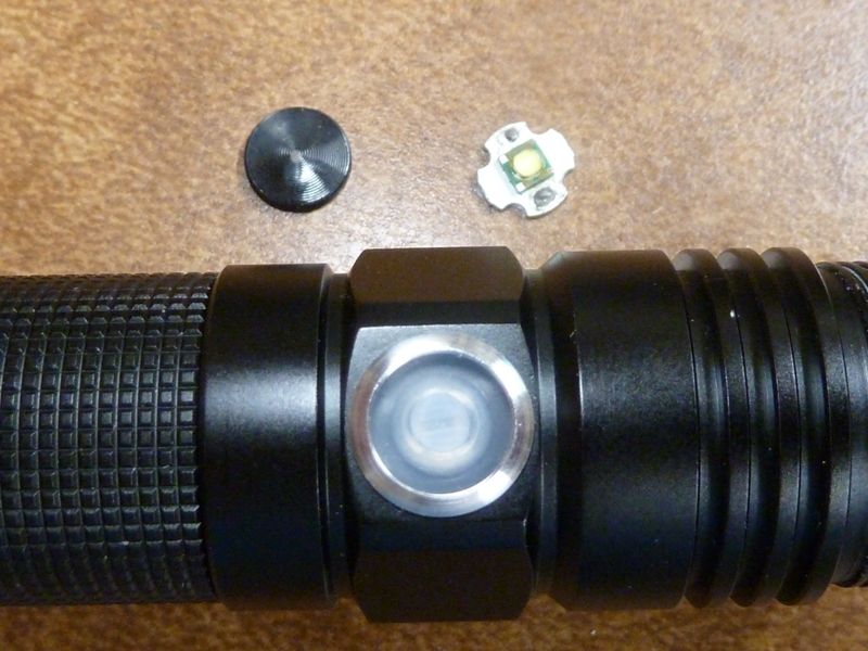

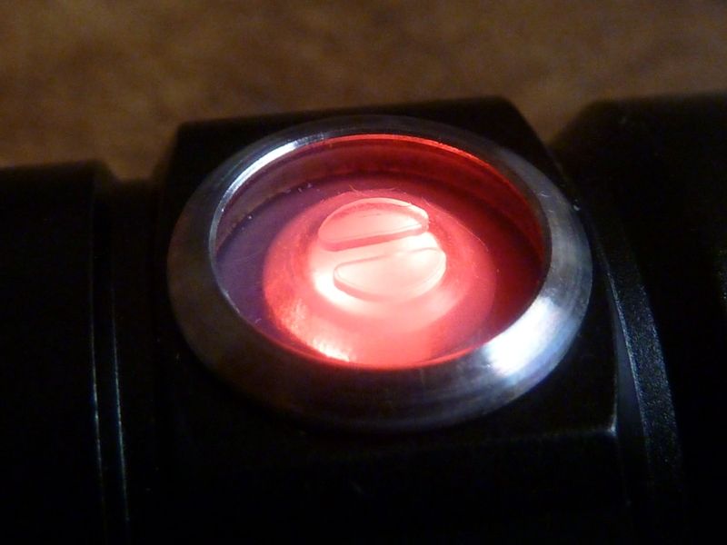

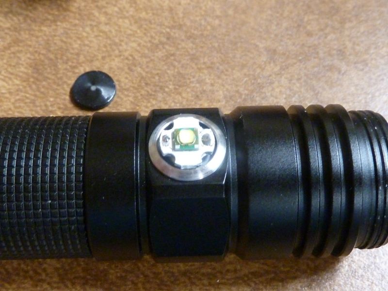

Look'n at the switch, noticed the black plastic cover was a little loose, so I was able to remove it. Underneath, a clear rubber material was there, but the switch works, light operates! Now just need something to replace the black plastic - it must have deformed somehow. The old LED/star I took out of a AAA light fits perfectly in there:

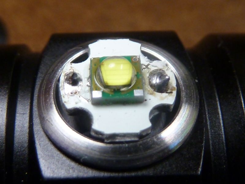

Does someone reflowed an XML2 on the stock MCPCB ?
I did, a warmer 80CRI one, worked fine.
What’s under the plate ? Just thermal grease or is it glue ?
No screw ?

I tried to take a look at the driver last night, but that involves desoldering the led-wires again that I was quite proud of having done that so neat. So I hope someone else in the process of modding the S30 can do that.
Btw, the driver pulled out a bit and pushed in place again did cause the switch not clicking very nice anymore, still works but the good feel is gone. So I regret having tried this .

Mine had thermal grease. Again as I said before and clearly in the picture I posted above, the screw does not secure down the MCPCB - it simply keeps the MCPCB from spinning, which can happen sometimes when tightening down a bezel, and result in cutting the LED wires.
