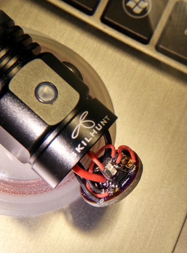

to take advantage of the window (battery indicator), my new driver is very ugly.

thanks for the detailed pictures, I always enjoy seeing the innards.
Your driver doesn’t look ugly to me, I would rather say it looks nice, can’t do any better with 3extra cables and two additional LEDs squeezed in there.
It looks nice enough, syra. Making sure that the cables aren’t all tangled up is the best you can do; there’s no way of rigging a more advanced driver and not have it look like a plate of spaghetti.

Syracuse - that is excellent work btw. I think the wiring looks darn good. So you got a red and green there, with resistors I assume? How's this wired up? Do you have PWM's on one of the LED's, and one that is just ON/OFF?
I wired up everything just like Helio driver and use TK’s ramping_UI_table.
