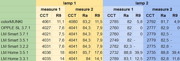

One of the OppleMod chat members (Victor) compared X-Rite ColorMunki Photo measurements with different versions of the Opple apps.
Hi-Res mode was used for ColorMunki, so it measured 380-730nm spectrum with 3.3nm step (n = 106).
Ra is absent for Measure 1 since he started to record it only from Lamp 1 - Measure 2.
LM Smart 3.2.2 should actually say 3.3.2.
This chart proves that there’s no difference between Smart Lighting 3.3.2, 3.5.1 and 3.7.1 (modded or not).
And also you can see that Home app 3.5.1 produces worse results than Home 3.3.1.
If we remember complaints about how Home 3.5.1 behaves with low-CRI lights (see here and here) and the fact that Smart app can’t show negative R9 values (see here and here), it becomes clear that OPPLE Home 3.3.1 is indeed the recommended app for now. So I’ll focus on it for future mods and abandon Smart Lighting apps completely.
