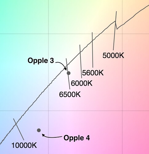

good point, Flashlight LEDs are not always full spectrum, and are often very low in R9, which the Opple 4 cannot measure (yet)
Here is an example of a Fenix E05 on LM4 and LM3:
you can see there is a very big difference in the results

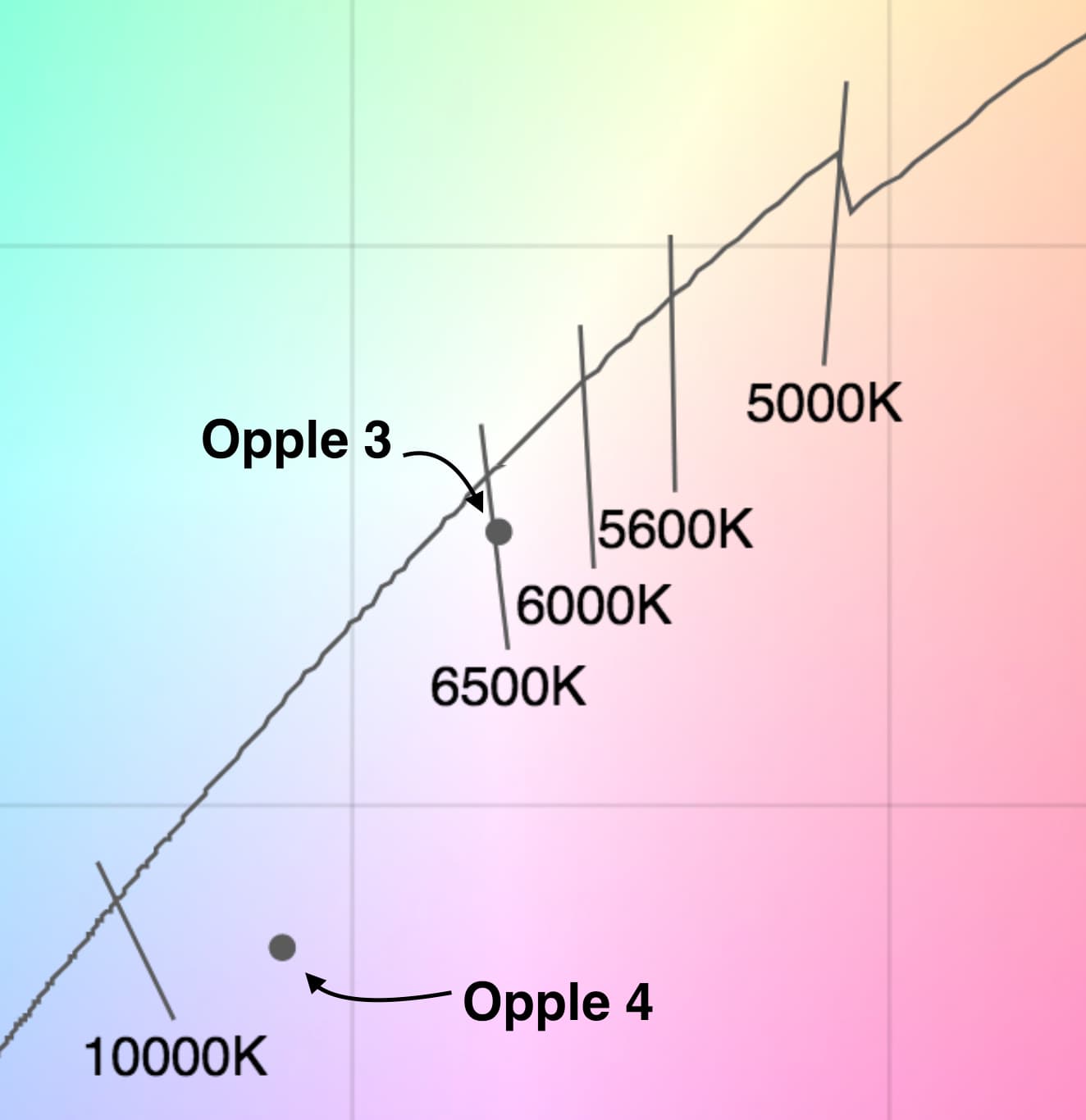

the Opple 4 does work better with the High CRI LEDs.:
in this next example, the difference in X and Y coordinates is much smaller:
