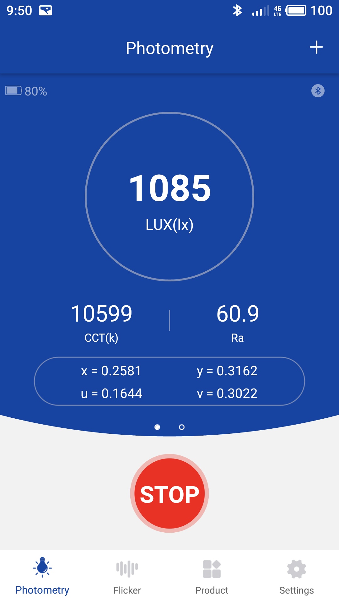

In version 4 something has changed when measuring IR light? Version 3 showed miracles when measuring 850nm spotlights.
The LM3 is not made for measuring IR. What happens might be the blue sensor picking up more of the harmonic 425nm than the deep red sensor gets from the 850nm. Just a theory, but still, you’re measuring out of specs and therefore get nonsensical results.
You are completely right, LM is not for IR measurements. And you can control extraneous IR radiation, when measuring any light source? Or maybe the light source also gives IR radiation. What will you get for the result then?
Interesting question. My guess would be that IR picked up by the sensors will be significantly less intense than white light - except you shine an IR spot onto the LM. Test it with an IR cut filter.
I noticed this effect when I was working on IR projectors.
Even simple luxmeters have IR filters and do not react to IR radiation.
The IR filter should be between the diffuser and the sensor and maybe it will distort the readings of the device. I don’t have an IR filter of this size and known characteristics (((
You could try measuring in darkness in the presence of a heat radiator. In a normal dark room, I get 0 lx. To have a significant impact, the reading should increase with a radiator, correct?
Edit: I did. Aluminum at 50 °C right in front of the diffusor - still 0 lx.
A heated radiator gives far IR, and 850nm is near IR, but it is still invisible to the human eye, but is detected by the LM.
Near IR is in sunlight, light from xenon lamp and similar strongly heated light sources.
Ok. Do you now the power density of your spot on the diffuser?
No. I now know that this device is !@#$ up in some situations ))) And everybody needs to know that. I was really curious what changed in version 4 about this. I wrote about this problem to the manufacturer.
