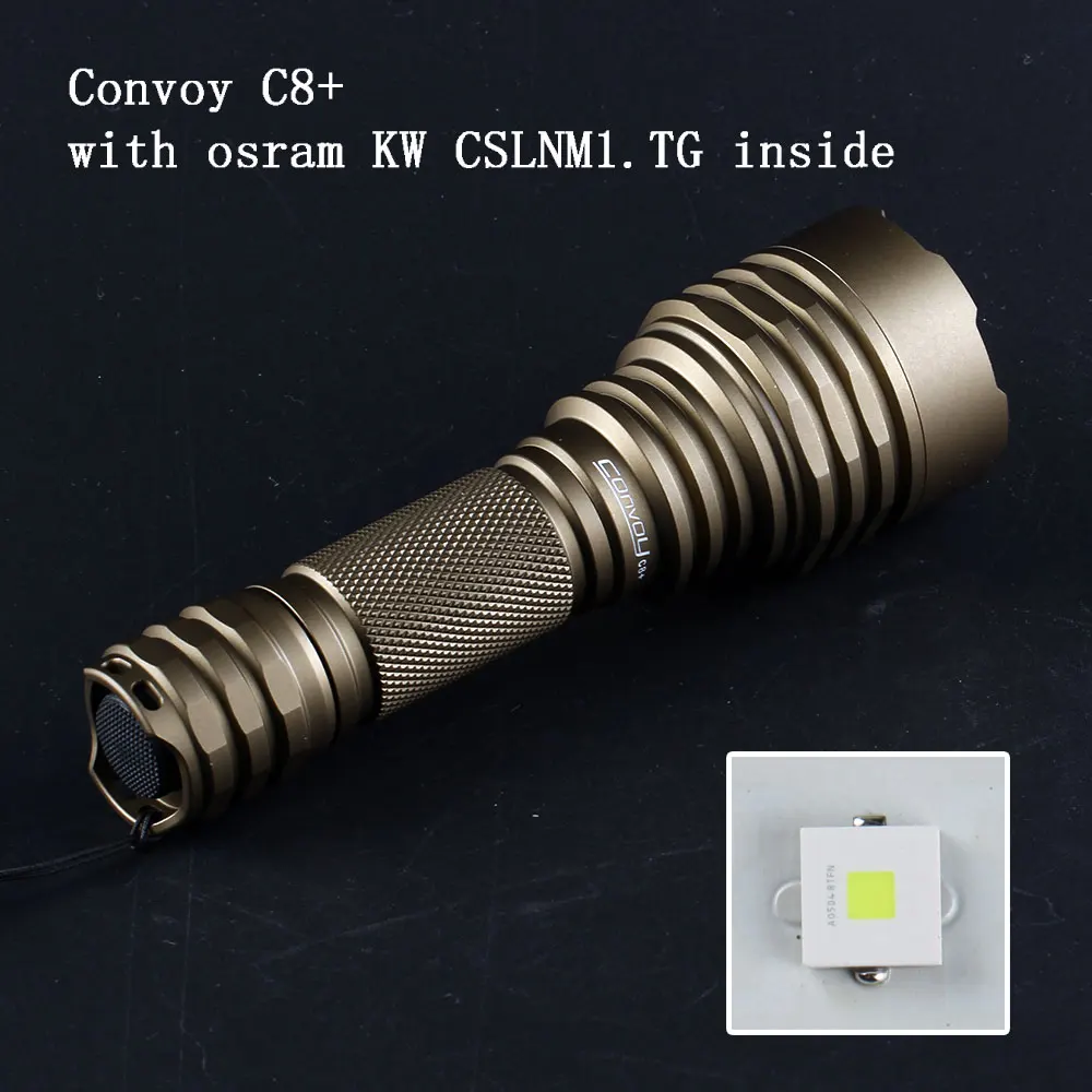

Simon (convoy store) has listed this new beauty C8+ with osram KW CSLNM1.TG 6500K https://www.aliexpress.com/item/1005001400455356.html
Max range: 748 meters (140kcd)
I got 915m range at 4.2A, 700 lumens, and Convoy are using the 5A driver so it’ll do better.
I wonder why the rating is so low
Everyone should mention candela rating and not meters… ANSI standard? Well it kinda sucks… Mine 280 kcd light for me has usable 500-600 meters beam distance(depends on the night)… This is individual stuff. Cause there are areas with ultra dark nights where ansi measurements can actually pass. But it mostly won’t pass. So I don’t take only the beam distance as a relevant data… Candela rating tells much more about light so if candela rating is true and “right” by my personal experience I can estimate throw by my night conditions…, and if 140 kcd is true that is around 200-250m of usable light in mine area…
They convert perfectly back and forth. Neither measurement tells you any more or less than the other. Just take 2/3 or 1/2 the FL1 throw based on how much intensity you want at a given range and there’s your real-world throw.
In fact candela ratings can be deceiving since it requires exponentially more to increase throw, whereas doubling FL1 throw from 100m to 200m will have the visual and practical difference you would expect.
