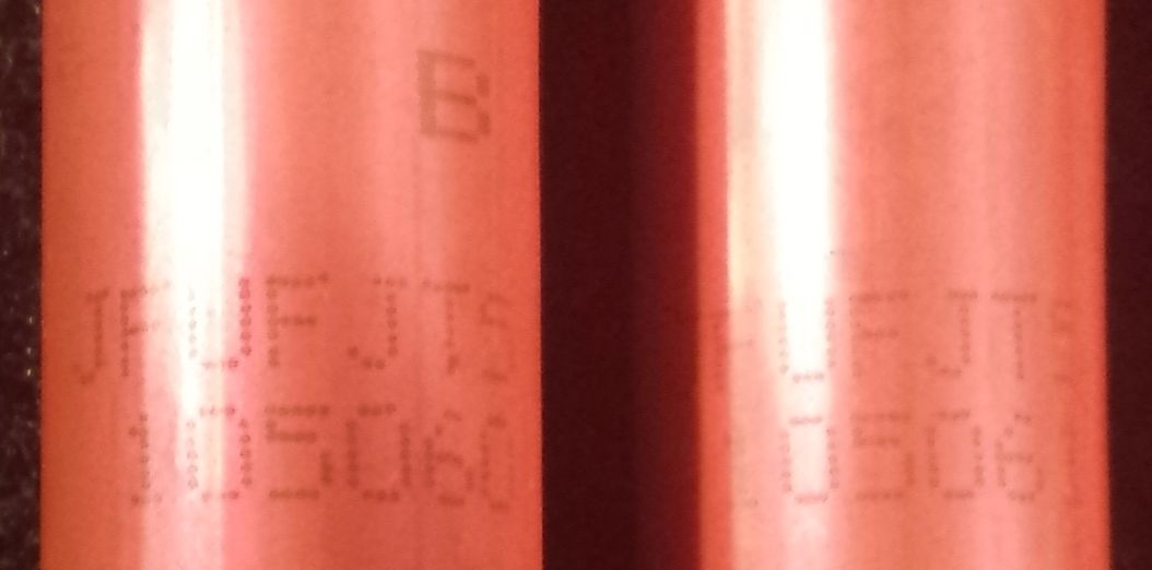

i unwrapped the smaler pack
found 6 cells
and some electronics…
here they are:
labeled with: “JFUFJT5” and “JAPAN J129A”
false colors used to see the letters better
QUESTION 2
i cant find any information what cells that are….

You already know what the purple ones are. The maroon looking ones are Sanyo, 1800mah both of these are made in Japan.
