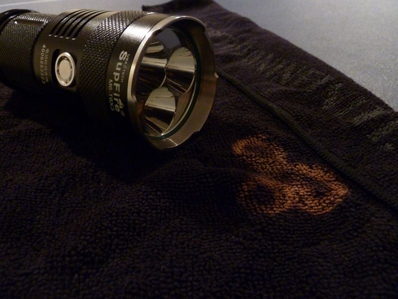

These high powered SRK's will get super hot, with thermal and timed stepdown disabled. Here's what an M6 did to a towel when left on for up to 40 minutes wrapped in the towel:
The marks are permanent. This one did close to 5,000 lumens on 3 LED's, but long before the lockout and stepdown features were implemented. The metal switch was so hot, I had to poke at it to turn the light off. Took quite some time to cool off to be able to touch it. There was no damage I could determine - not to the cells, the LED's, the driver - nothing. I believe our copper Direct Thermal Path LED boards, quality thermal grease, combined with heavy gauge wiring and bypasses on springs all helps in preventing damage.

Did the Supfire burned pigments in the towel, showing white cotton burned golden brown?
Dunno - it is a solid black towel, the best I could tell. The burn marks seem to go down the fibers, but not the base material. I still have and use the towel.
