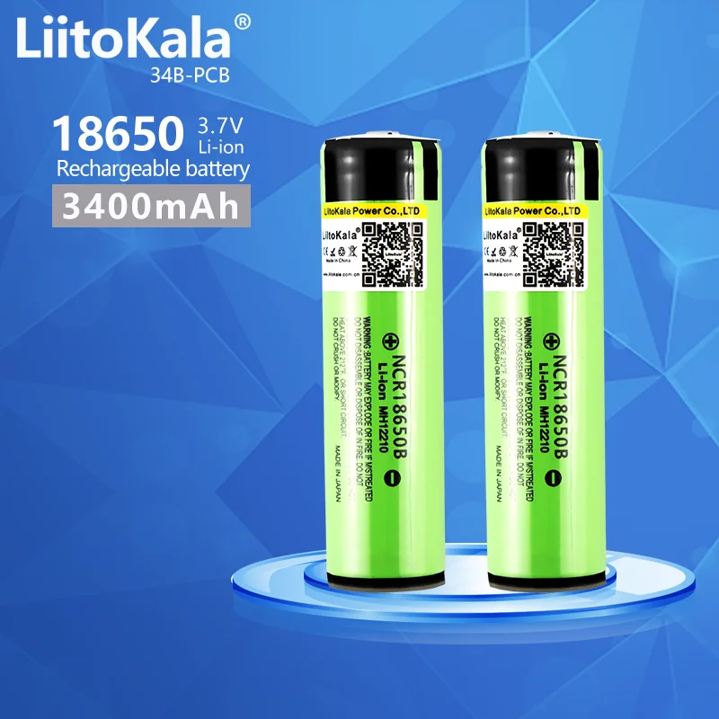

The protected NCR18650Bs are from here:
The description only says: “The PCB use 2*MOS protection board, maximum power voltage is 4.2V, the minimum voltage of 2.5V”
I have tested this (freshly charged) protected NCR18650B on Astrolux S1 (ie. BLF A6) and S2 (ie. BLF X6v2), they do not trip even when set to Turbo mode.
However, I just got the Astrolux S41S quad-Nichia, and when freshly charged, the said battery trips (turns on and immediately turn off) on Turbo and on High-2 modes.
Any idea what are the parameters/characteristics of the “2*MOS protection board”?
My INR18650-30Qs are the unmodded flat-tops. Maybe I’ll use the unprotected LG HG2s then…

I don’t recognize those particular cells. Just saying “2 MOS protection board” isn’t enough information. I know the higher rated boards (8A to 12A) tend to use 3 mosfets, but without specific details we can’t say for sure what the max current is.
It says output is 600mA, but that might be a typo. If it said 6,000mA then that would be 6 amps and is about the rating I would expect.
From some quick searching I see that the S1 light can draw 4.5A on unprotected cells and maybe 3.5 using protected.
The S41 can draw 9 amps with an unprotected cell. I can’t find any data about the amp draw on High 2. I wish I could so we would get a closer idea of this batteries limit. I would guess that High 2 is maybe 5 to 6 amps.
So we know it can deliver at least 3.5 amps, but not 6 amps.
The Q8 on 4 cells can draw 16 amps with unprotected cells. So maybe 13A to 14A using protected cells. That is 3.5A per cell. You might be okay using those protected cells on the Q8.
Jason, if the cells won’t put out the amps the light calls for, it will still power the light just not at maximum output, correct?
That seems to depend on the way the protection circuit is built. The protected cells d_t_a linked to obviously cuts all power if the amp draw exceeds the added protection circuits limit.
Then there are other circuits that will limit output instead of turn off. On my L6 it will draw 17A to 18A with unprotected cells, but my KeepPower protected cells will simply limit the amp draw to about 10A instead of shutting off all power.
So it really depends on the added circuits.
To answer your question, let’s say you had protected cells that only had a 2A limit then it cuts power. Four of those in the Q8 would limit the total amp draw to 8 amps. You would still be able to use the light at lower levels, but once you ramp it up to about 3000 lumen the lamp will cut off. So it’s usable, but annoying.
One thing I will say is that these protection circuits always increase the internal resistance and on a fet driver they will always pull less amperage than the same cell without the protection circuit. Assuming the amp draw does not exceed the limit of the protection circuit.
Oh yeah, if I were running protected cells in a Q8, I’d make sure and get some that are tested to do at least 5A. That should be fine for a stock light.

I am using those:
Compared to 30Qs, the output is like 250 to 300 (lux @ ceiling bounce) , so I suppose it’s good 4,5k lumens.

Are you referring to the batteries d_t_a linked to?
They do not appear to be the same. Different button top size, different button top ring, different sticker on side. I’m pretty sure the protection circuits where added by two different companies. Most likely different circuitry added.
