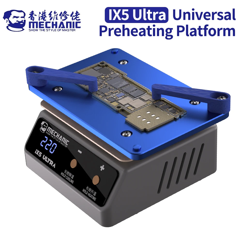

After a little research I purchased this one.
It’s still in transit but I think it’s good value for the money.
MECHANIC IX5 Ultra:
This is the bit I struggle with. My general rule for buying from china: don’t buy anything that runs directly from the mains; don’t buy products to be used for anything edible.
If I remember correctly the Mechanic hotplate above looks good but has an aluminium body and plugs into the mains with a 2 pin plug so is not earthed!
The body isn’t aluminium, but some kind of plastic. What I always do is place it on a silicone work mat, which is a bit more heat/fire resistent and maybe have a small fire extinguisher on hand. (And maybe create some clear space around it, so it can’t easily spread the fire to something else.)
Also, when using it, I don’t leave it unattended, so I can intervene quickly when it happens. Besides that, it’s a small unit, so there’s not so much to burn.
But do what you feel comfortable with! Normally I’m also very warry with (cheap) Chinese products, especially with build in Li-ion battery and charging. (Often taking it apart and see if the devise doesn’t overcharge and that it has a form of LVP.)
BTW, I also totally agree with no edibles from China and even no “kitchenware” or other things for consuming food with/in. Saw a fun couple of shot glasses, but were made from some sort of ‘plastic’ and you have no clue if it’s food grade/safe or has harmfull chemicals in them.
I think an electric shock was a concern, not a fire. (Edit: regarding the part about aluminum body and lack of earth)
But if the body is plactic then the presence of the optocouple and transformer makes me hope the high voltage part is isolated from the heating circuit. I was also concidering buying this plate but haven’t decided if I really need it.
Or not. It might be isolated only from the control circuit.

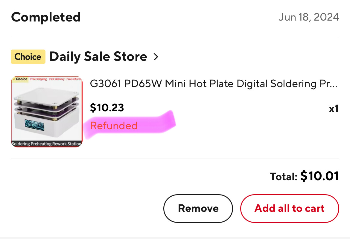

I had a G3061 PD65W Mini Hot Plate but the temperature sensor (which is glued to the bottom of the hotplate) fell off and the unit started smoking.
Luckily I was there and unplugged it before anything crazy happened.
