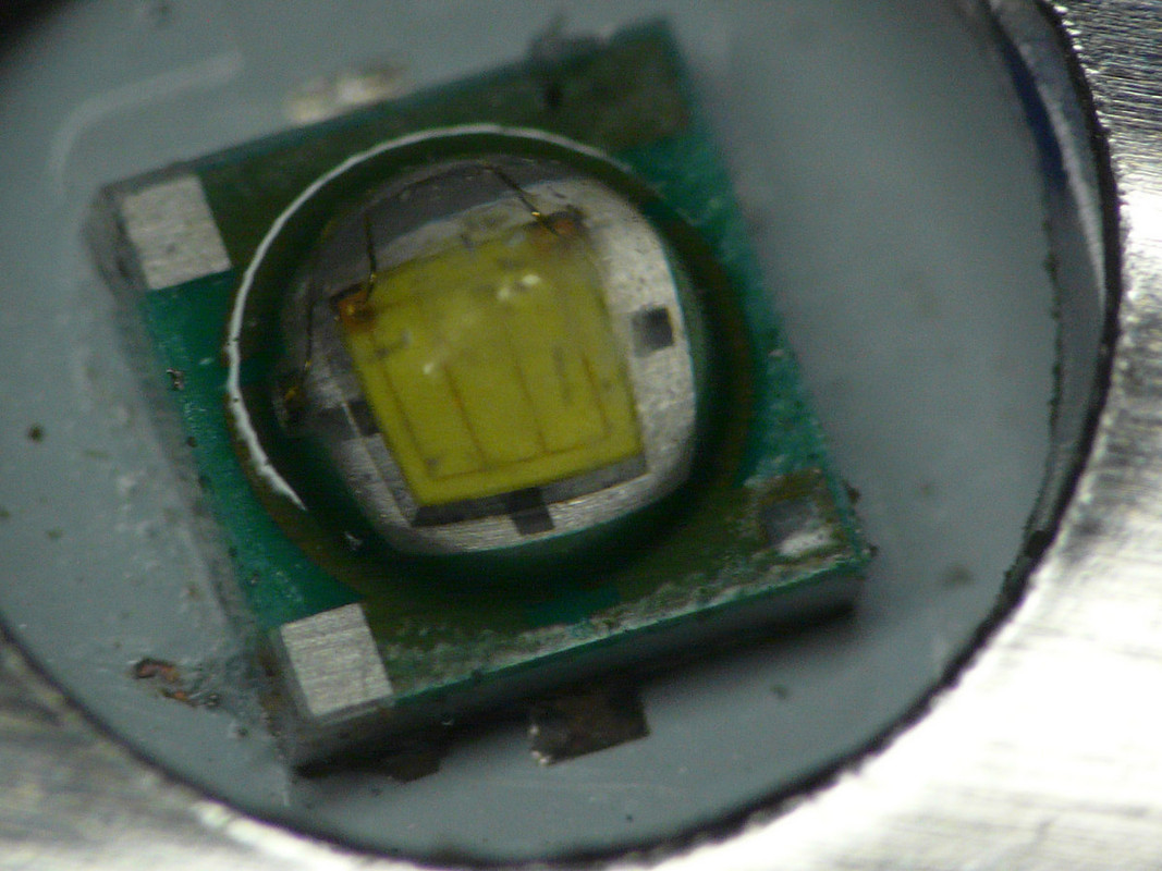

After dropping it (unintentionally, on a carpet, so nothing broke) the LED base, which is held in place by a clear plastic separator ring and the friction fit reflector, came loose; so I mounted the base on two toothpicks (the cables are just long enough for that) and cleaned the LED dome thoroughly with a cleaning cloth for eyeglasses. Now its beam is slightly clearer and more intense than that of the other light. There is no heatsink behind the LED base, I don’t know if one an XPE requires one. I forgot to measure the diameter of the base, which might have been useful for fitting a heatsink.
Closeups of the LED:
