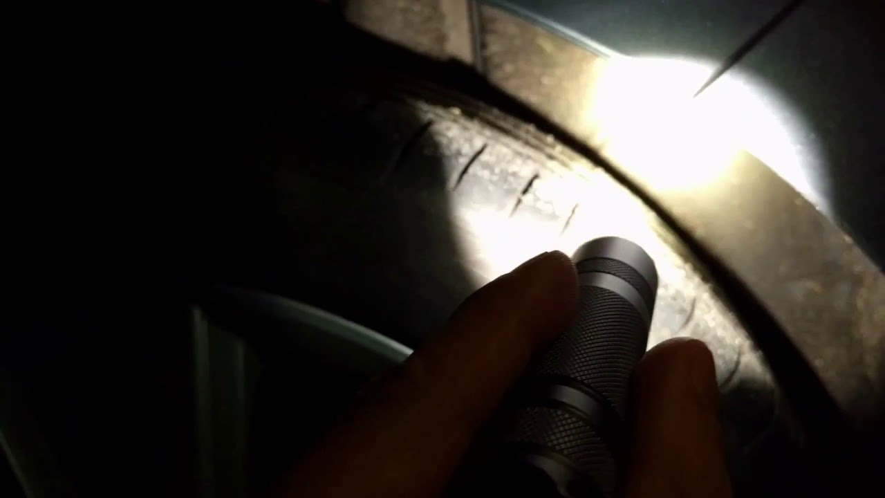

Today I received some TIR lenses I ordered 2 weeks ago, to modify this flashlight, following vwpieces suggestion on this thread! So thanks, for it :+1:
As seen before, the original beam is very narrow, so I wanted it to get a bit floody. Being an AA/ 14500 flashlight, I rather have it with a flood beam than with throw, as the main use I’ll have for it will be at close range.
I ordered 2 different types of lenses: 1 that has the “hive” look (60º) and 1 that has a flat surface (also 60º).
They produce different types of beams, as you probably know, and as will be shown in the pictures.
NOTE 1: The lenses came with plastic holders (cylindrical and cone shaped) but the holders (16.6mm to 17mm diameter) didn’t fit the head of the flashlight. The lenses, without holder, have 15mm diameter, so they fit the head and that’s they way I used them, without holder.
NOTE 2: The lenses that arrived and “shorter” in height than the original lens, so some strategies have to be used so that the battery fits properly inside the host. I’ll show what I’ve done.
The 3 lenses:
L > R (“Hive” 60º - Flat 60º - Original (center is frosted) )
L > R (Flat 60º - Original - “Hive” 60º)
Spill/beam comparison in a wall and over a white surface (photos taken by a cellphone):
L > R (“Hive” 60º - Original - Flat 60º)
Original spill
“Hive” 60º spill
Flat 60º spill
“Tricks” I had to use for the lenses and battery
1 - “Gasket” from another light I recently modded. The original led of that light as super small (blame me, I don’t know the type of it :person_facepalming: ) but it fits the LED of these flashlights (XP-G3). This gasket helps to center the LED and also helps to compensate the height lost comparing to the original lens. This one is being used in the flat surface lens
2 - Plastic holder, cut on its top and sanded (to reduce diameter) so that the base of the lens fits well on the LED! This one is being used in the “hive” lens!
3 - Small magnet in the top of the battery (Panasonic Evolta Ni-MH, button top) because the space left by the original lens originated that the pill goes up and leaves more space below; then, the battery rattles and the modes jump to the next with a slight shake!
Short conclusions:
1 - I prefer the “hive” lens, as the flood is uniform and it is better for close range or to illuminate a room (on High, at least);
2 - The tint seems to change from CW to NW when the “hive” lens is placed, what makes it not so annoying as the original;
3 - The flat lens seems to accentuate the CW tint (maybe because it is more direct light, not frosted as the original, or as the “hive” shaped);
Next steps:
- try one of these with a reflector and glass lens (borrowed from another flashlight);
- mod 1 or 2 drivers (I’ll keep one in the original shape)
- mod the LEDs, maybe to a XML2 (14mm, T6-3B and T6-4C) (yeah, it will be hard to fit in the lens and the holder, by I’ll try it )
Hope this helps the interested people on these lights :+1:
