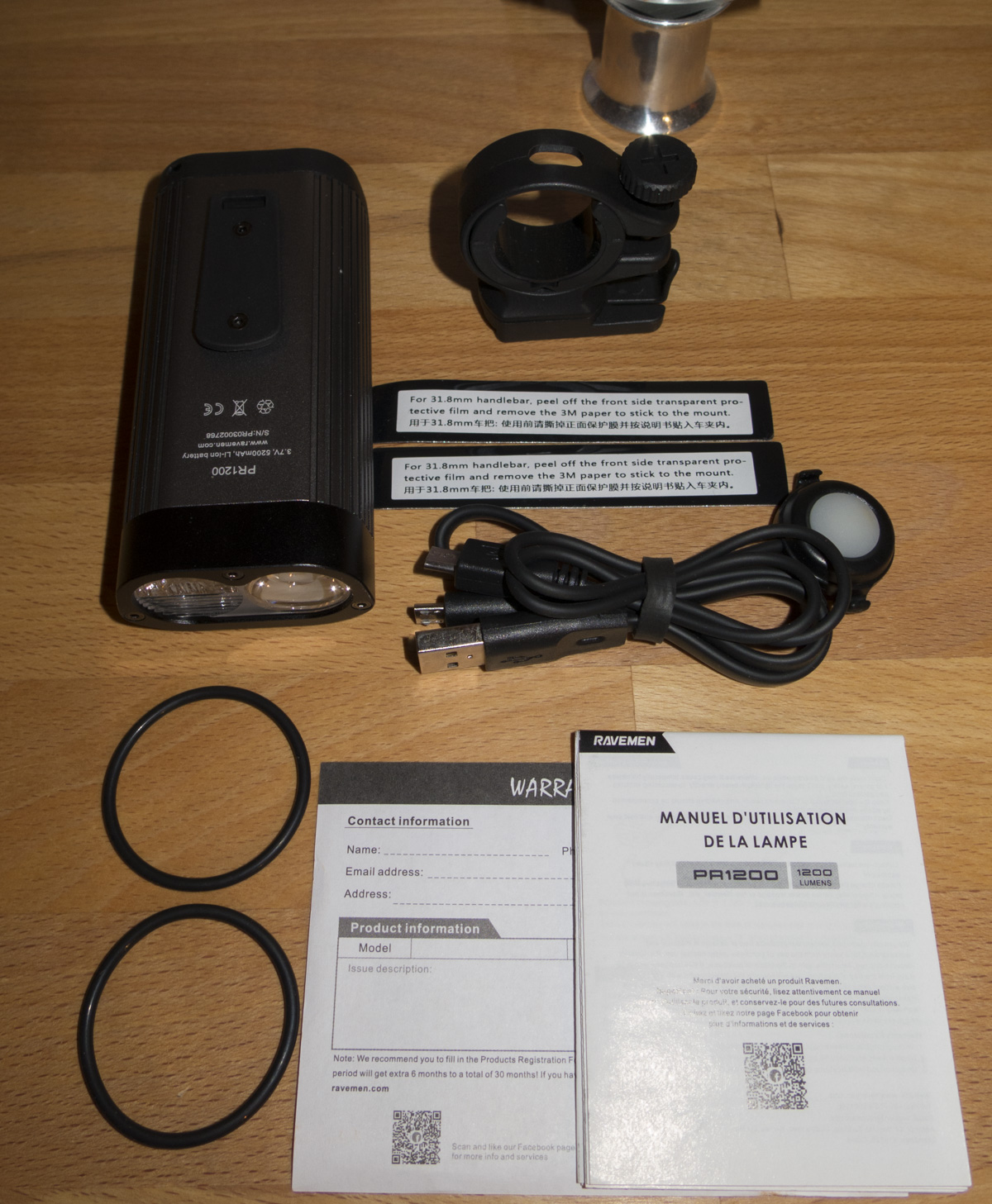

Package and content:
The lights box came packed well with a plenty wrap around and in a plastic bag

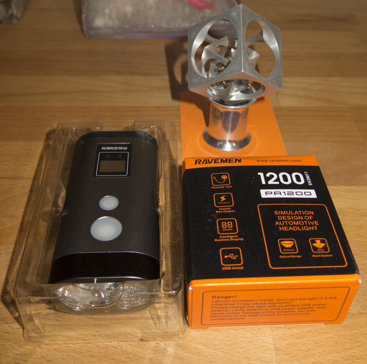

The light comes in a package with 2 sections one for the light and a small box with accessories
In the box is a plastic inlay with the light
It comes with:

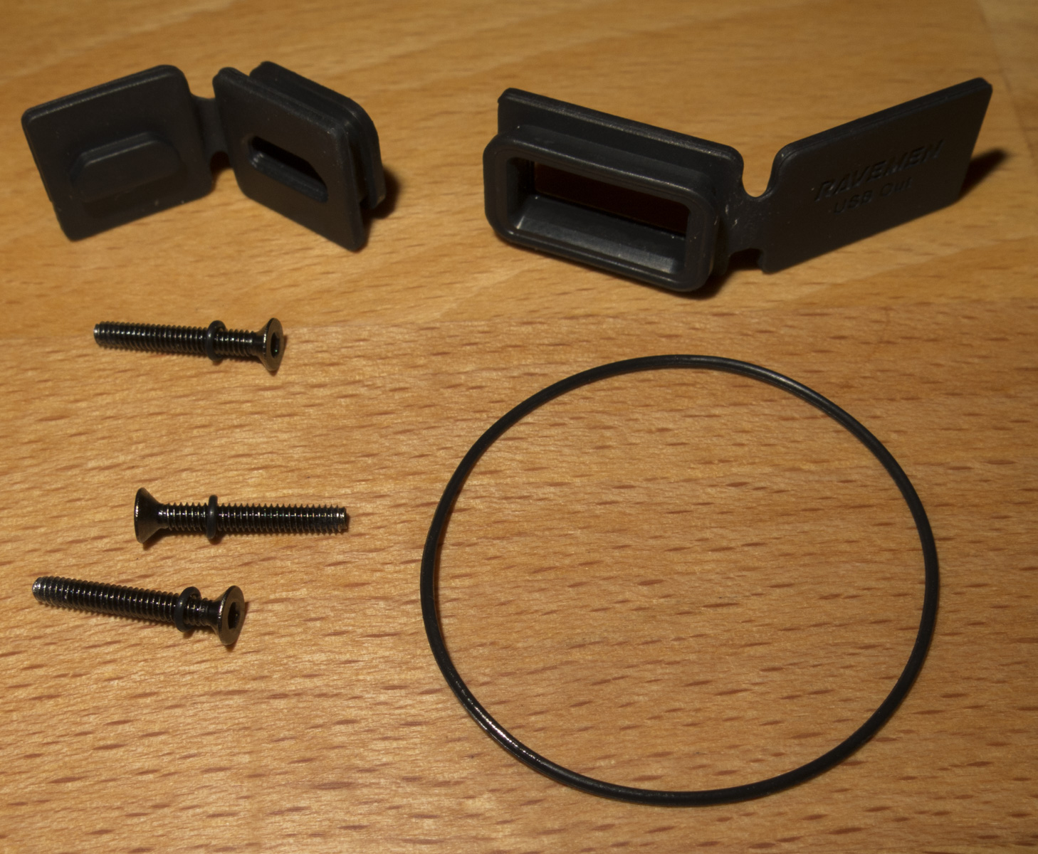

remote switch with 2 o-rings to mount it,
USB cable,
handlebars mount,
2 adhesive stripes,
manual and warranty card
The manual is in 4 languages, but the text is very small and hard to read

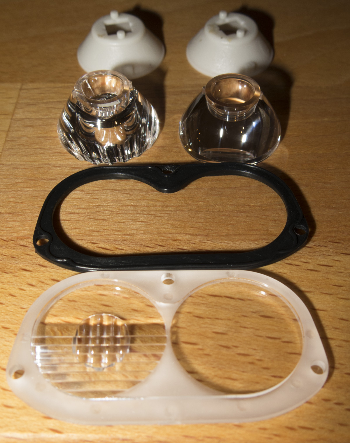

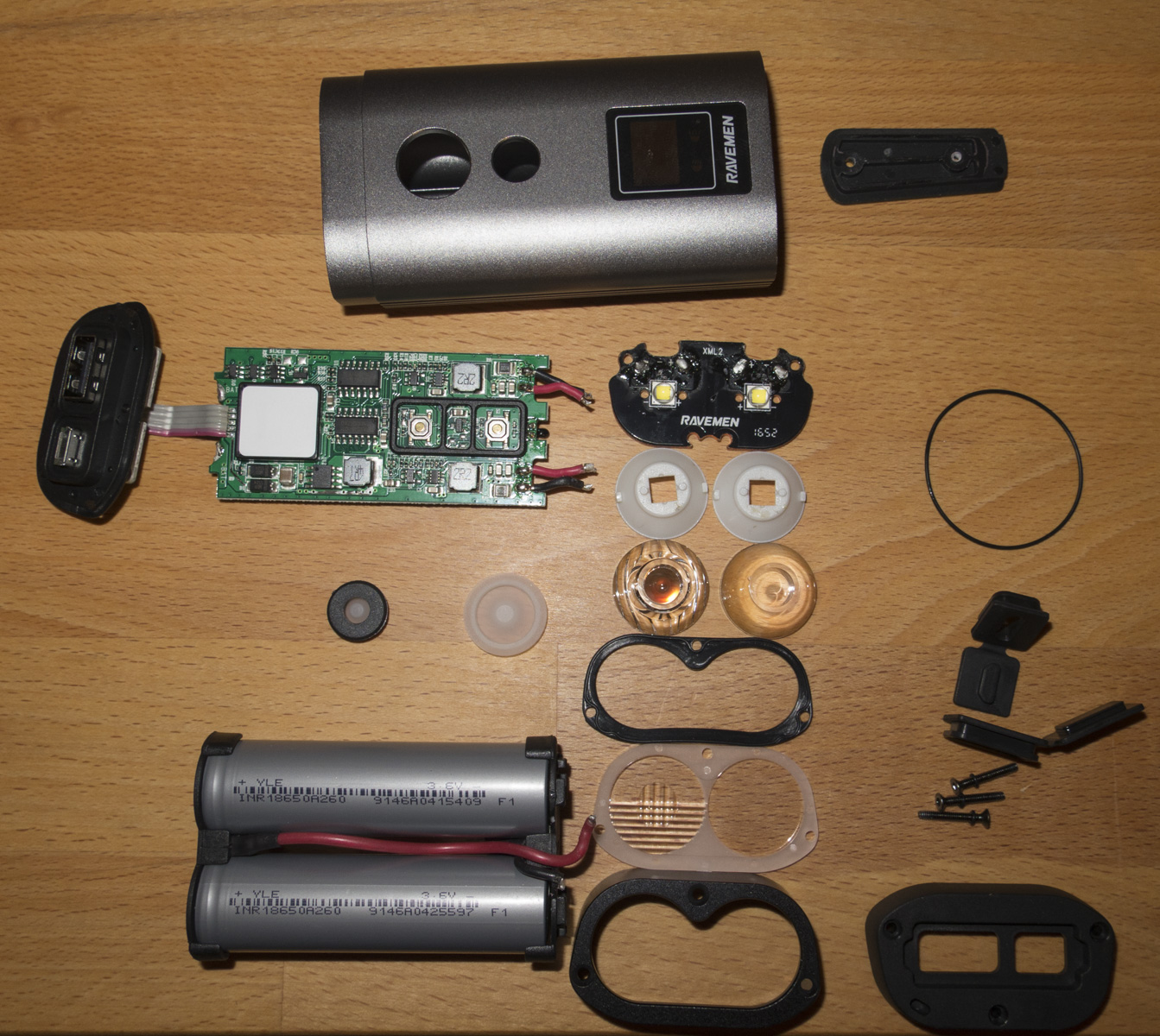

Teardown:

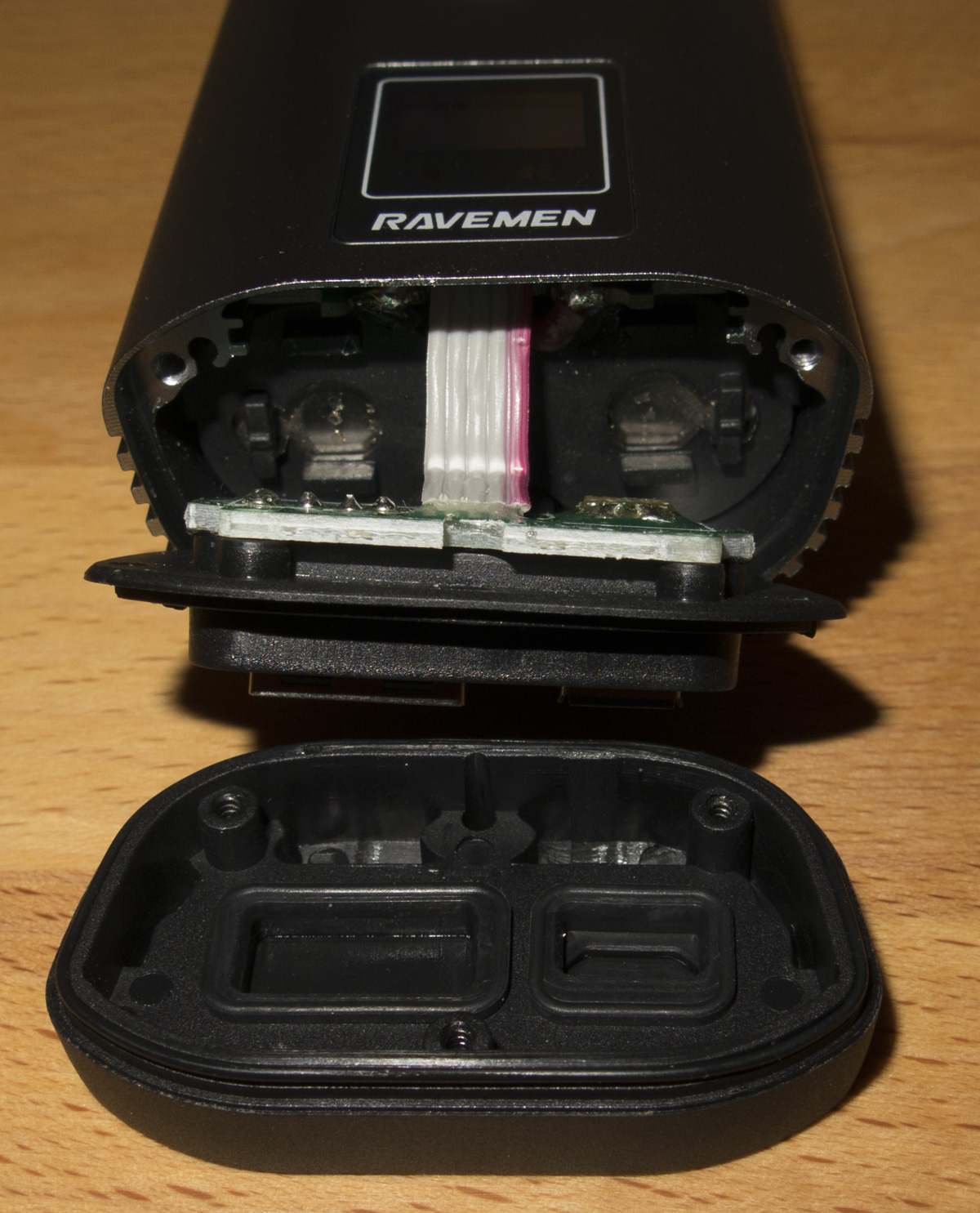

The light is easily taken apart, only the adapter plate for the mount is glued and screwed to the light

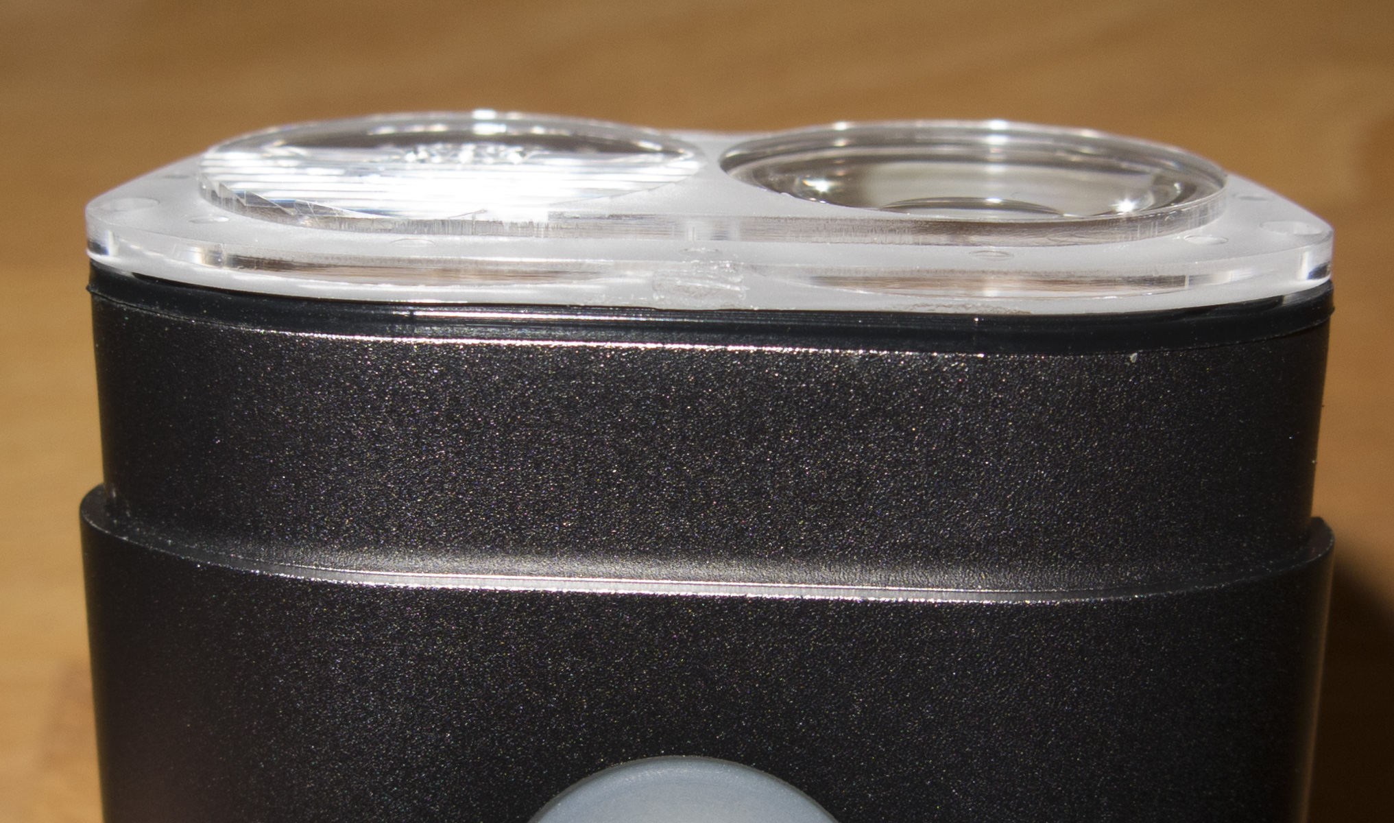

The front bezel is screwed with 3 small screws under it is the secondary optic and a rubber seal

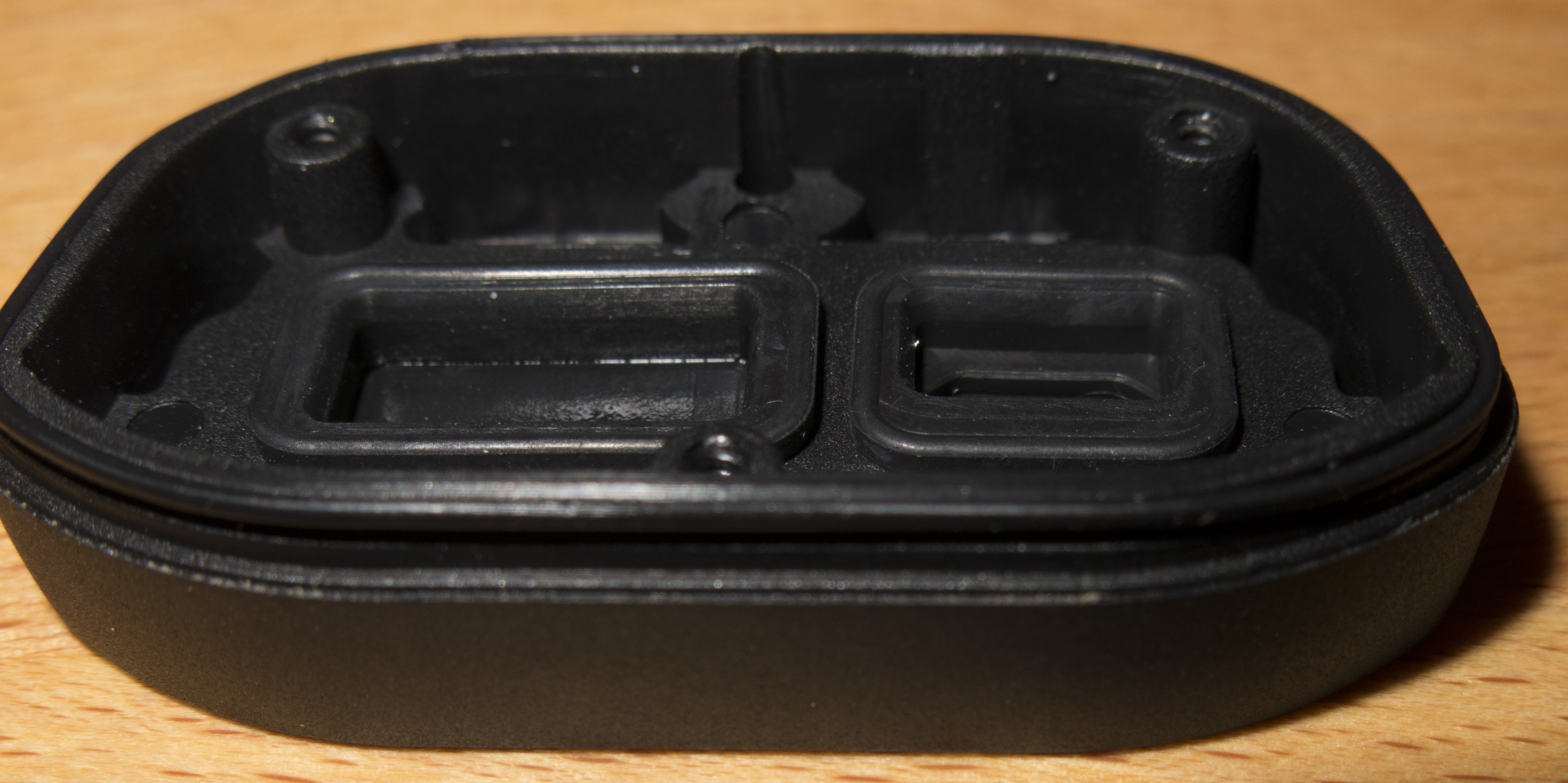

The back comes loose when 3 screws removed, the outer part is screwed also with 3 screws

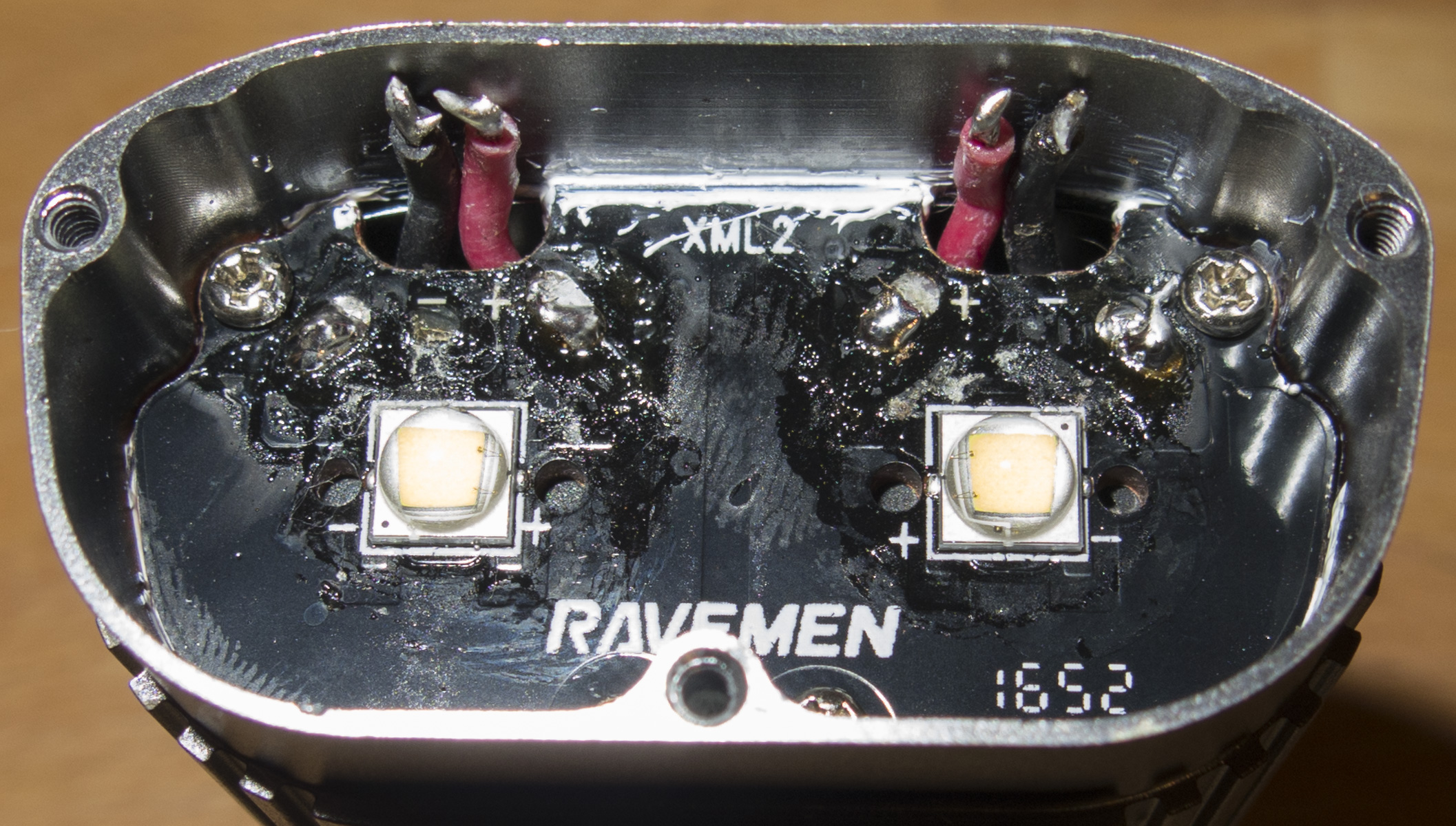

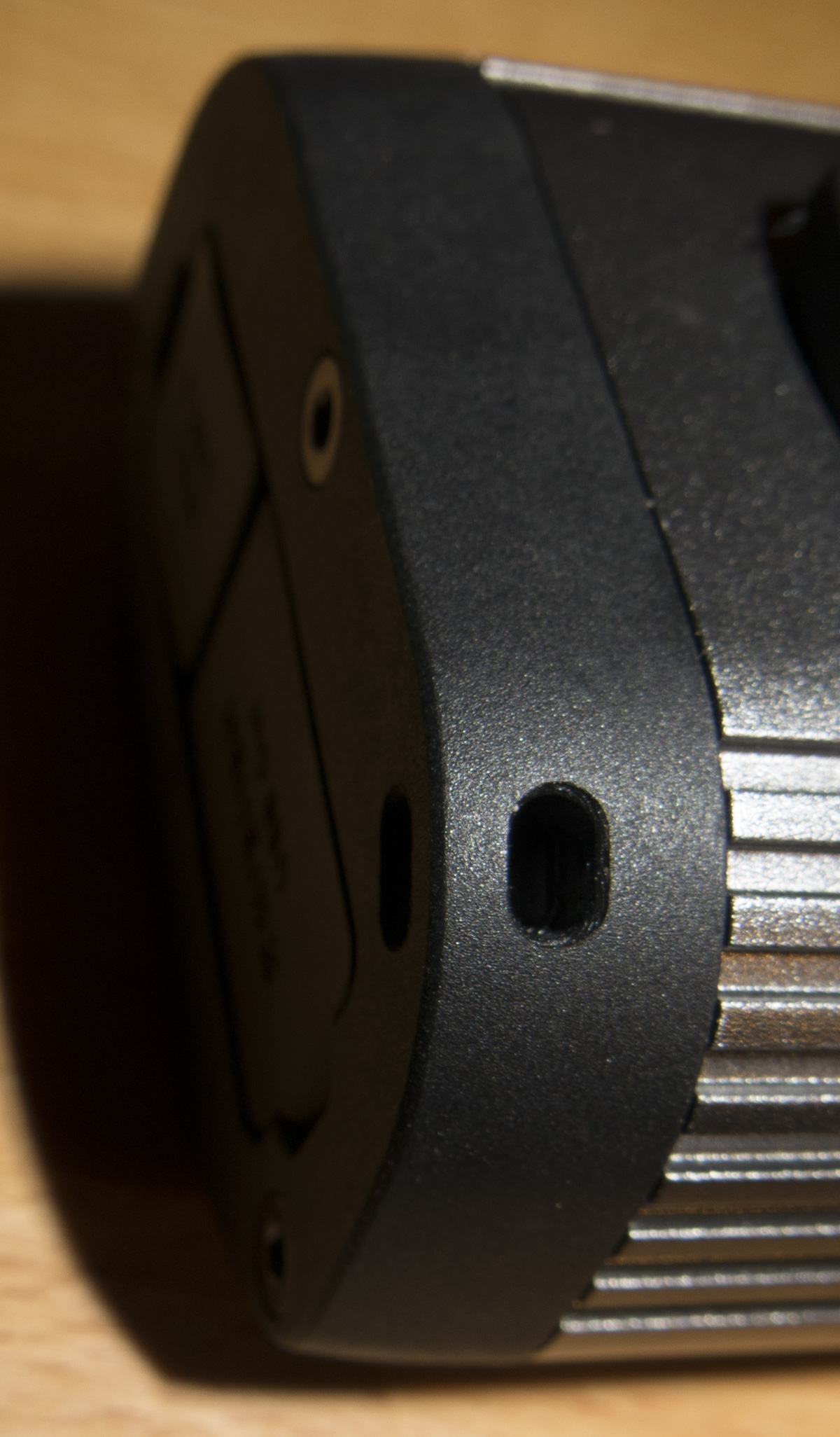

The PCB is screwed and glued with the plastic part, probably to seal the lights internals from water that gets past the USB covers
The LEDs are very good reflowed on a solid 2mm thick copper MCPCB, there is no shelf,
but it is pressed in the tube and make contact on some spots to the outer wall and the area where it is screwed
It would have been nice if some heat paste to enhance the heat transfer even more

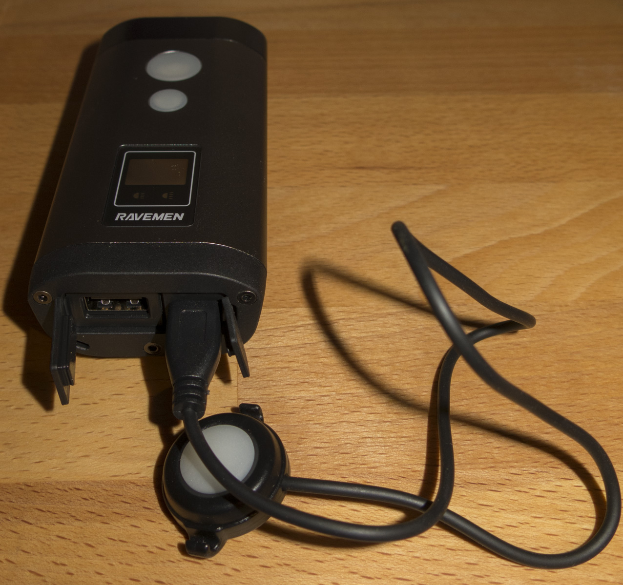

The light has a hole for a lanyard
The light stands on the tail if it is used ceiling bounce in a tent or so

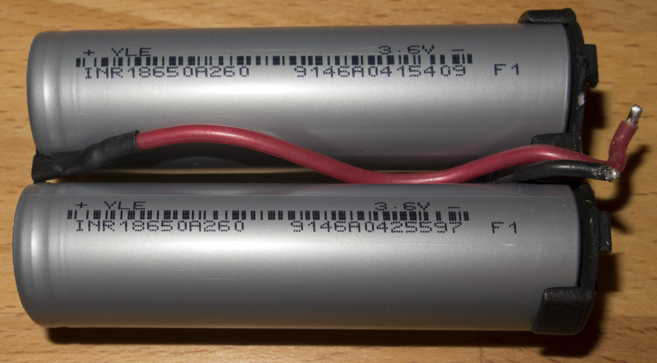

The light has an internal battery of 2 2600mA 2C low drain cells, that can also acts as a power bank
The battery can get charged with micro USB socket, I measured about 2.9Ah per cell 3.01-4.19V
The driver has 2 separate buck converters for each LED
the LED wires are short and thick
The light has a good sealing against water, even the screws on the back have o-rings
The secondary and primary optics are plasic

I had the battery depleeted today
The light shuts down when the cells reach 3.01V
Then did a full charge
The build in charger charges with 1.5A
The measured capacity is 5.9Ah I would say than the LED display and electronics eat up about 100mAh
so the two 2.6Ah cells are charged from 3.0V to 4.19V with 2.9Ah

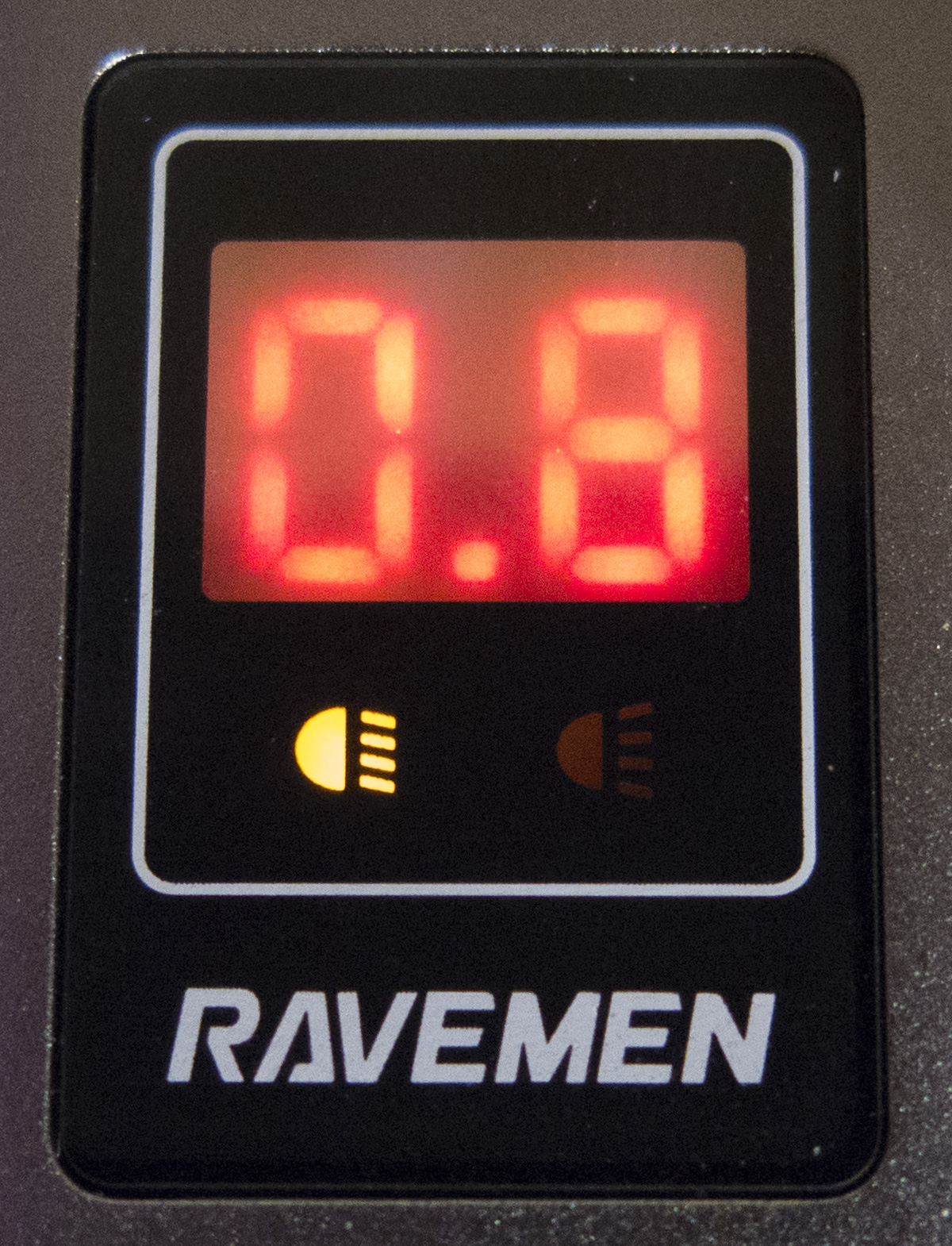

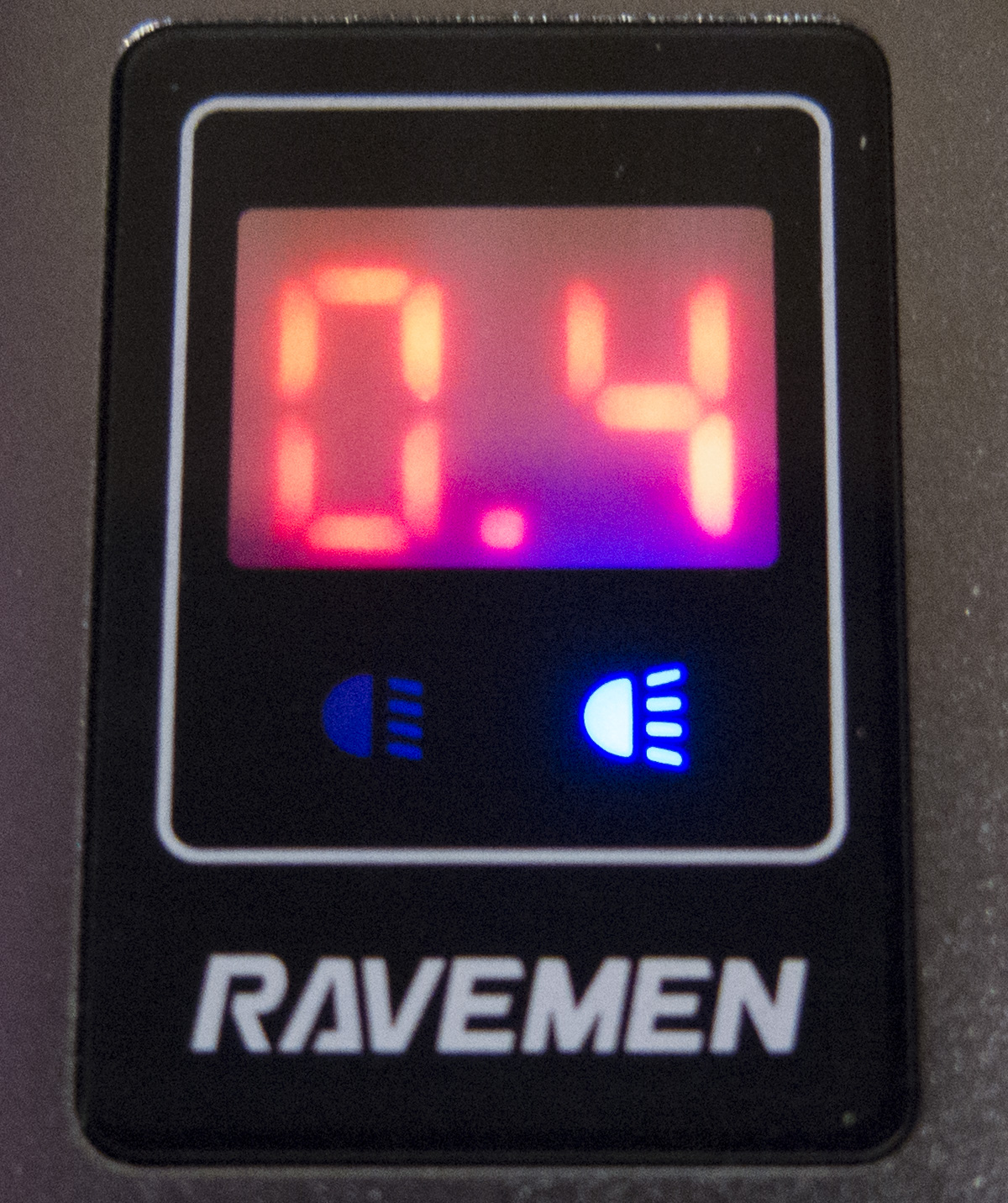

The light has a display which shows the remaining battery runtime and 2 symbols for low and high beam

I added some heat paste between the tubing and the MCPCB

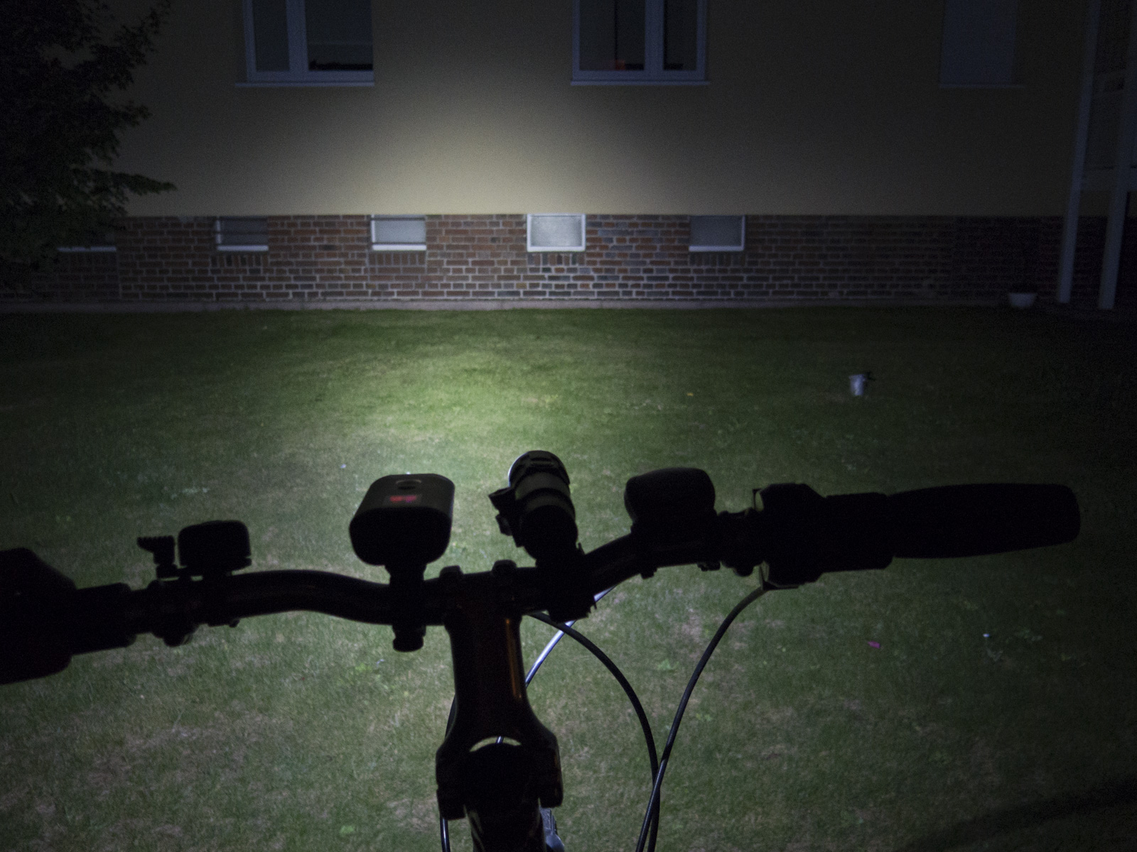

Beam shots

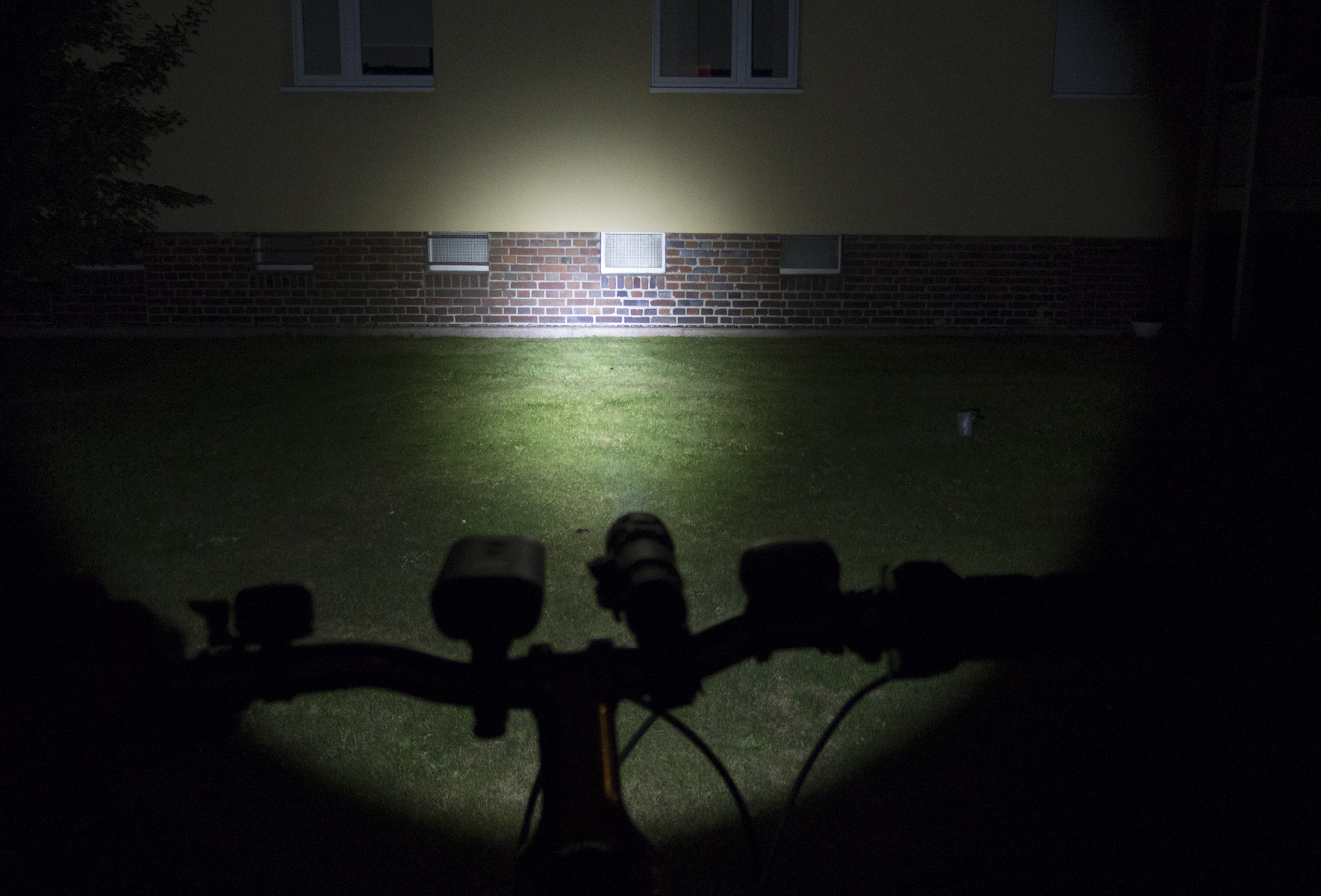

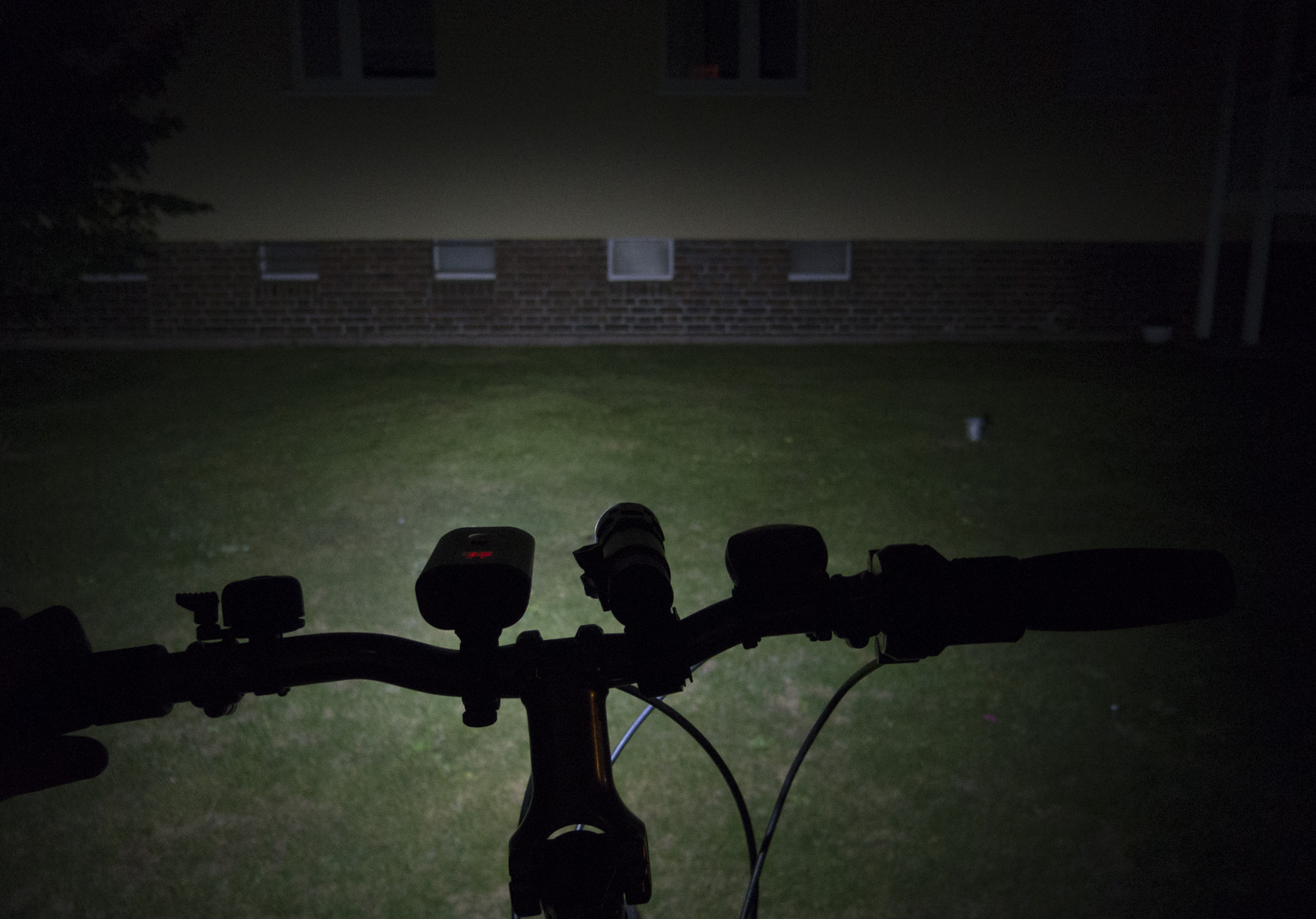

distance to wall 10m

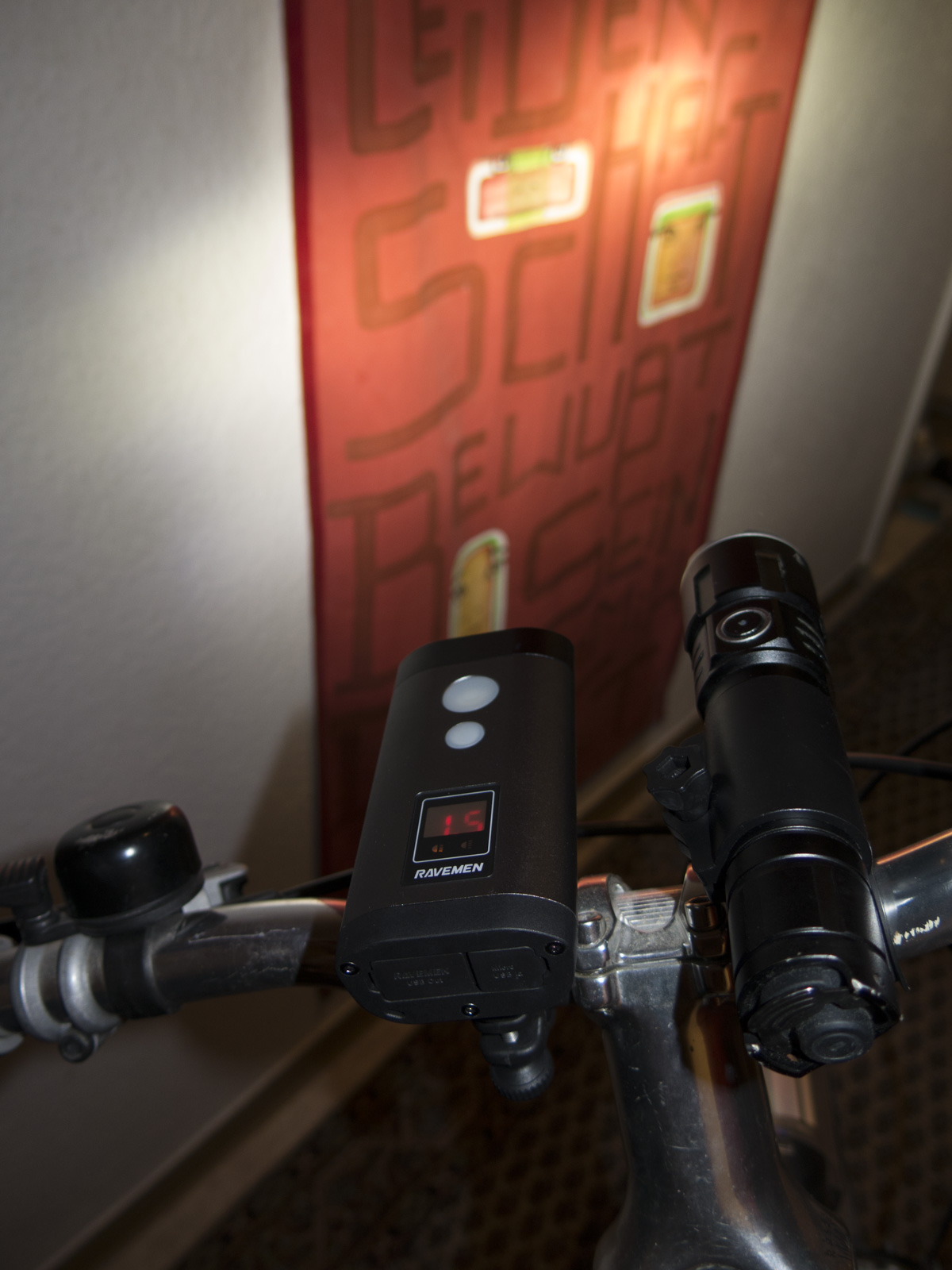

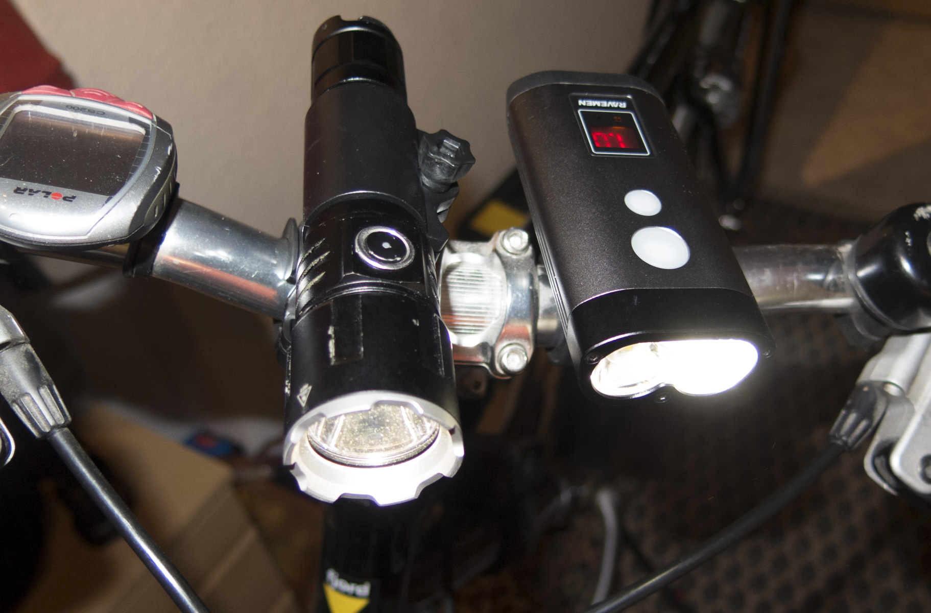

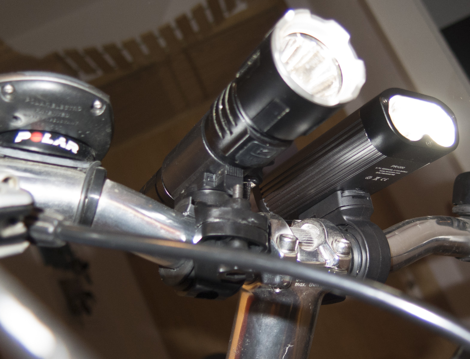

my last bike light Klarus XT11GT with XPL HI V3-3C
narrow hotspot and useable spill
Ravemen PR1200 low beam
Ravemen PR1200 high beam
