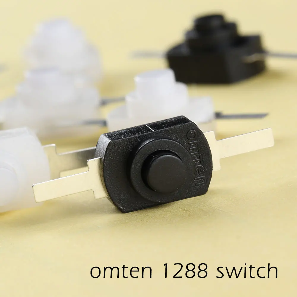

These switches are the same size as the one in the NEW M2:
The ones from Simon does not say Omten in the add.
These from CNQ say Omten. Not sure if there is a difference.
What type of switch is in the "OLD" M2?
