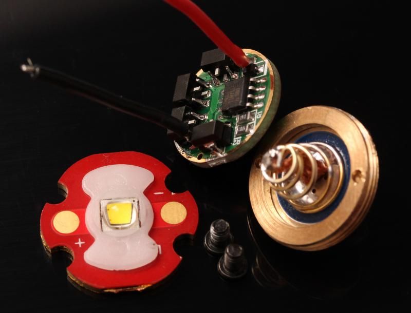

The contact board seems to be attached to the retaining ring.
Emitter sits deep in the reflector. (Not pictured with stock centering ring)
A good amount of very thin/wet thermal paste. Aluminium mcpcb.
Four holes, but no screws were used to hold the emitter/mcpcb down.
Here is the stock centering ring. Its a bit tall and according to my unofficial test, it was stealing about 1% of light output.
Retaining ring that sits nicely on the edge of the nanjg105C driver.
Some room for stacking more 7135 regulators if that is desired.
