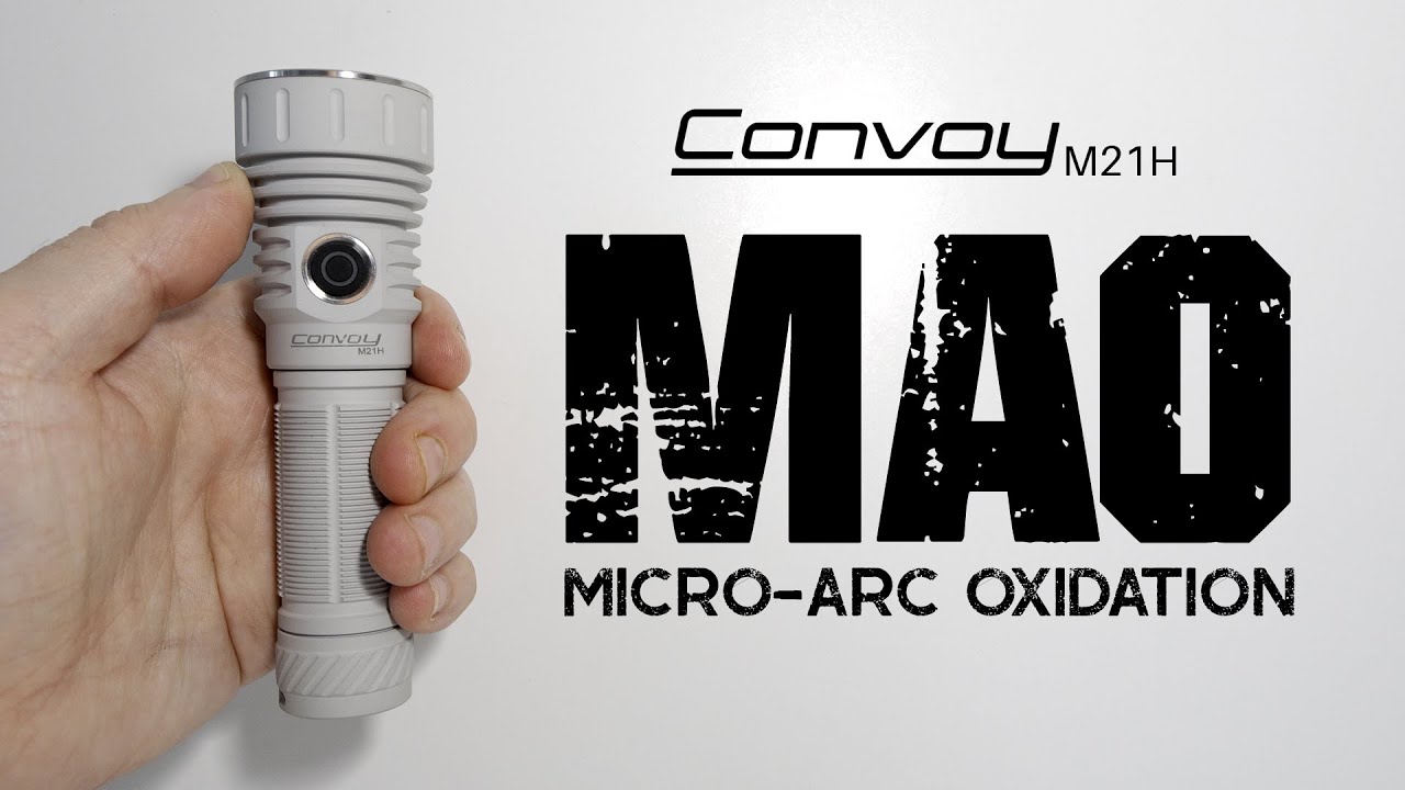

My review of the Convoy M21H 4000 lumens MAO treated Type-C flashlight with a 12 Degree Tir Bead Lens for an excellent beam.
The first Convoy I’ve reviewed that didn’t feel budget!
