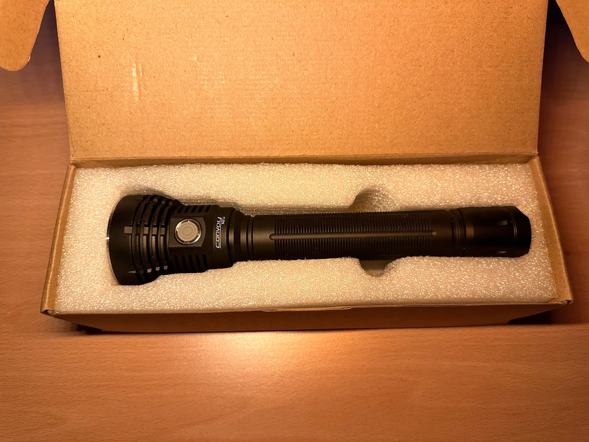

The Convoy M21J comes in a hard cardboard box.

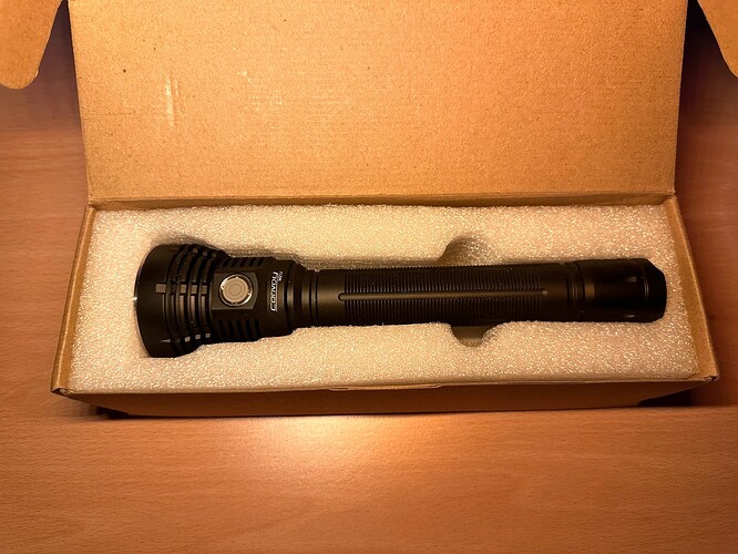

The flashlight is seated inside some laser cut foam for extra protection during shipping.
The Convoy M21J uses 2 x 21700 cells.

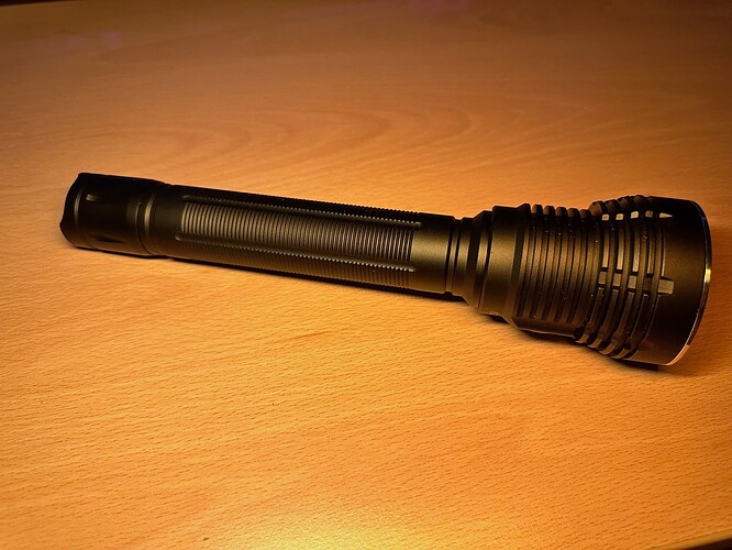

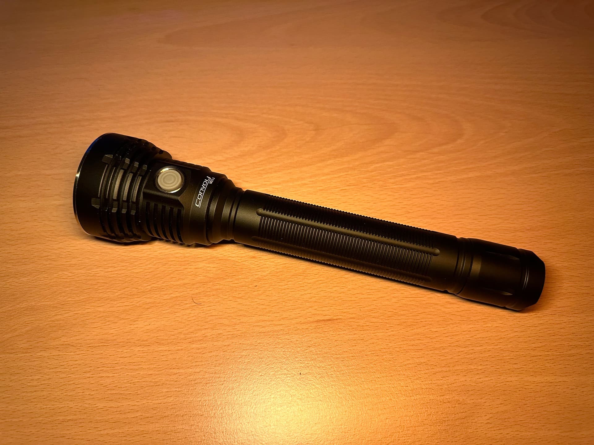

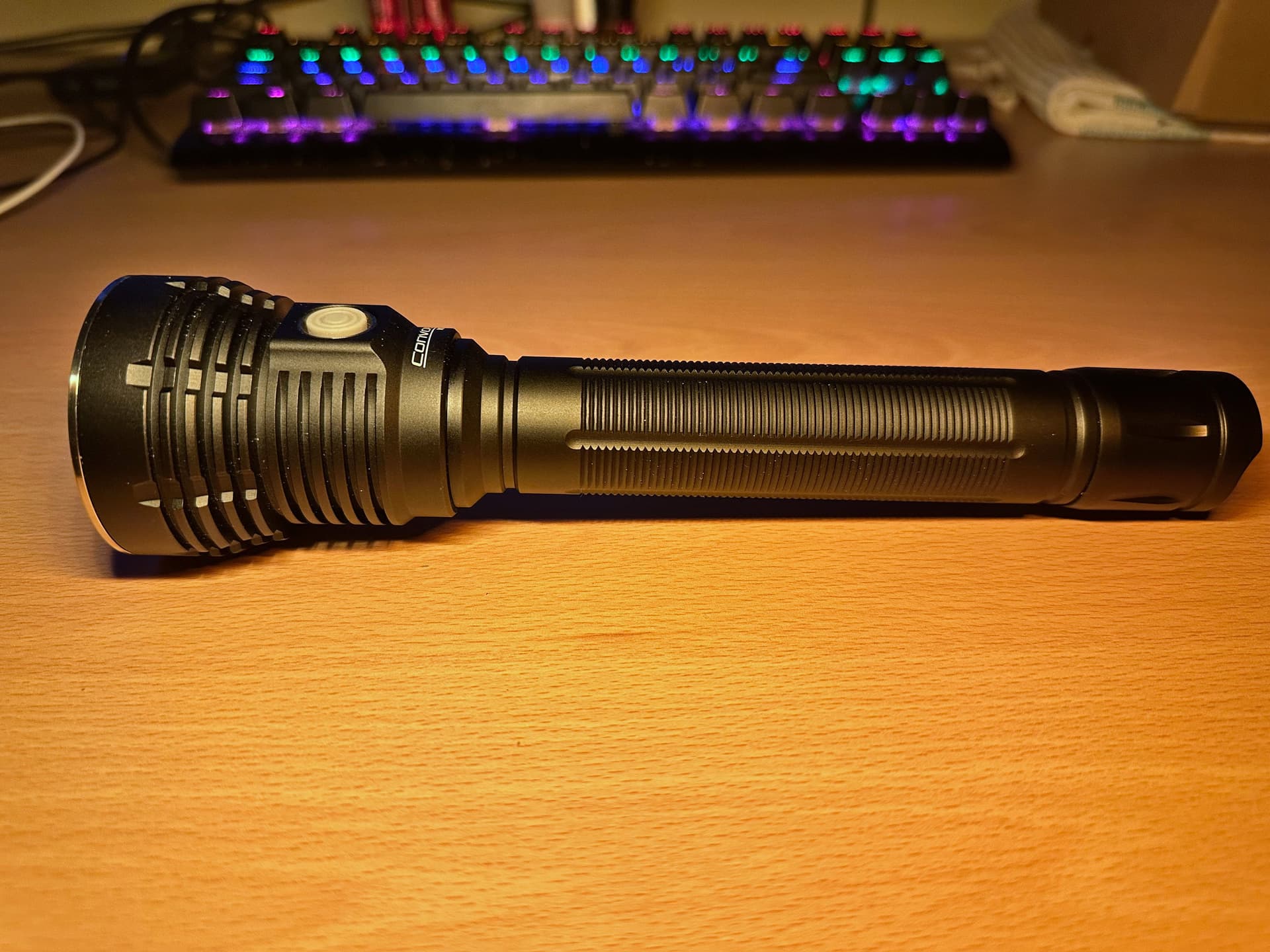

It comes with black anodization and as usual per the Convoy standards, the fit and finish is excellent.
Overall the light follows a very clean design.
Along its body and tail we find some grooving to enhance grip.

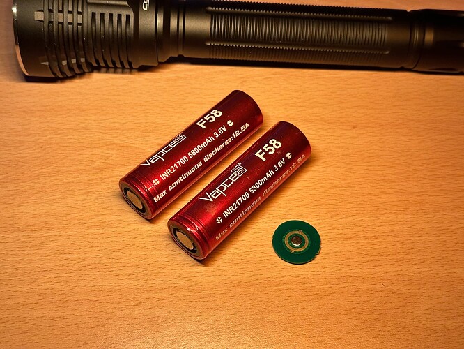

My own bundle also included two Vapcell F58 cells, rated with 5800mAh of capacity.
Along with the batteries, there’s also a spacer included that allows flat top cells to be able to contact each other.

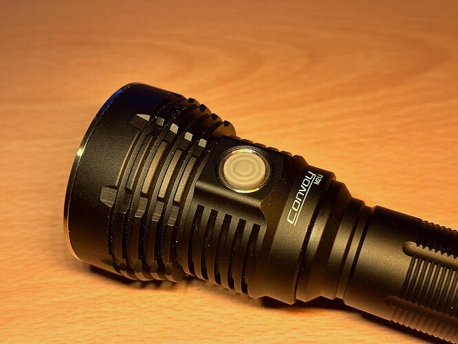

The M21J is operated via dual switches.

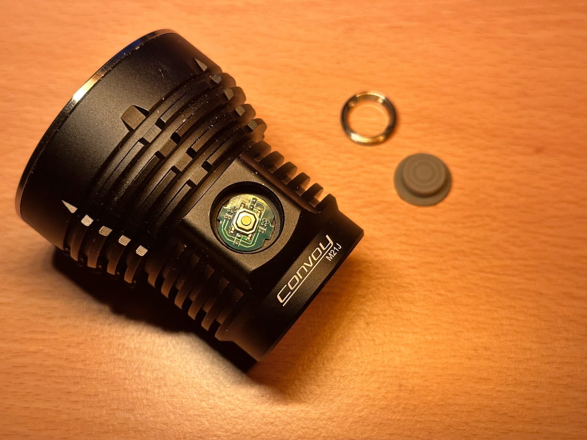

An electronic switch is mounted on the lower part of the head and it’s used to operate the modes of the flashlight.
The switch is covered by a semi translucent boot and is held in place by a polished metal retainer.

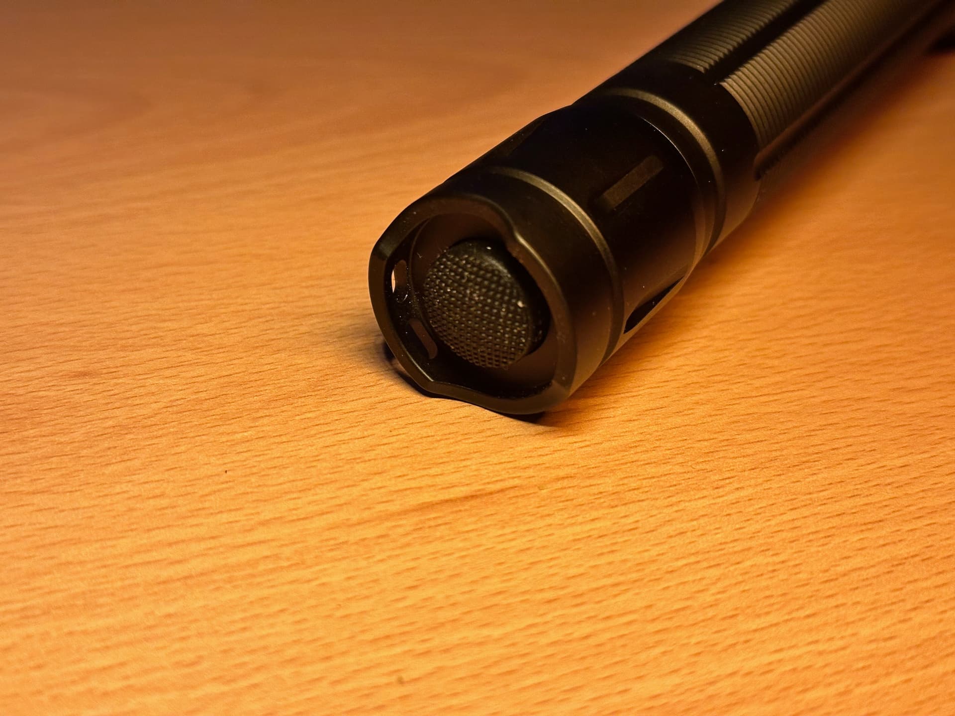

The power on/off of the flashlight is operated by the rear mechanical switch.

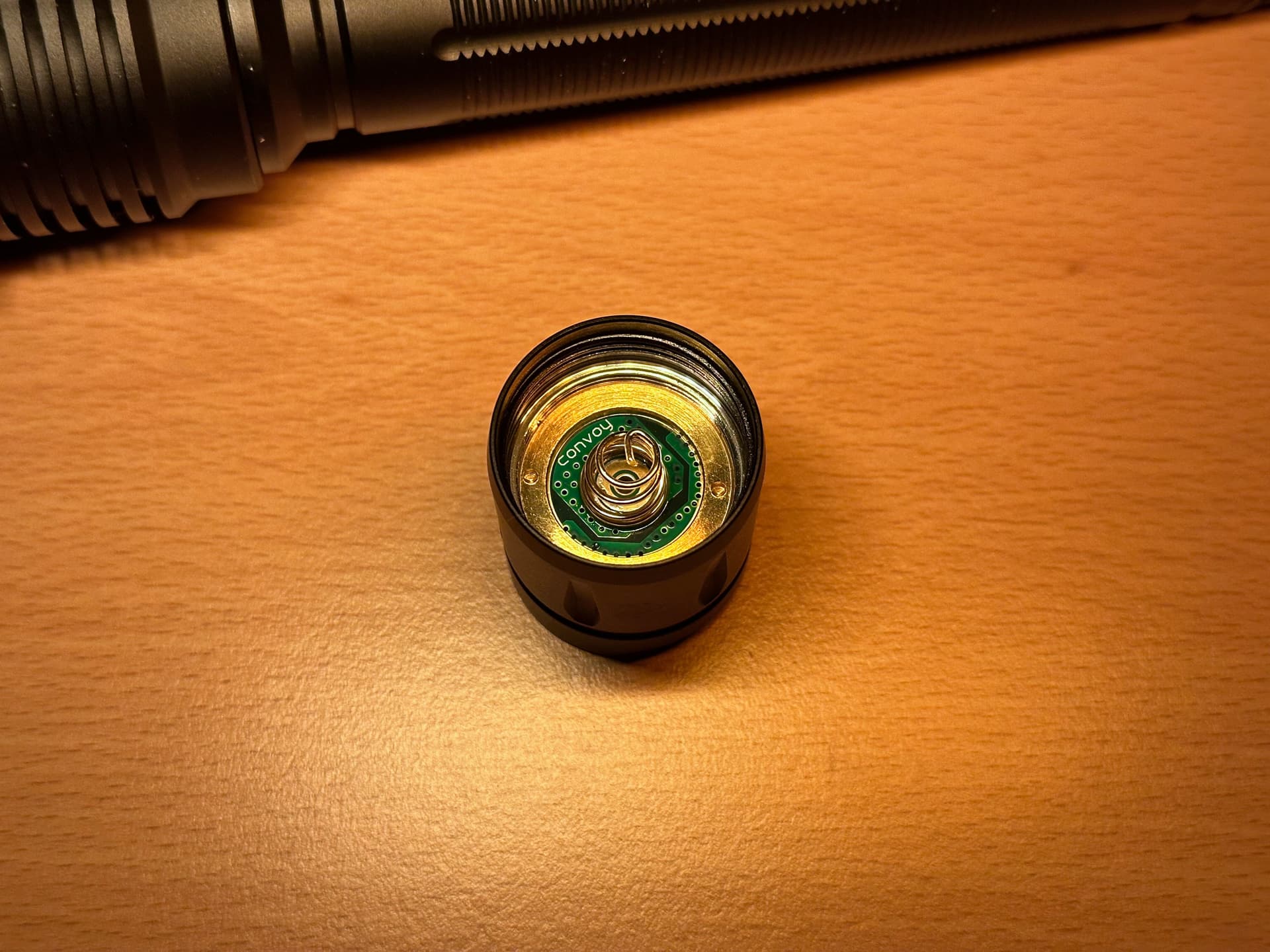

On the tail of the flashlight, we can see a thick copper spring.

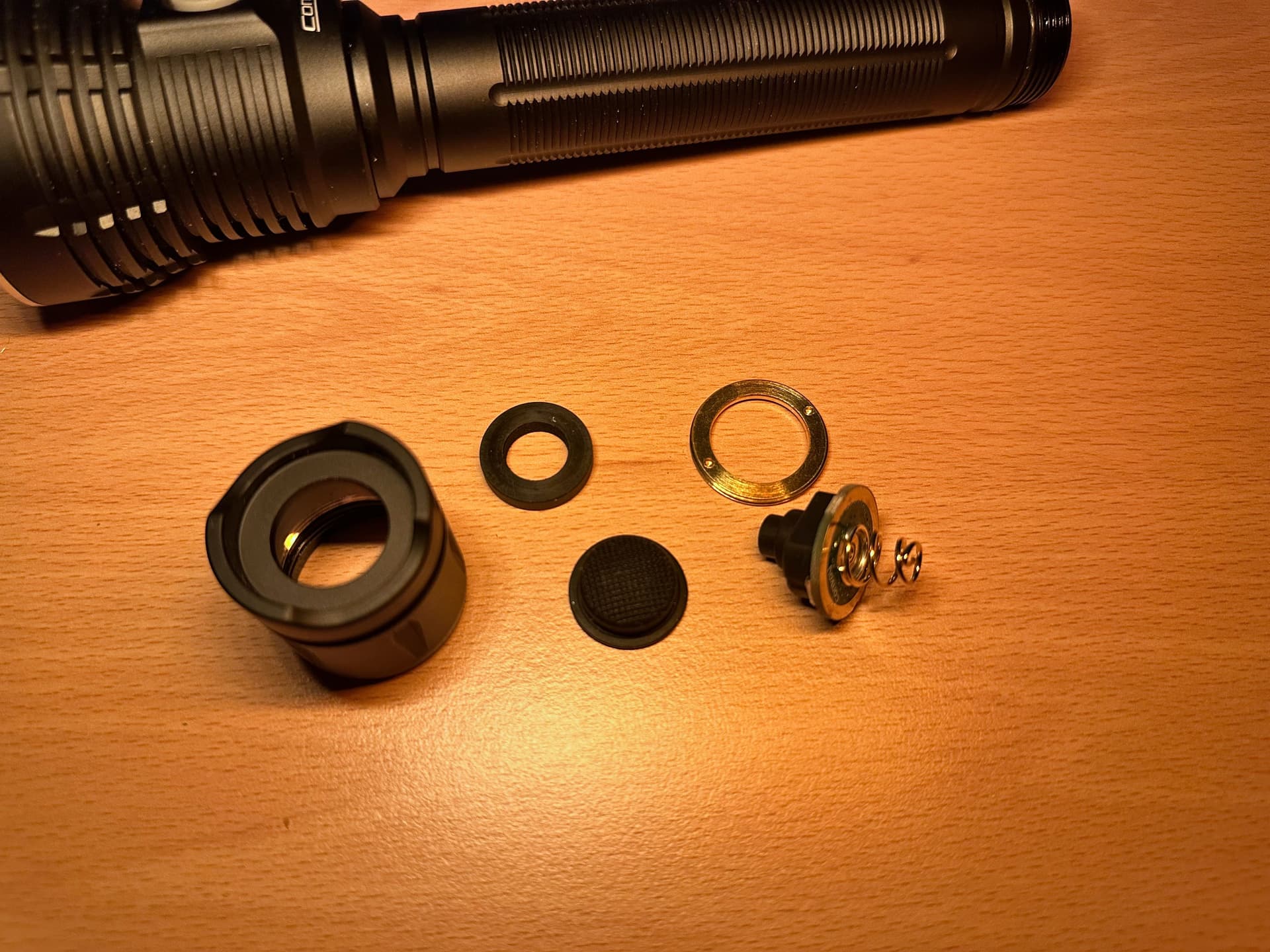

The switch assemebly is secured in place via a brass retainer.
Here’s the tail fully taken apart.

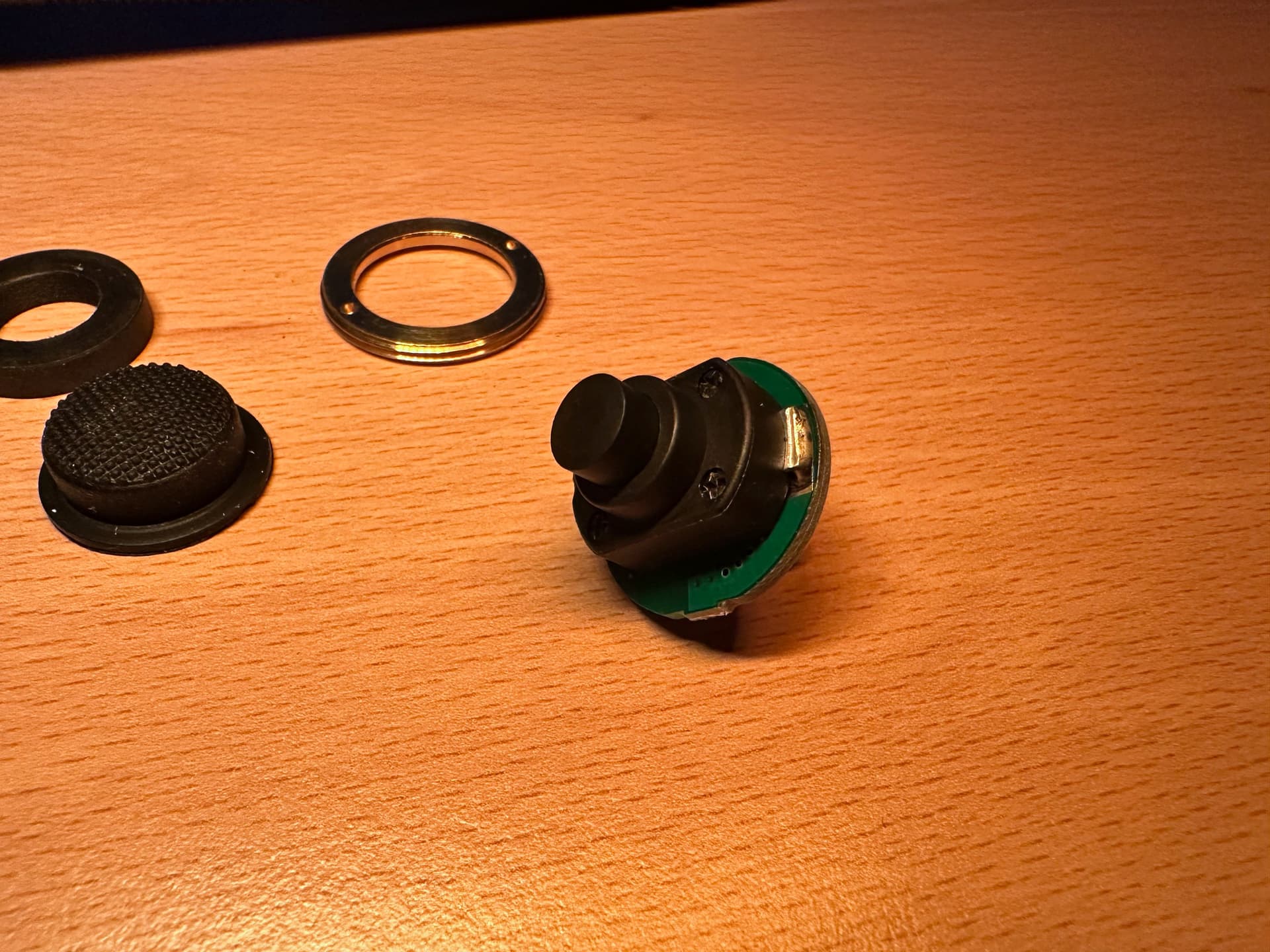

And a closer look at the switch.

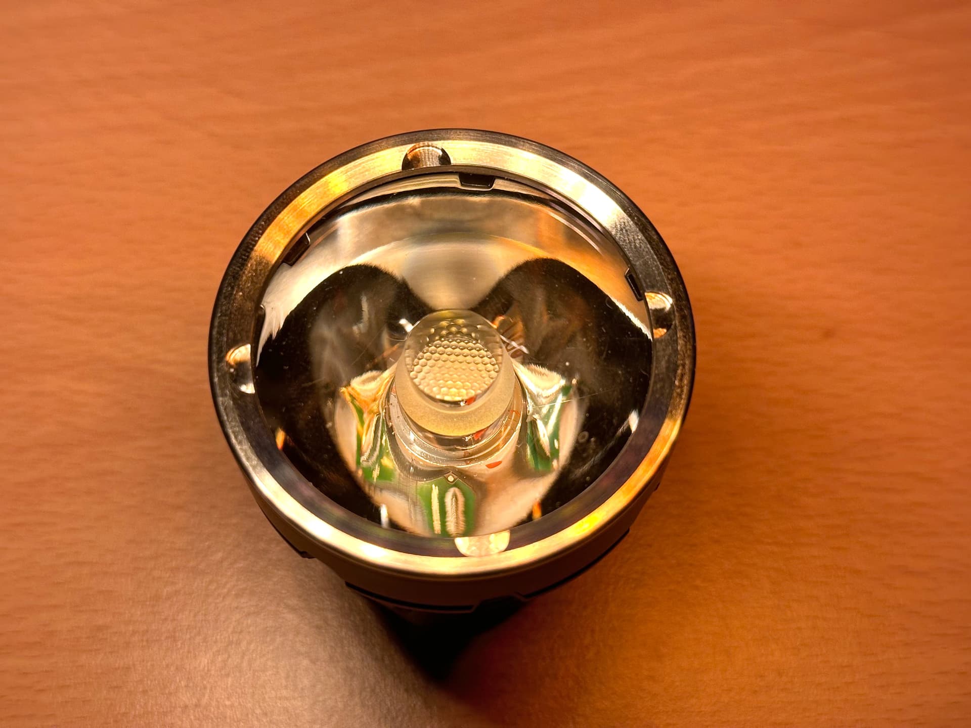

The head comes with a polished metal bezel.

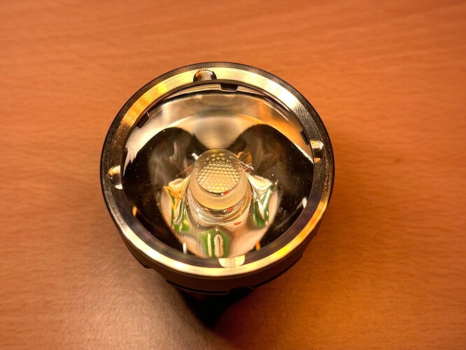

Inside the head we find a 50mm 3 degree TIR lens along with a Luminus SBT90.2 emitter.

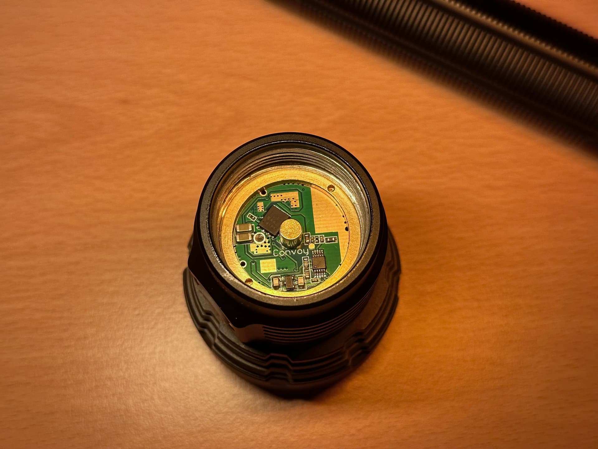

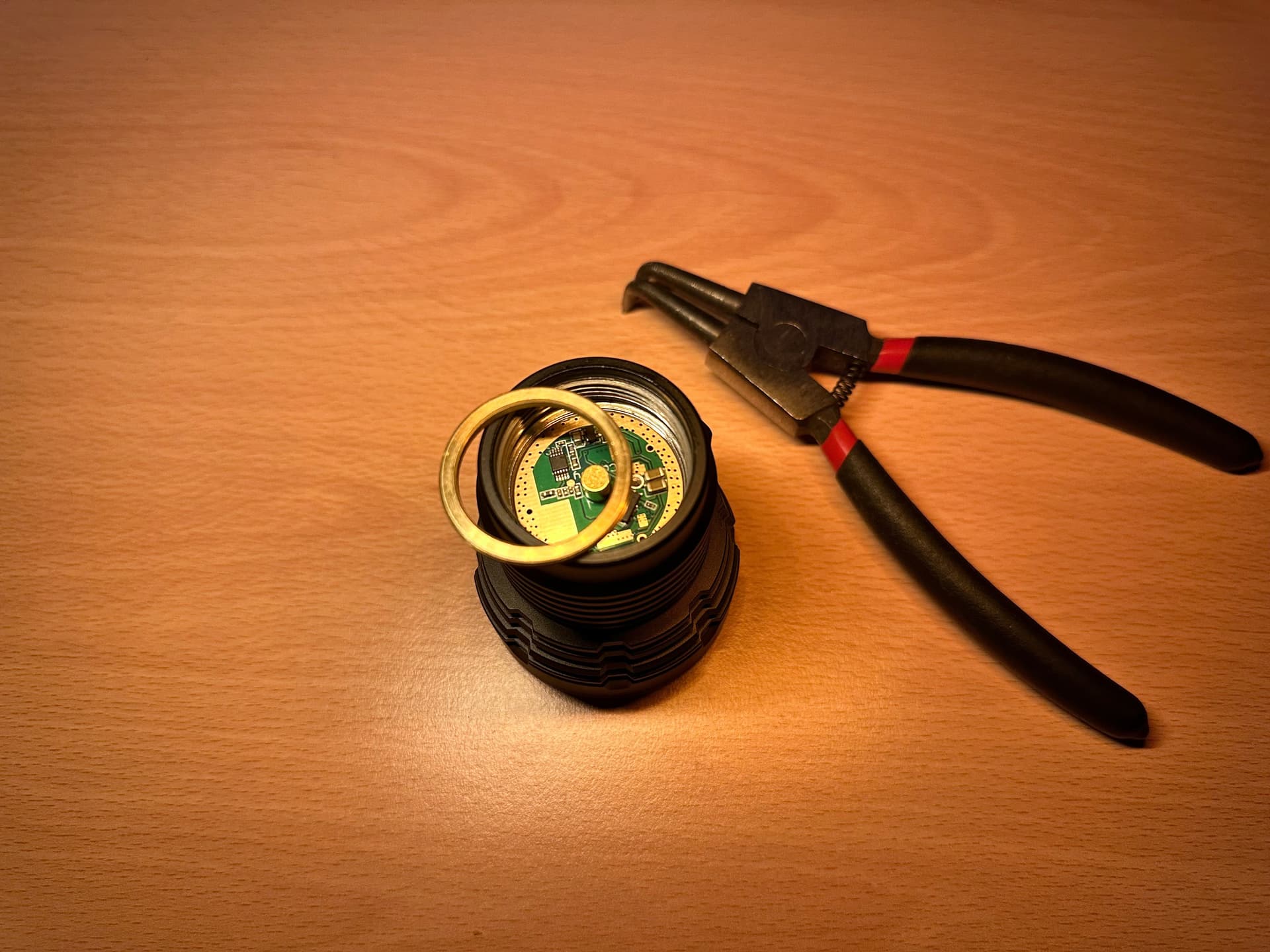

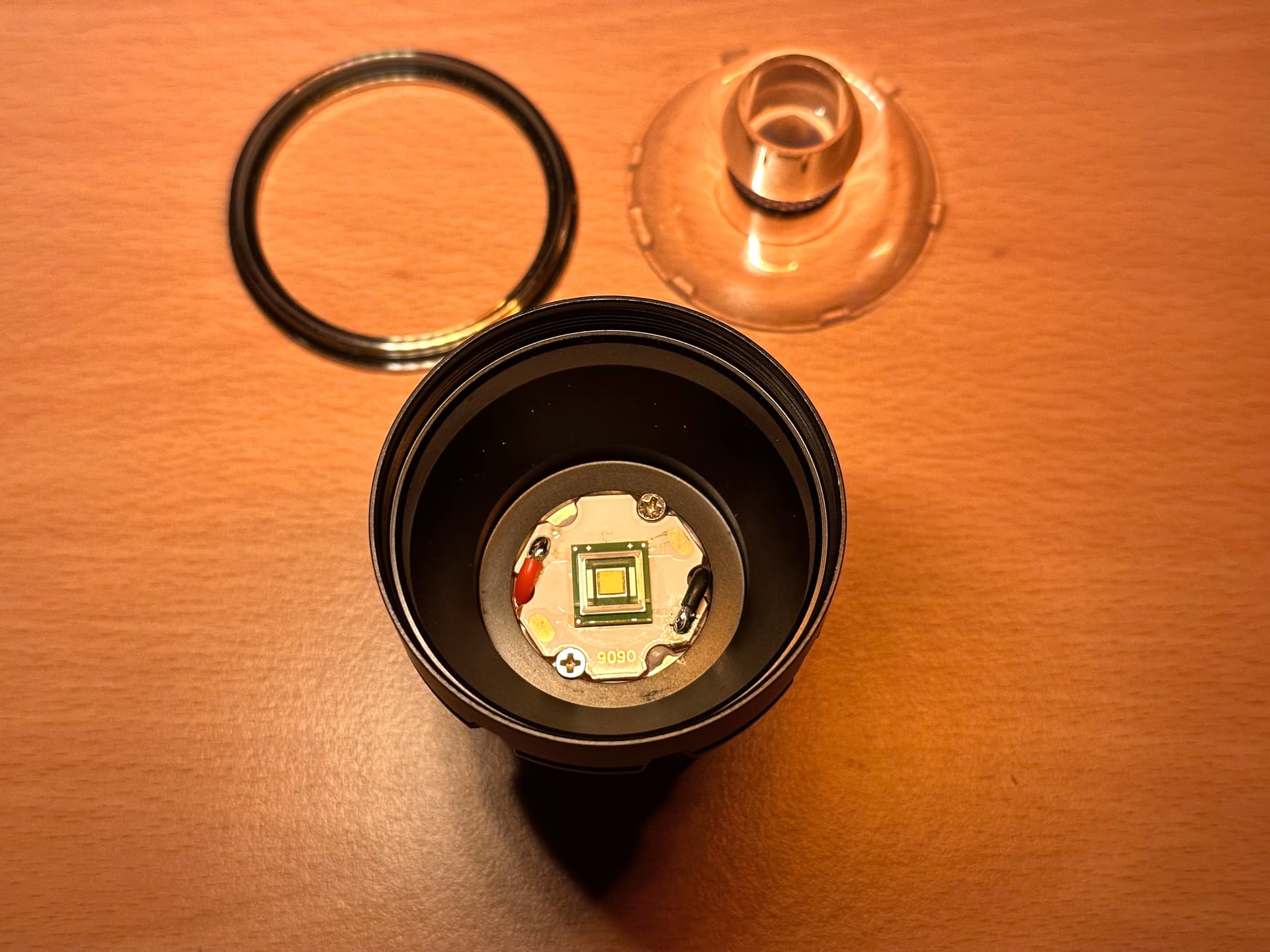

As with all Convoy flashlights, the head can be easily taken apart.

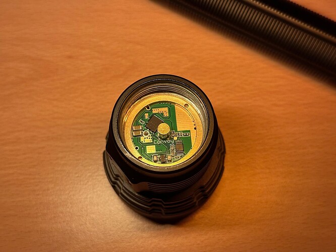

On the back side of the head, we find the driver, which according to the specs it can deliver up to 20.5A of output current. In order to minimise resistance, a brass tab is used as the positive terminal.
The driver is held in place via another brass retainer.

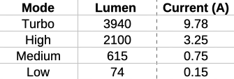

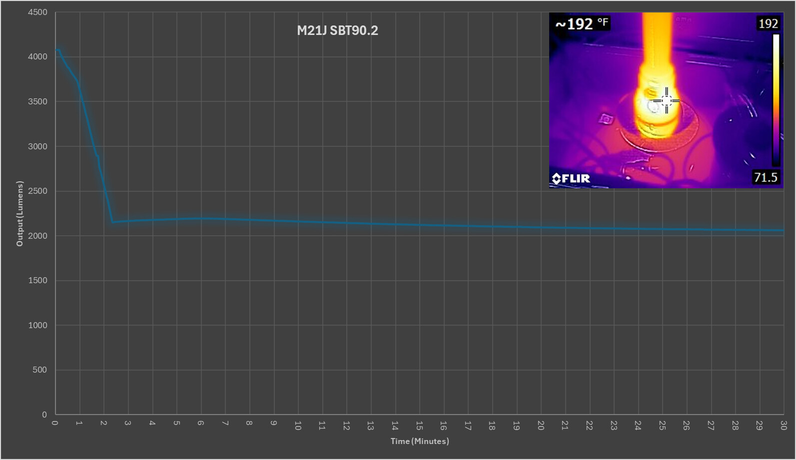

Here’s my output measurements using the included Vapcell F58 cells.
As we can see, the Convoy M21J pushes almost 4000 lumen OTF at startup while puling 9.78A from the cells connected in series.
Overall, mode spacing looks pretty good.

Thats a lot of light for fifty bucks.
Not even 10A on turbo? LOL
I’d have assume that’s because of the cells used, those F58 have a CDR of 10A? With the cells in series the current isn’t doubled like parallel cells would be. Try some Molicel or Samsung and I’m sure it’ll draw significantly more.
Edit: I forgot to figure with the cells in series the voltage is doubled, so it’s still drawing like >75W. So the emitter should still be getting the claimed 20A.
2 cells in series, so a bit over 20A at the LED.
Cheers guys. That’s make a sense.
This is a pretty good summary of the M21J :smile:
That’s now how series works. In series, multiply the voltage, same current; in parallel, multiply the current, same voltage.
Buck…

The worst part of the M21J was that high level overheats, leaving only a 650 lumen level beneath it. I found it unusable for most uses. The M21K is way better.
