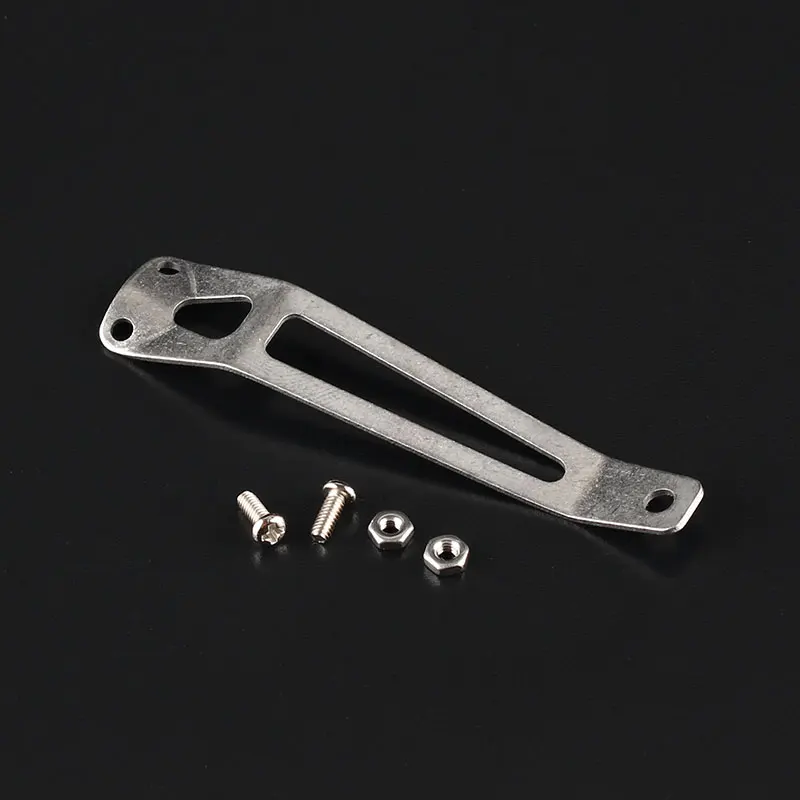

There are two holes on the tail cap for lanyard attachment, or if you prefer for the screw on Convoy pocket clip (something I wish was supplied with the light).

Not being supplied with a pocket clip means there is no anti roll device as standard, although you can purchase a sturdy pocket clip separately that would solve this. I have the clips on order as I type this, as I’m not a fan of a torch this size floating about in my jeans pocket and prefer to clip it to the inside of my pocket.
If you prefer to carry the light in a coat pocket, this is a non-issue.
