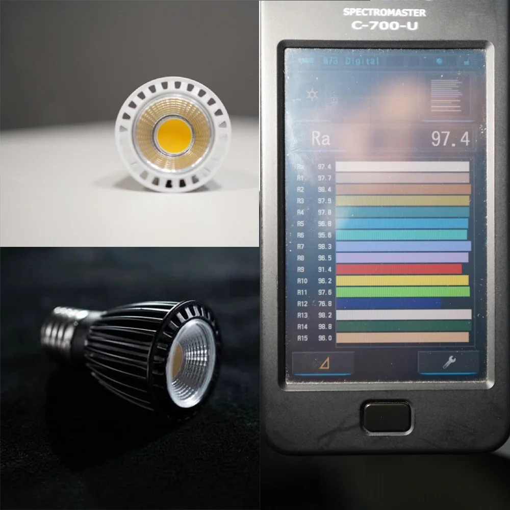

Overall finish and build quality seems good. The aluminum heatsink is painted white and it doesn’t take much to scratch it off. I don’t like that you can hear the AC-DC converter rattling around in the base when the light is shaken though.
The spotlight compared to a 60W incandescent.
The bulb has a plastic lens protecting the COB LED and reflector. Wide and even spot is achieved with a textured reflector. There very little visible tint shift in the beam. Only very faint artifacts can be seen on a white wall at the edge of the beam.

Color rendering is very good on both bulbs reaching CRI Ra of 98 and R9 of 92-93. TM-30-18 fidelity index Rf of 94-95 and gamut index Rg of 99-100 are also excellent. Typical LED technology is evident from the blue hump at 450nm and cyan dip at 480nm, but the latter is very mild. Visually the light is very pleasing with rich colors and neutral tint.
