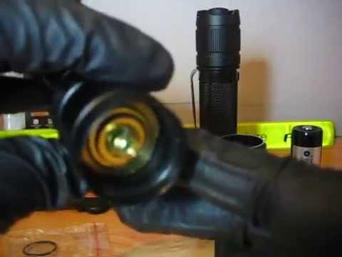

The flashlight is split into 2 parts, near the Tail seems to have another section that would give us access to the rear spring, but it has been impossible to open (maybe glued). The knurling in the center section offers a medium-high grip, finish has no imperfections.
The material and design of the side switch fenix, allows us easy use with fine, medium thickness gloves.
The design improvements, now is the best heat dissipation and acquire anti-roll feature. Square threads are perfectly anodized (a quarter turn and have already locked). There are springs at both poles, allowing the use of protected batteries quality.
