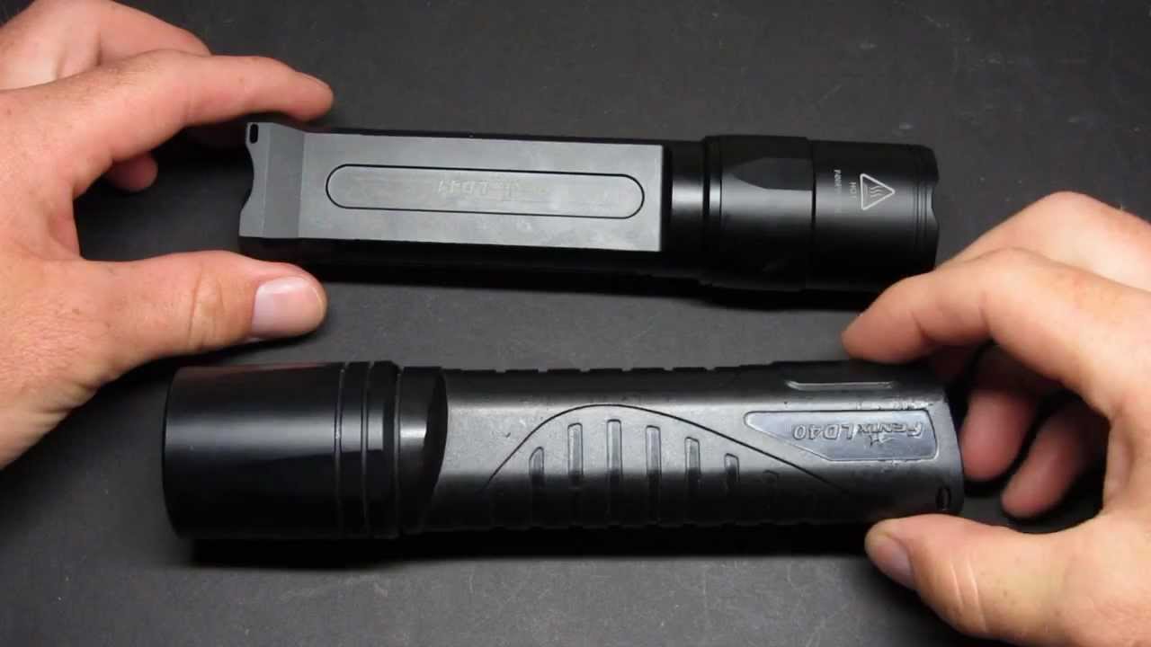

The E40 arrived in the normal padded envelope. Inside the envelope was the flashlight in retail packaging.
Included in the packaging was a nice lanyard, replacement tailcap boot, an extra O-ring, and the E40 manual.
You'll notice a superb finish throughout the flashlight. I could find no faults even during my fine-tooth-comb inspection. No sharp edges. No machining marks, scratches, chips or defects under the anno. Really well done.
The only thing I could pick out was perhaps a slightly shinier finish to the polymer battery tube compared to the finish on the aluminum head.
Very impressed by these threads. I was a bit worried it might have the issues the starry light AA light has, but thankfully it does not. The square, lubed threads are perfectly molded and thread into the head better than a LOT of the aluminum threads I've handled. No issues with play or seating here. The O-ring is spot on as well.
The battery holder is very well made. Raised thicker contact areas should prove much longer lasting than the budget version (like the SRK). The batteries are lightly snapped in place. The holder has a groove on one side that makes it so the holder can only be inserted in the battery tube the correct way. The switches are integrated into the battery carrier.
