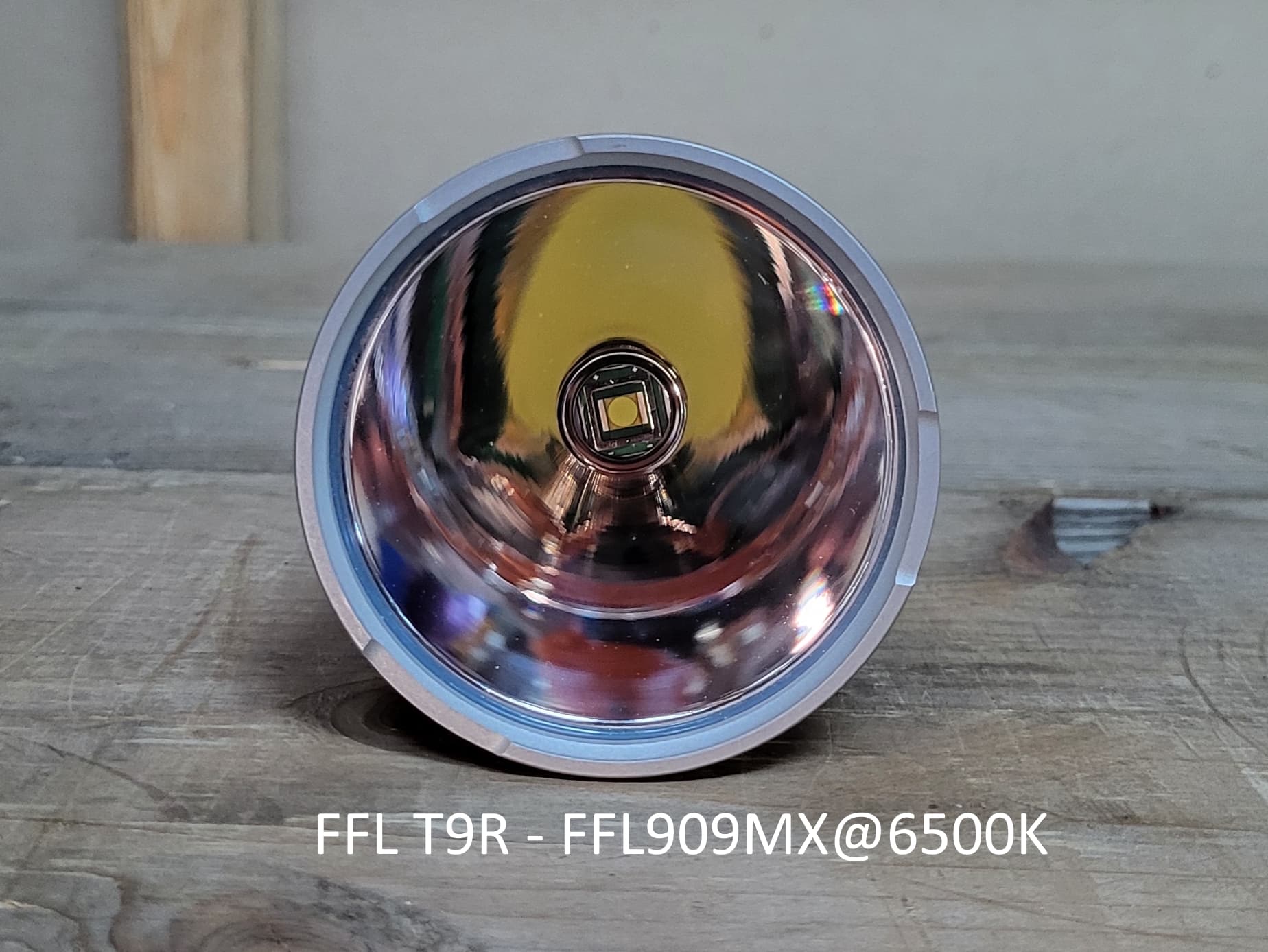

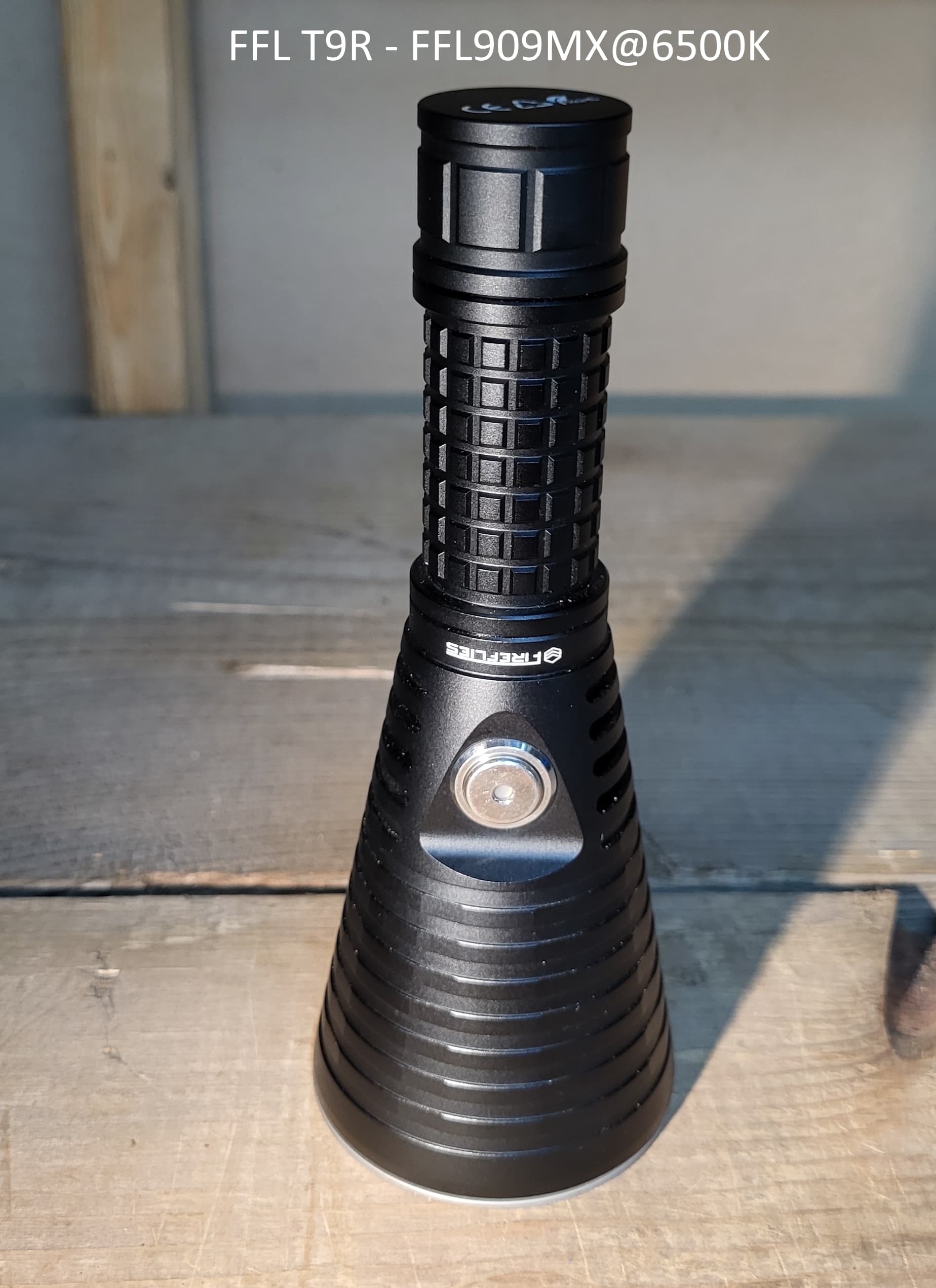

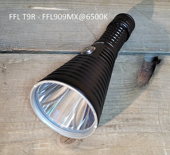

Let’s have a look at the Fireflylite T9R, featuring the FFL909MX@6500K emitter and using the Lume1 6 amps + FET driver.

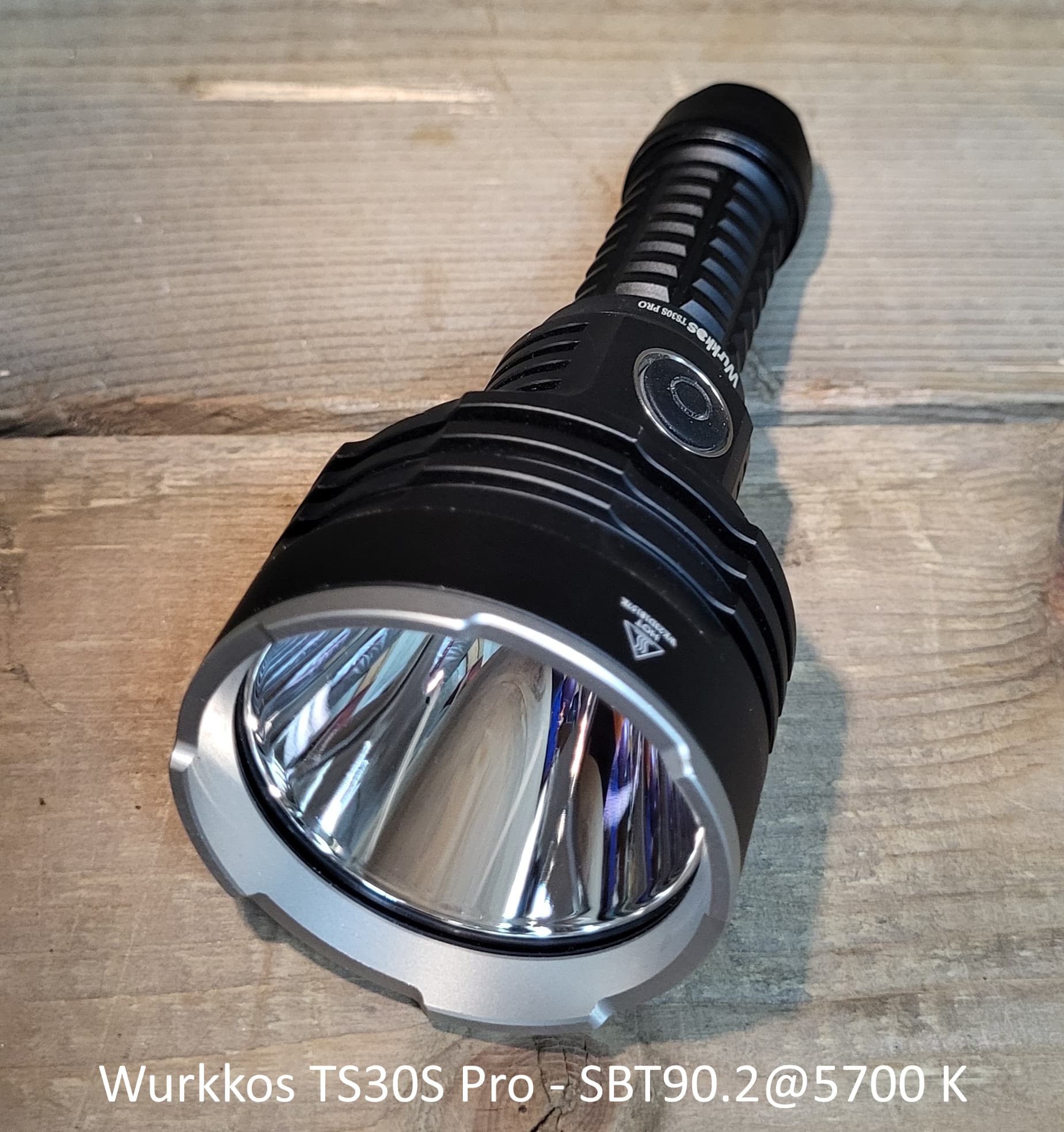

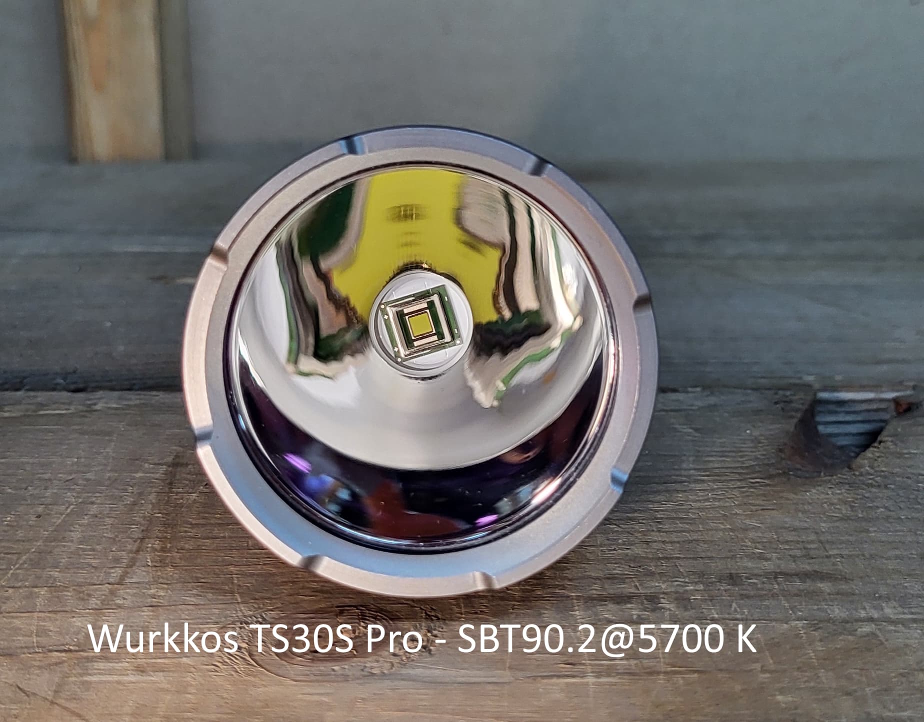

Purchased in January 2025, it is my second Fireflylite and second dedicated thrower. I will compare the light with a Wurkkos TS30S Pro (SBT90.2@5700K).

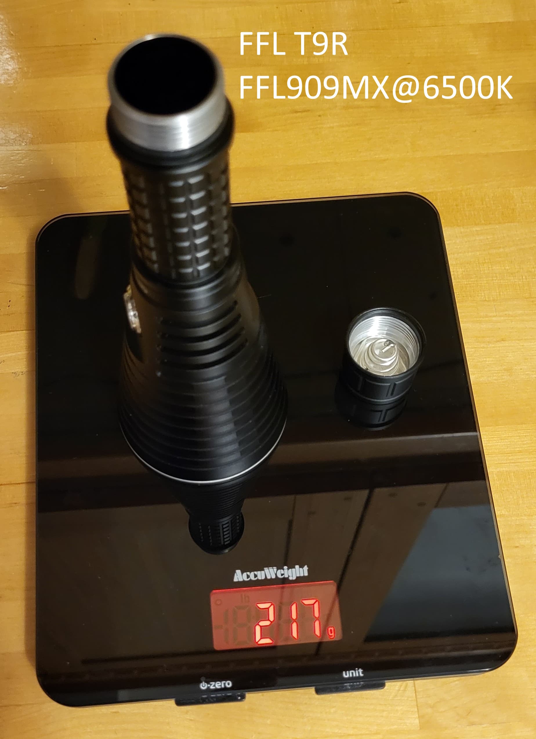

The contenders

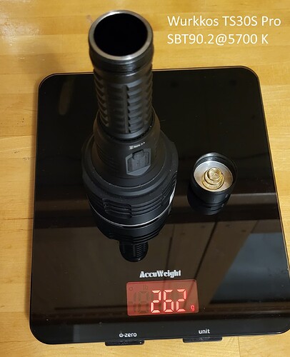

**Let’s put these two lights onto the balance before stepping on the ring. Both have an empty stomach. **

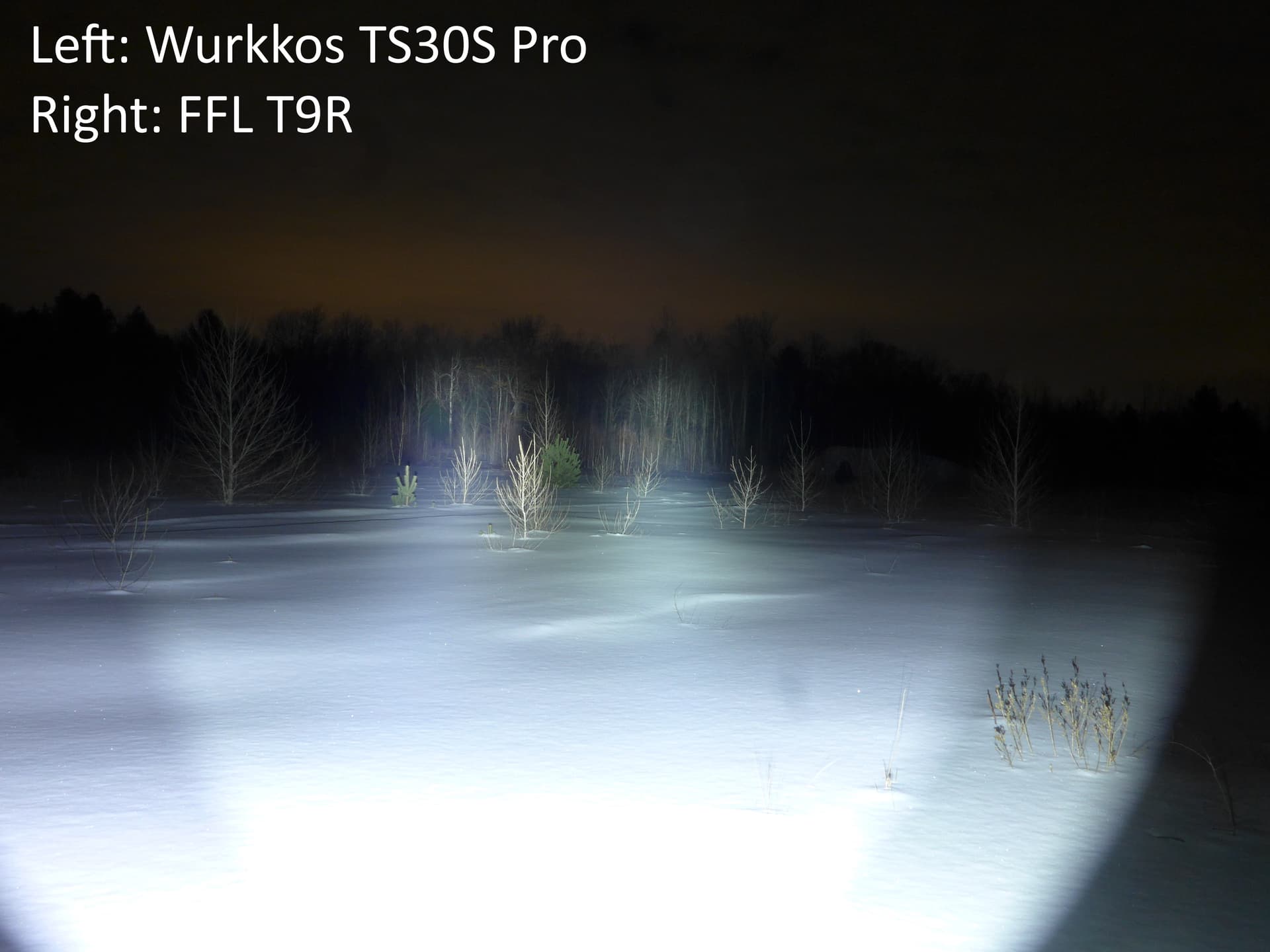

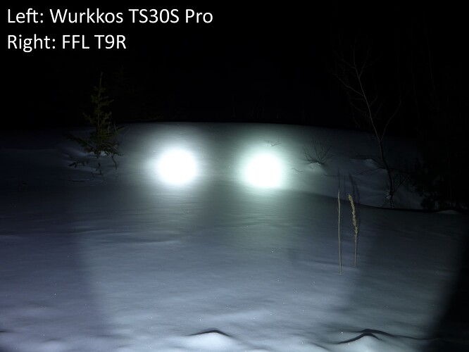

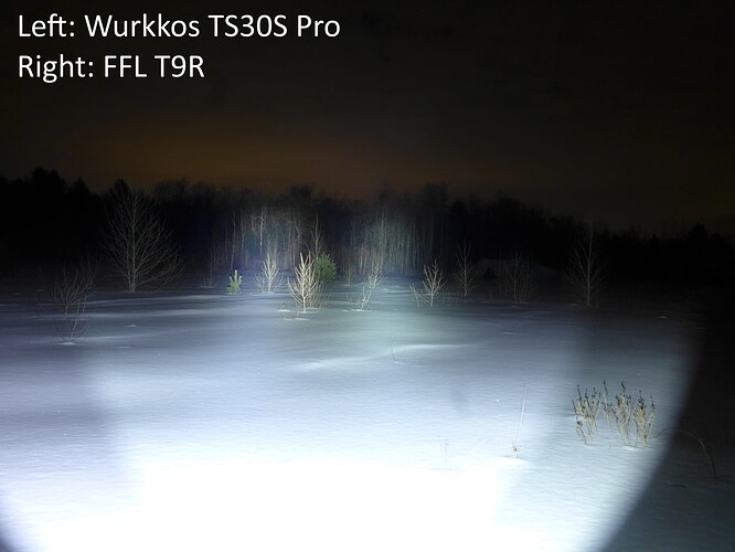

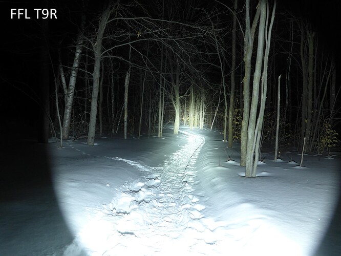

Beam shots
The line of three is ~136 meters away from me:
Other shots:

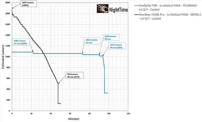

Level 150 (7/7) - cooled

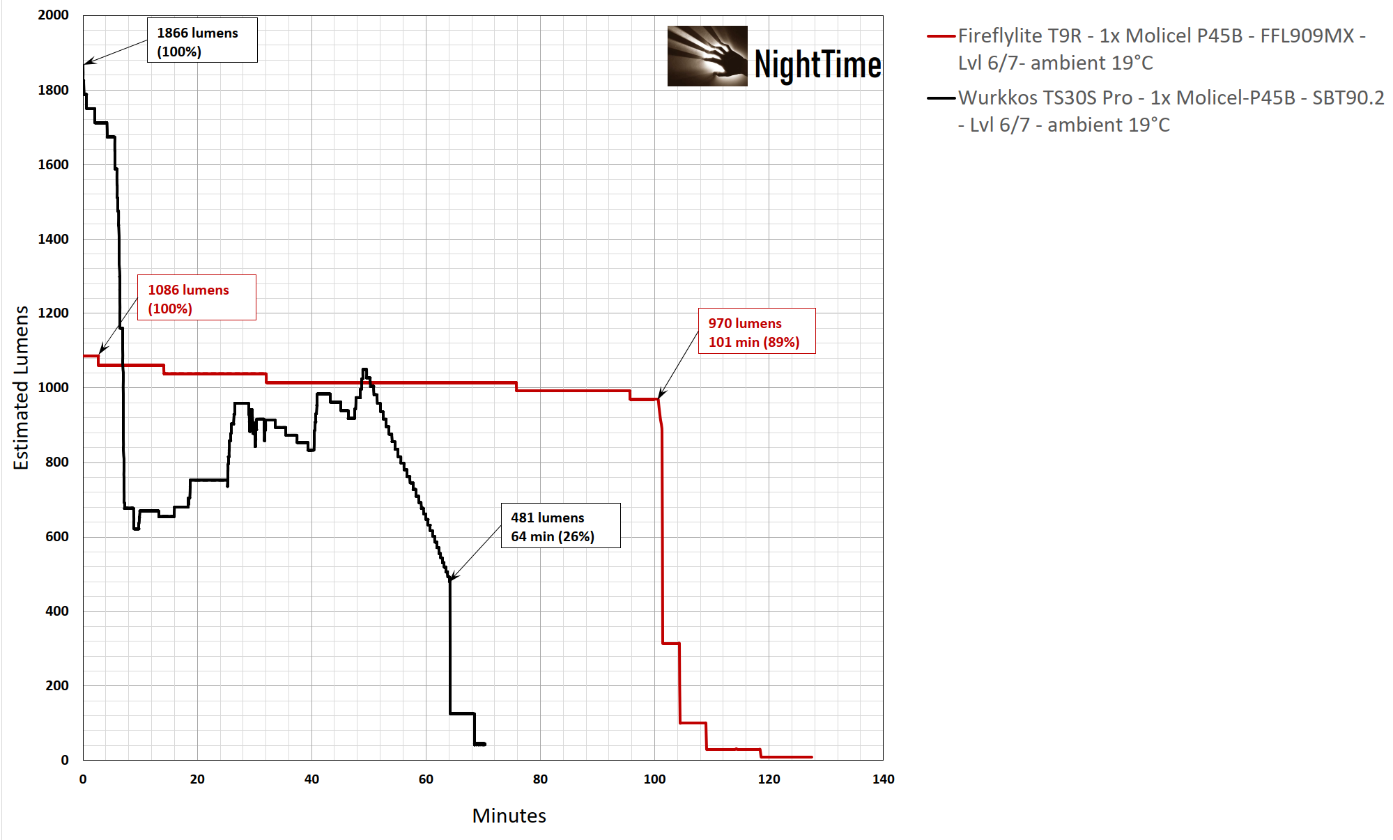

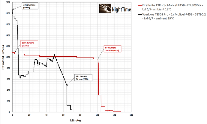

Level 150 (7/7) - ambient
Step levels are not equally spaced in these two lights so I am not sure it was a good idea to mix them the way I did below…:
Level 6/7 - cooled
Level 6/7 - ambient

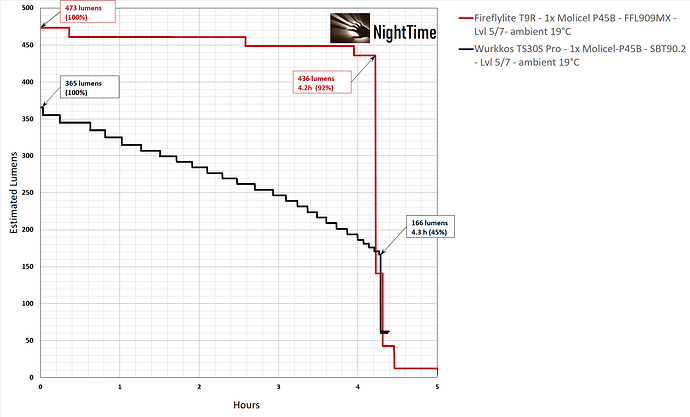

Level 5/7
The Lume1 driver really shines on this one !

Thanks for the excellent review. VERY nice Duv check showing the persistant Duv drop with increased output. The runtimes are great. Questions please regarding Level 6/7 Ambient curve: What on earth happens to Wurkkos? Lower output AND durationg almost half!? Is this advantage a result of TR9’s Lume driver?
Level 5/7 doesn’t look too pretty for Wurkkos either. Worse driver or worse heat dissipation?

The T9R on sale was a real upgrade compared to the TS30S Pro. At least for the driver ! The level 5/7 says it all. Looking at this graph, I had similar results. He used the provided 5000 mAh cell and I used a 4500 mAh Molicel. I’m a bit disappointed by P45B performances. I now use my P50B cells anyways.
I’ve read nothing but praises on the lume driver - super nice to see such clear evidence. Again, thanks for the great runtime comparison. Still love my two Wurkkos TS30 though LOL.

Your runtime test on level 5 really shows how great the Lume1 efficiency and regulation is.

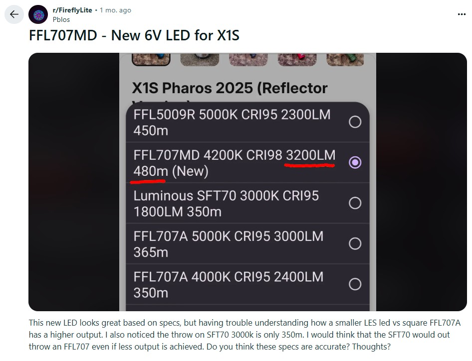

I posted question on reddit HERE. My take (YMMV) is output and throw both lower than what was posted as possible specs. The 6v version does appear to have high CRI and negative Duv, but not low enough to receive FFL’s “ROSY” designation, which implies very negative Duv and very rosy tint.
Output seems to be around 2000 lm. 6v FFL707MD version on Convoy M21D by user Punga32 has 127 Kcd/~700m at turn on (non ANSI).
Contrast this with my Firefly X1L with FFL707A: 2500lm output, 470m ANSI throw, CRI 97, Duv -0.0090 :scream:. So 707MD is ok and you could special order it on E90, but to me not worth the asking price and reflector (which I prefer) is not possible. For me, SBT90.2 still the one to beat at this point.
