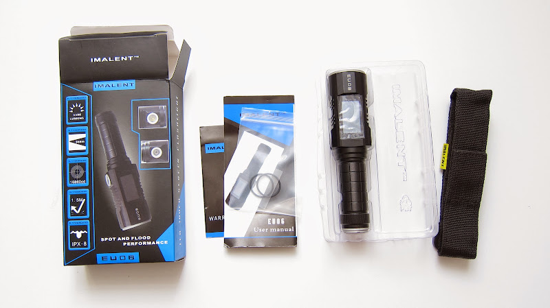

Contents include one manual, warranty card, two spare o-rings, one screen protector, sheath and flashlight:
Front and back of box:

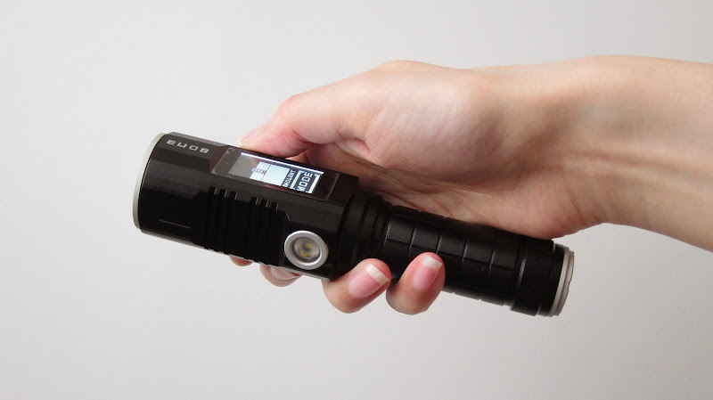

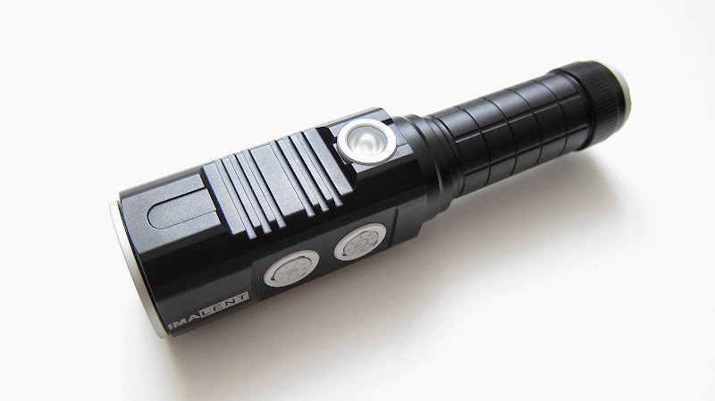

This light, whilst looking a little unique with its squared head and tube body, fits beautifully in the hand and is actually more comfortable than some circular-tube lights I own (C8 for example).
C8 size comparison:

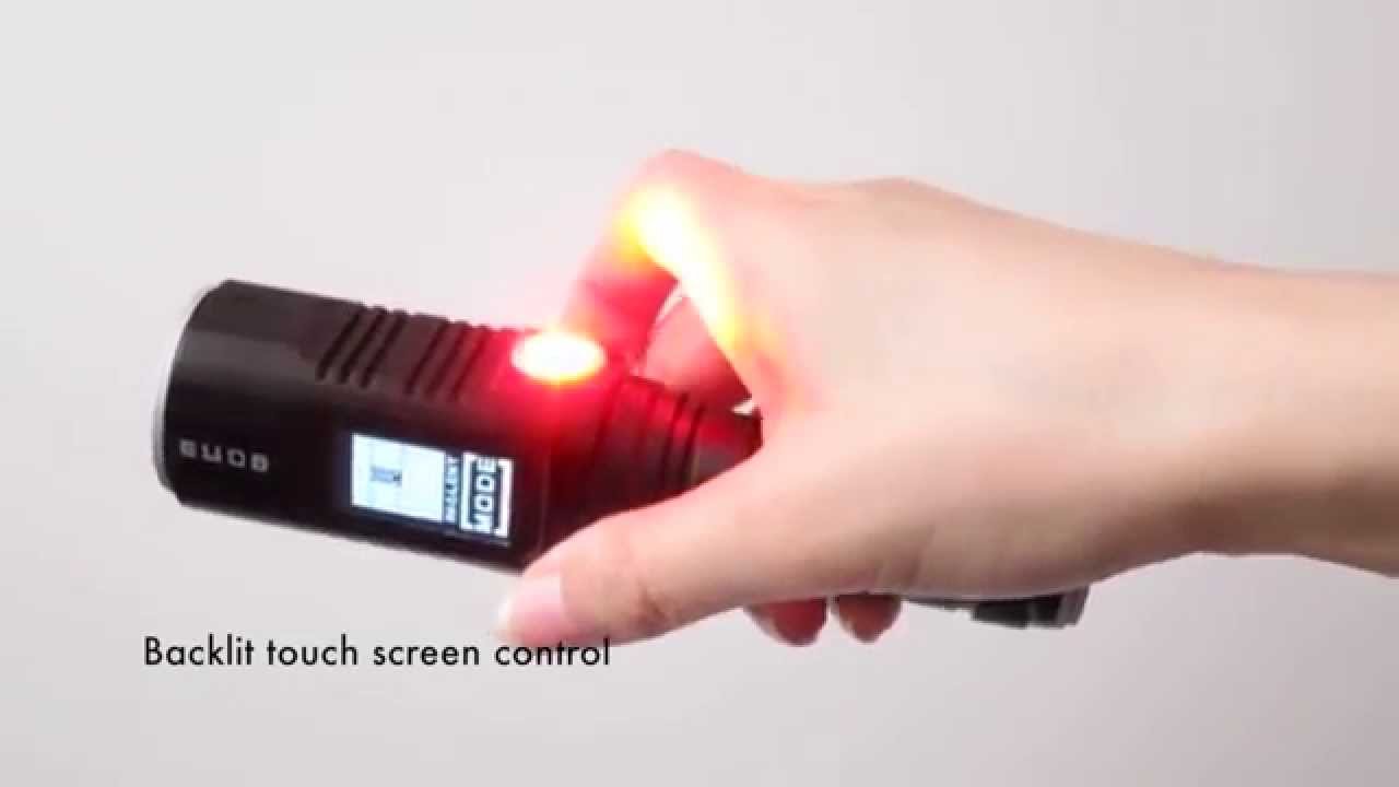

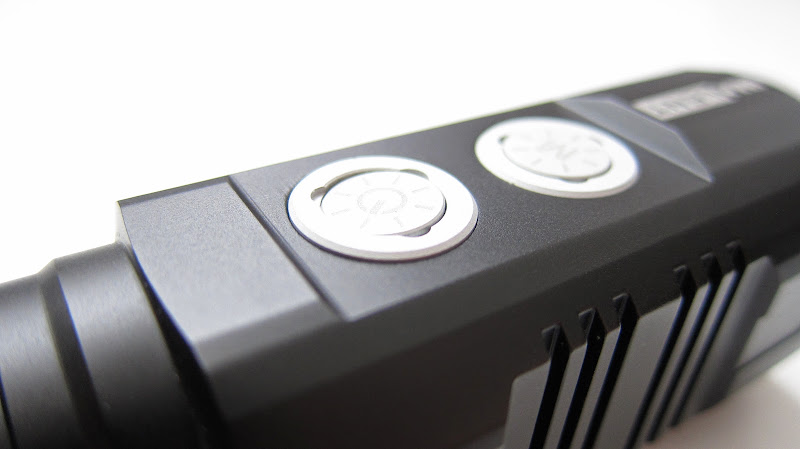

With my thumb resting on touch screen, the two switches are placed naturally for first and middle finger (Mode and Power respectively) and provide click feedback.

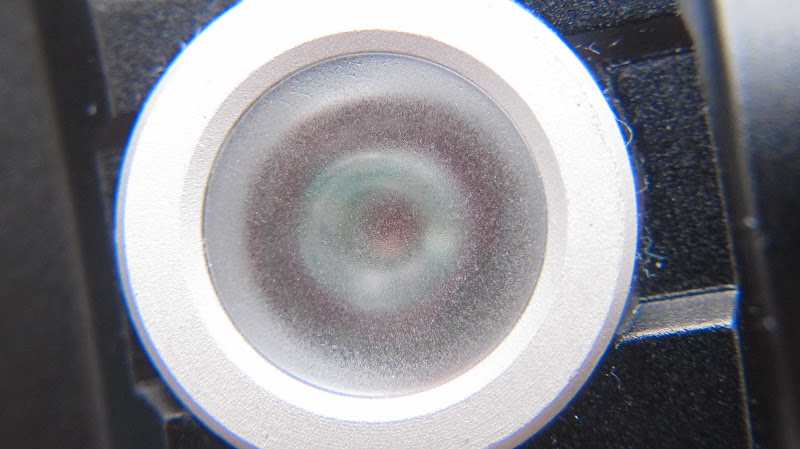

XP-G2 warm white and red XP-E emitters are mounted on opposite sides and have same frosted lens, accompanied by array of heat sink fins.
Buttons and warm white flood light lens:
Screen and red flood light lens:
EU06 red XP-E light reminds me of Terminator or Hal, for some reason.
On my sample, the power button is flush with its bezel whilst the mode button a little proud of the bezel so the two can be distinguished by touch. I do not know if this is intended but I like it.
One of the first things that struck me about the light is the matte grey-white aluiminium of the bezel. Whilst it's not stainless steel, and doesn't offer the same impact resistance, it's nice to have something a bit different.
In keeping with the rest of the light styling, the buttons have their own anodized aluminium bezels. The button tops are aluminum too, with laser etched symbols:

Occasionally the depressed power button gets stuck on the bezel, which is a little annoying:

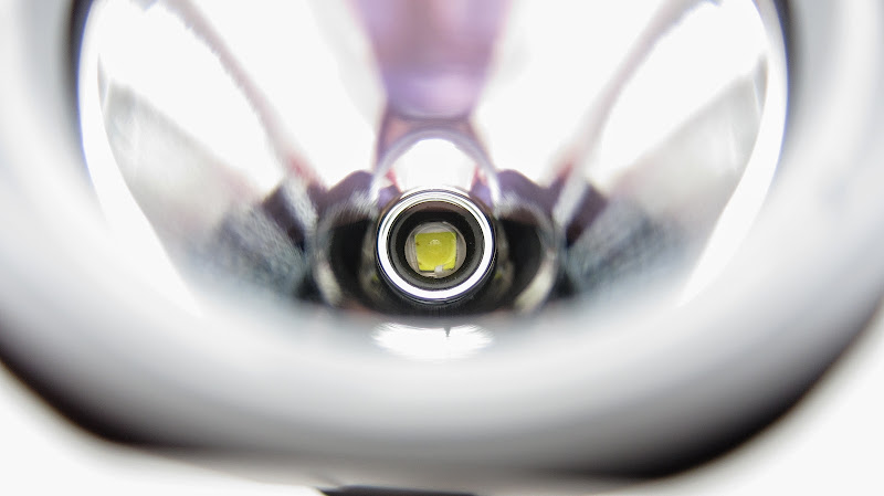

LED centering is slightly off:
A small amount of thermal paste visible on emitter dome (bottom centre):

Operation is pretty straightforward for the most part. As with the SA04, the EU06 offers 17 levels of adjustment, and four stage battery level. The cell icon will flash empty with a cell measuring 2.9V.
Also included are two strobes (rapid and a slow 0.5Hz beacon) and an SOS, accessed by holding the Mode button whilst the light is on. Hold-pressing the Mode button whilst either side-LED are active will switch the light to main XM-L2, in fast strobe.
Soft lockout is possible by holding both buttons for 0.5 seconds (light flashes momentarily before turning off), and disabled again by the same two-button press.
Backlit screen is visible in daylight:
With flood lights on lowest setting, light from the screen is quite noticeable, so it is nice that it can be turned off easily (press Mode button briefly to toggle).
To select which emitter one presses the touch screen area [MODE] to cycle through XM-L2 - XP-E - XP-G2 - XM-L2 (and so on).

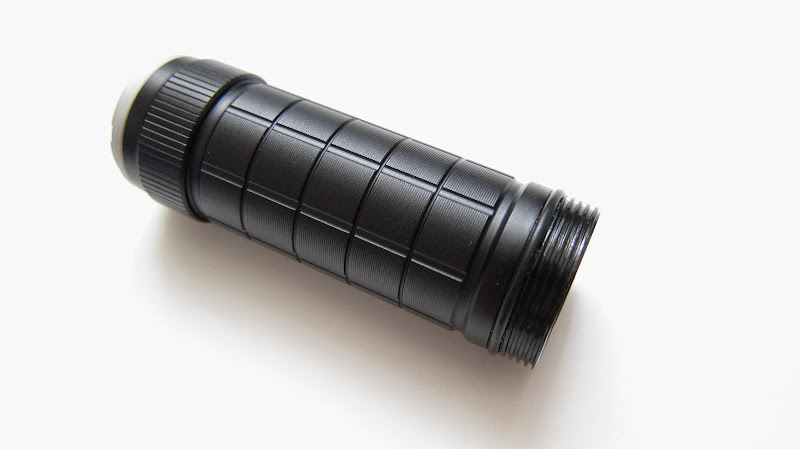

The head attaches to the body with lubed, anodized and squared threads, sealed with a single o-ring. There is no tailcap per se. Knurling near the tail could be improved. It's not difficult to grip nor slippery though.

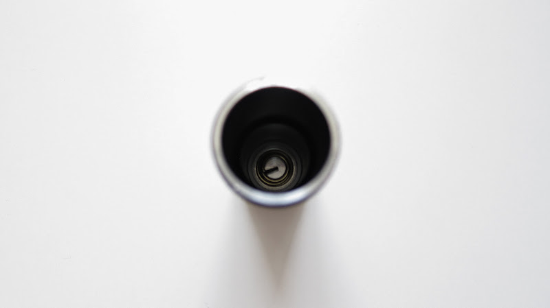

Inside the battery tube, the first 40mm or so is wider than the rest of the tube. I am not sure why this is gap exists. I did not notice any rattle using unprotected 18650 cells but RCR123/CR123 users may prefer a narrower tube.
Cell resting on step inside:

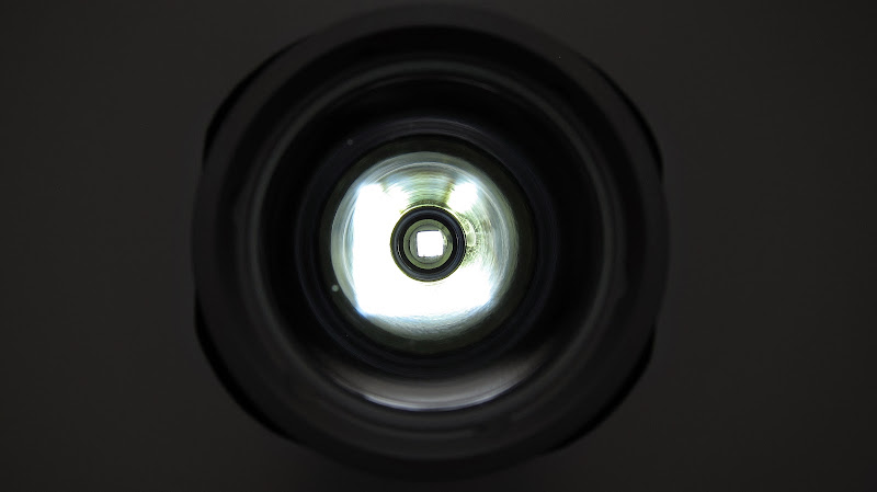

Main lens diameter is 28mm, bigger than P60.

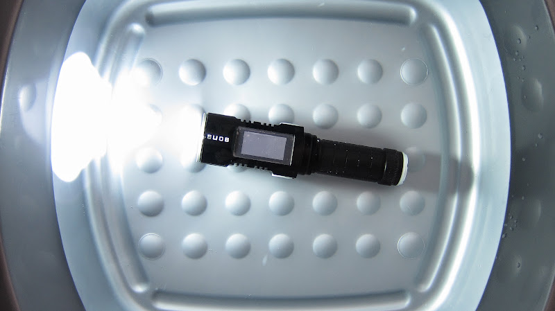

On seeing ChibiM's SA04 fail a water resistance test I had to test the EU06, and sadly it failed too, though not catastrophically (no water in battery tube). According to box and manual light should be IPX8, tested to two meters. Here it is sitting at a depth of ~6.5cm.
The first sign of ingress, I noticed output levels were changing erratically. By ten minutes I decided to check the flashlight, and sure enough there was a drop of water in both side lenses.

You can see here the changing output whilst underwater:
Erratic behaviour of touch screen thanks to a wet driver:
