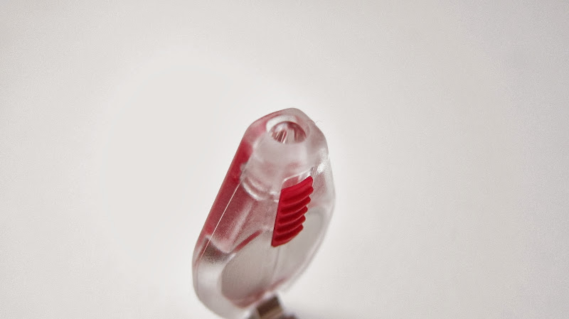

Although the red rubber forms a large part of the top, only the centre activates the light. The switchable part has grooves so you can tell by touch:

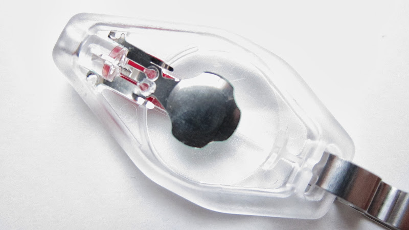

Often cheap fauxtons ship with two CR2016 cells which together is too much for a red LED and shortens the life. Here a single Panasonic 2032 cell is included. The rubber button can simply be pulled out to change the battery:
I bought this with plans to change the LED, but a closer look shows modification might not be so straightforward as the casing has been melted to secure the metal contact leaf:

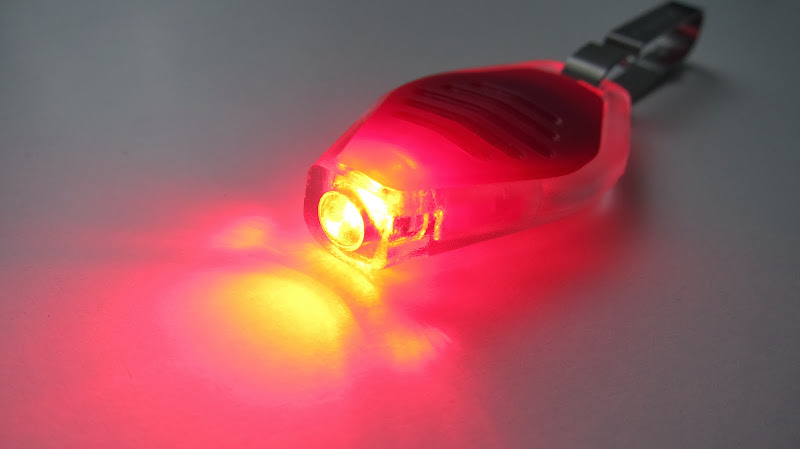

Quite a lot of the casing also lights up:

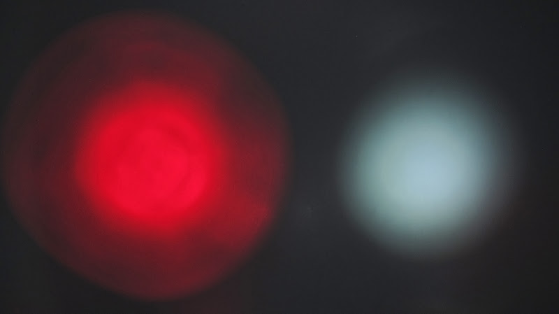

Beam shots at 50cm. Left is Inova Microlight, right is DX 20cd fauxton. The effect of the casing is clear. Although not as nice a beam, it allows for more spill from a 5mm LED:

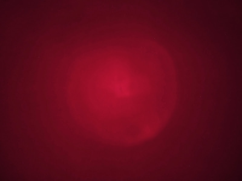

White wall beam shot at 1 metre. The beam is larger than a typical 5mm LED but not without imperfections:

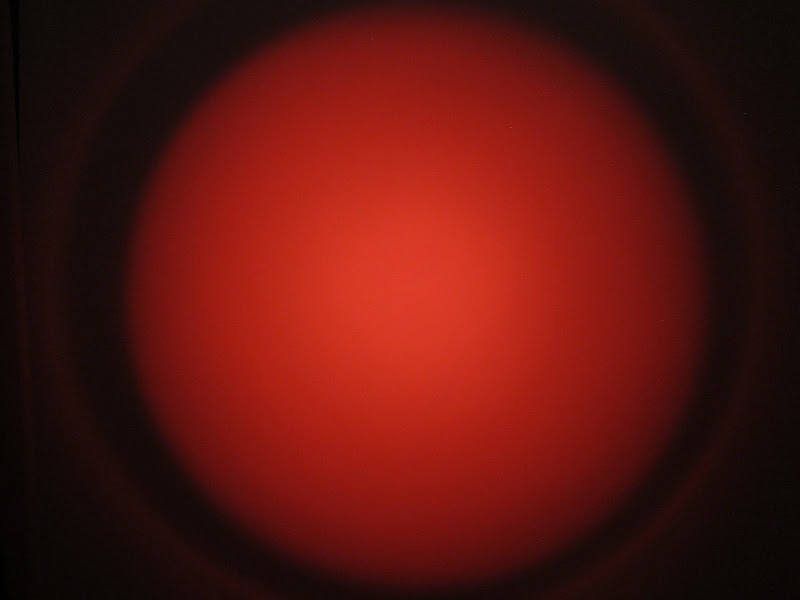

For contrast, here is a SK-68 clone (probably XR-E Q3 emitter) with red filter. The 5mm red LED is a cooler red and feels a little unnatural in use.
You can see there is more orange present in the red filtered SK-68:
