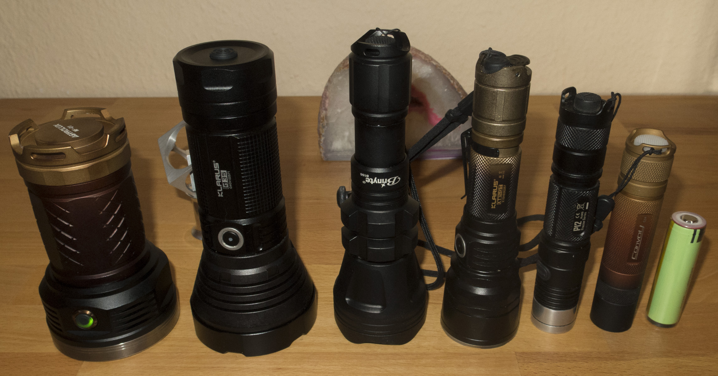

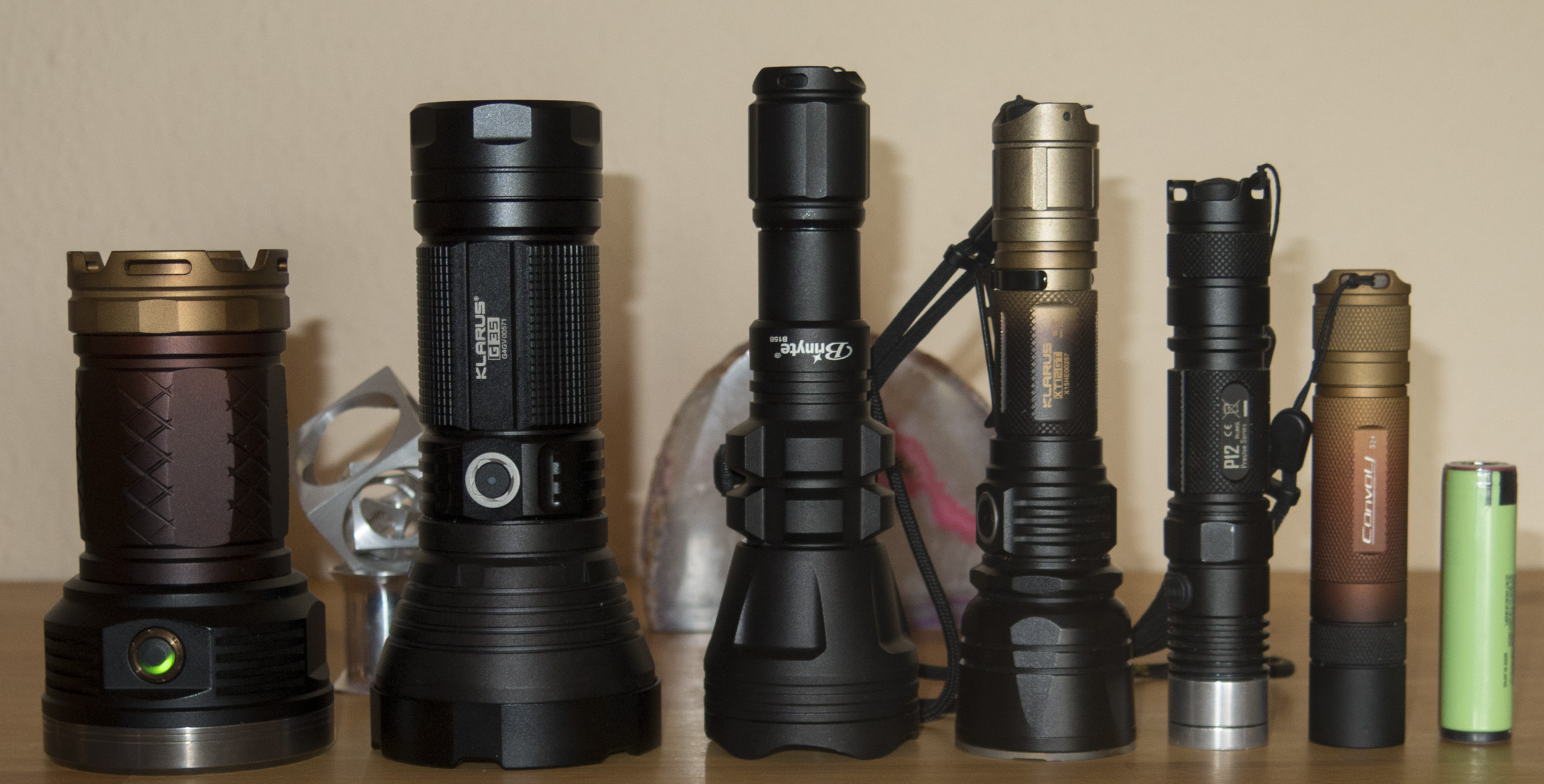

Size compared to other 18650 lights the G35 compared to my other lights the biggest but not heaviest

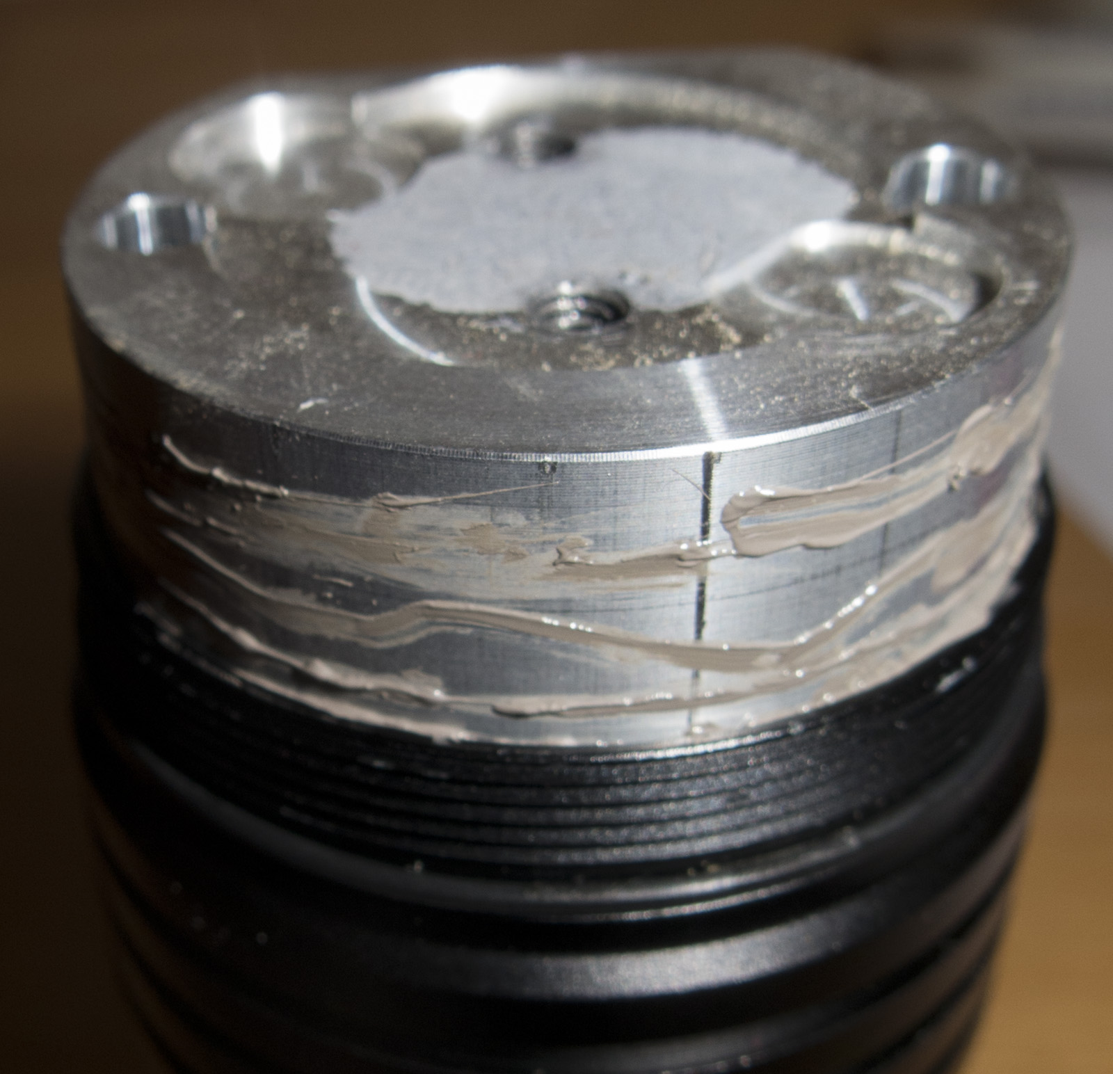

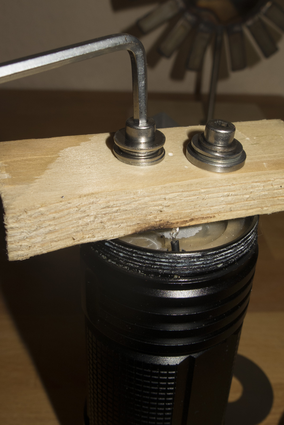

after over 2 hours I got that bitch opened up to get to the driver
first heat gun with heating the head to 140°C was not enough to get it open
even 1 hour with acetone did nothing at all, no way even massive force
I roasted the head section topping at 250-300°C with an autogenous welder with 3200°C flame to get the glue open,
I melted my microfiber towel that I used to get grip
it worked the massive heat on the head did not had time to flow to the tube and damage things like I had with my Nitecore P12
the tube heated only to about 120°C when I had the head screwed off

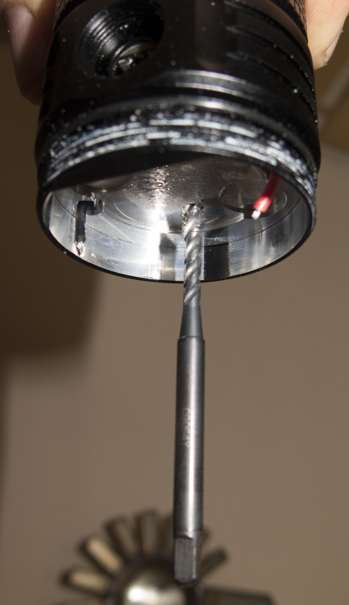

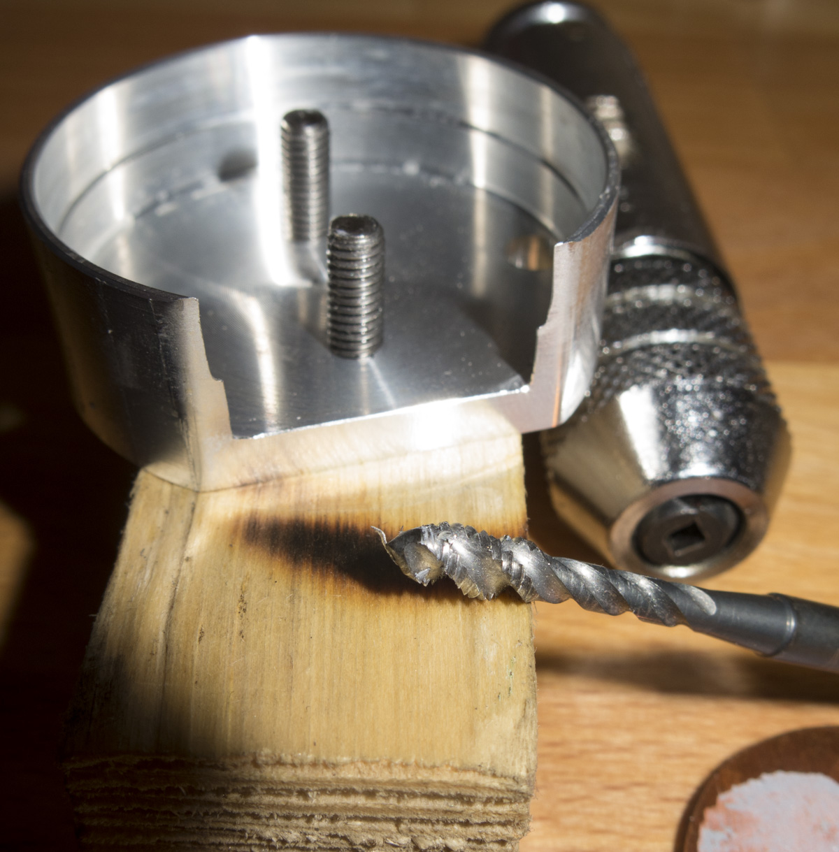

Just one image for now that shows the process after removing the head,
also a bitch to get open, but if you own M4 thread cutters its doable

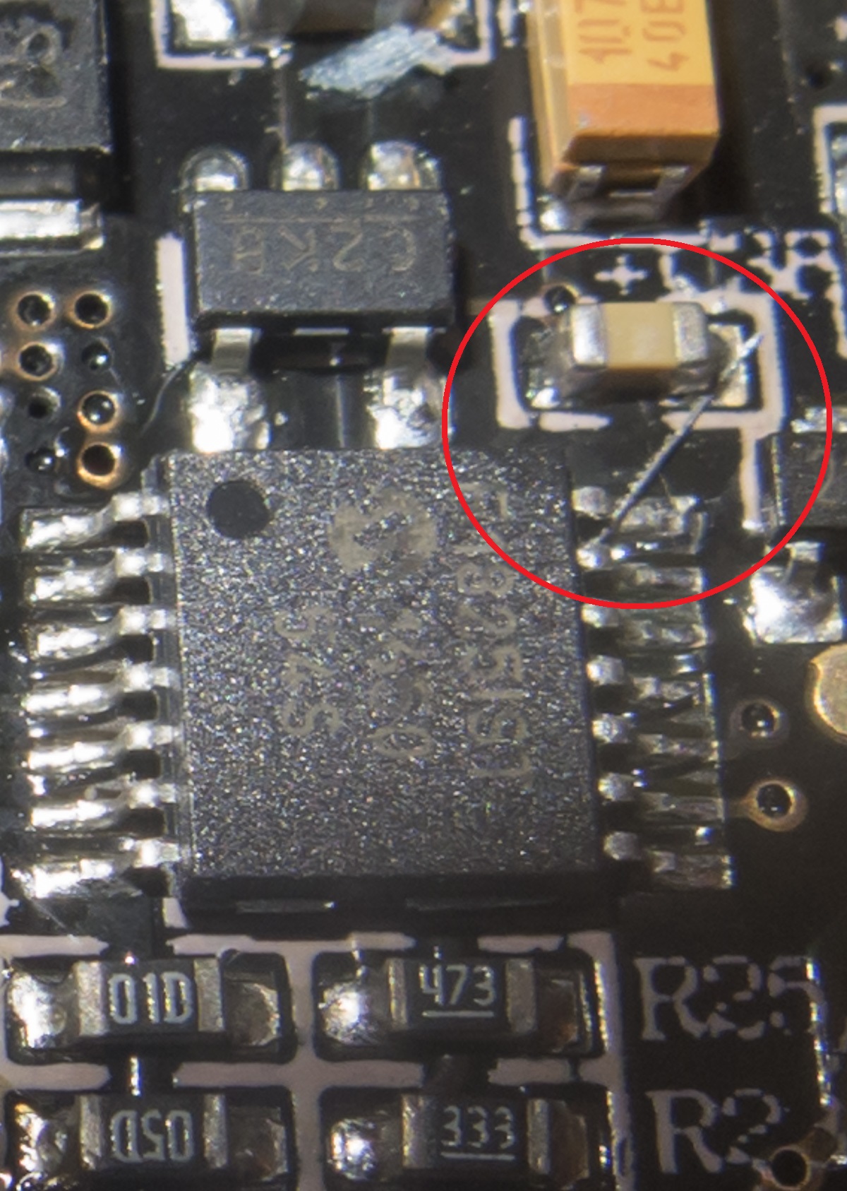

Unfortunately I killed the driver somewhere in getting to it, I dont think heat, maybe a tiny metal chip from cutting the threads even if I checked the driver and blew it off very carefully
After looking at my pictures I think this killed the driver

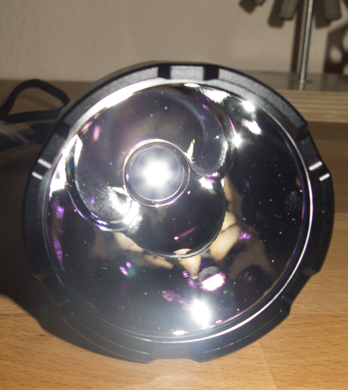

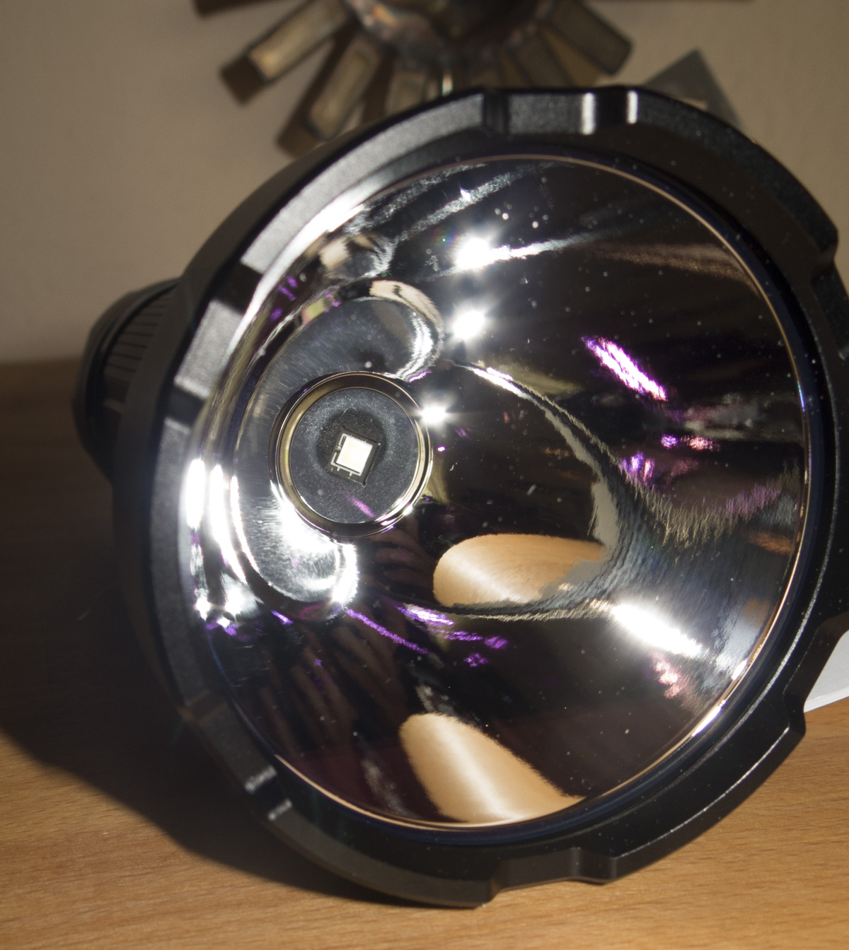

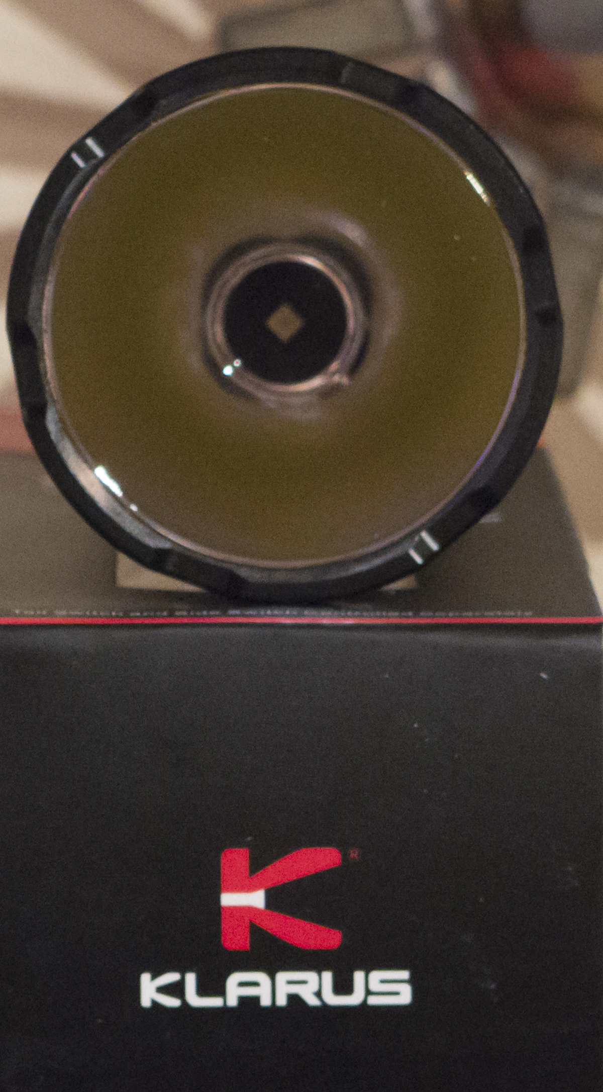

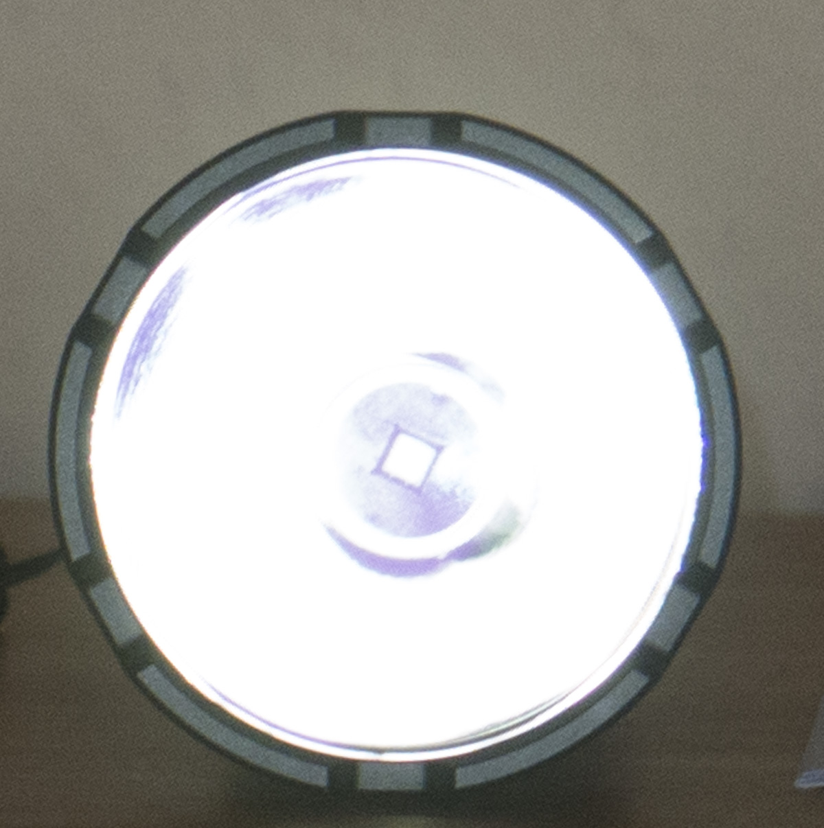

Beam color is cold around 6500K with a Cree XHP35 D4, the beam has a very very focused hotspot with some spill
the beam pattern has no rings or artifacts

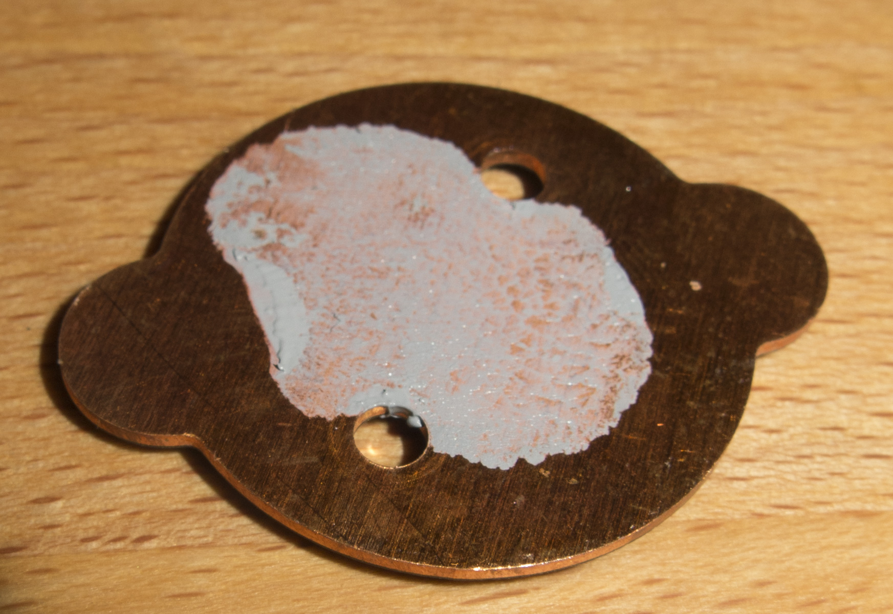

The LED is very good reflowed and the MCPCB is perfectly flat, but not polished or gold plated
The heat paste is applied in a good amount and squeezed in an uniform thin layer
The reflector has some tiny imperfections and is free of dust particles that can be seen when the light is off

The light is heavily glued with blue locktite and the LED shelf is pressed in the tube, it is very hard to get to the driver

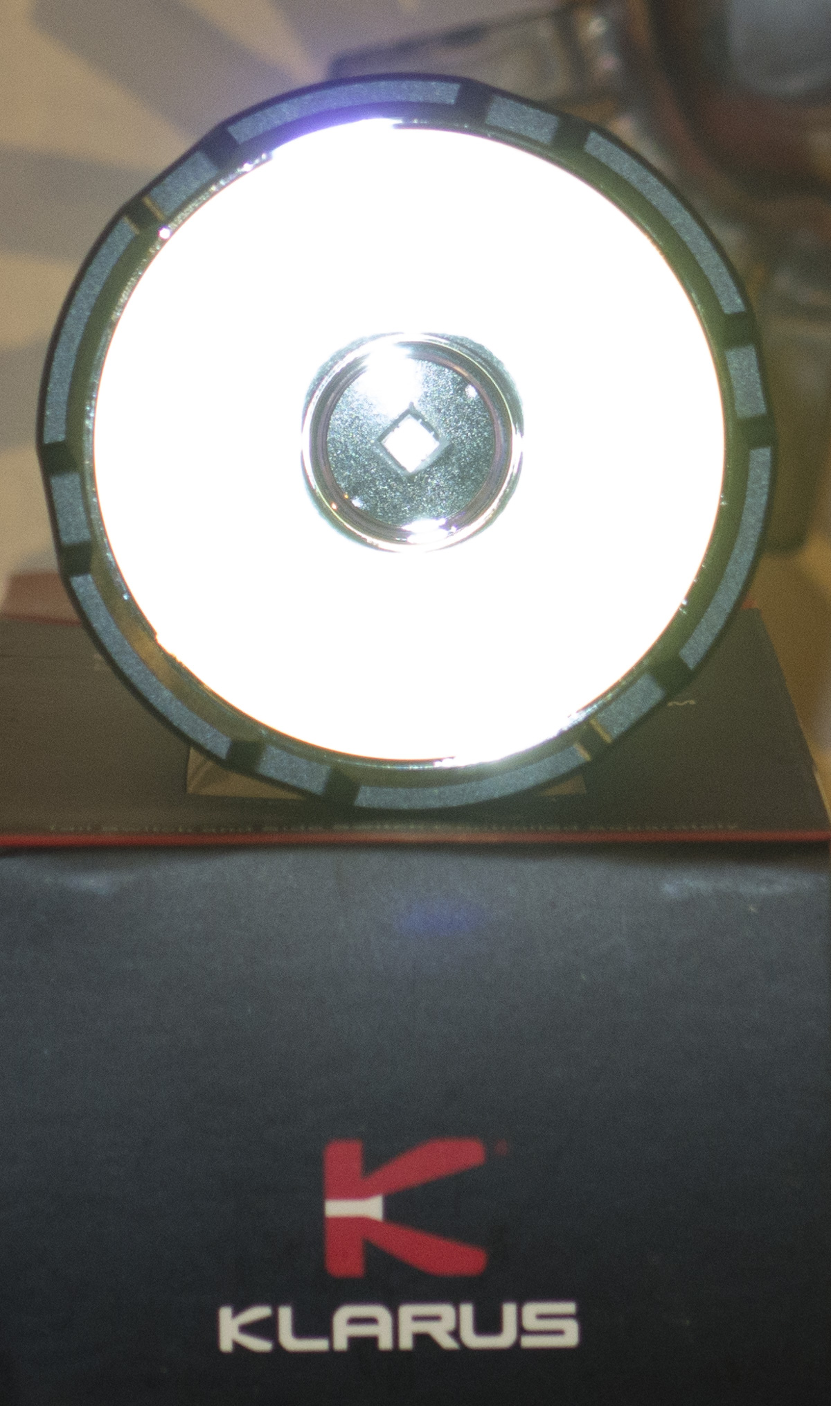

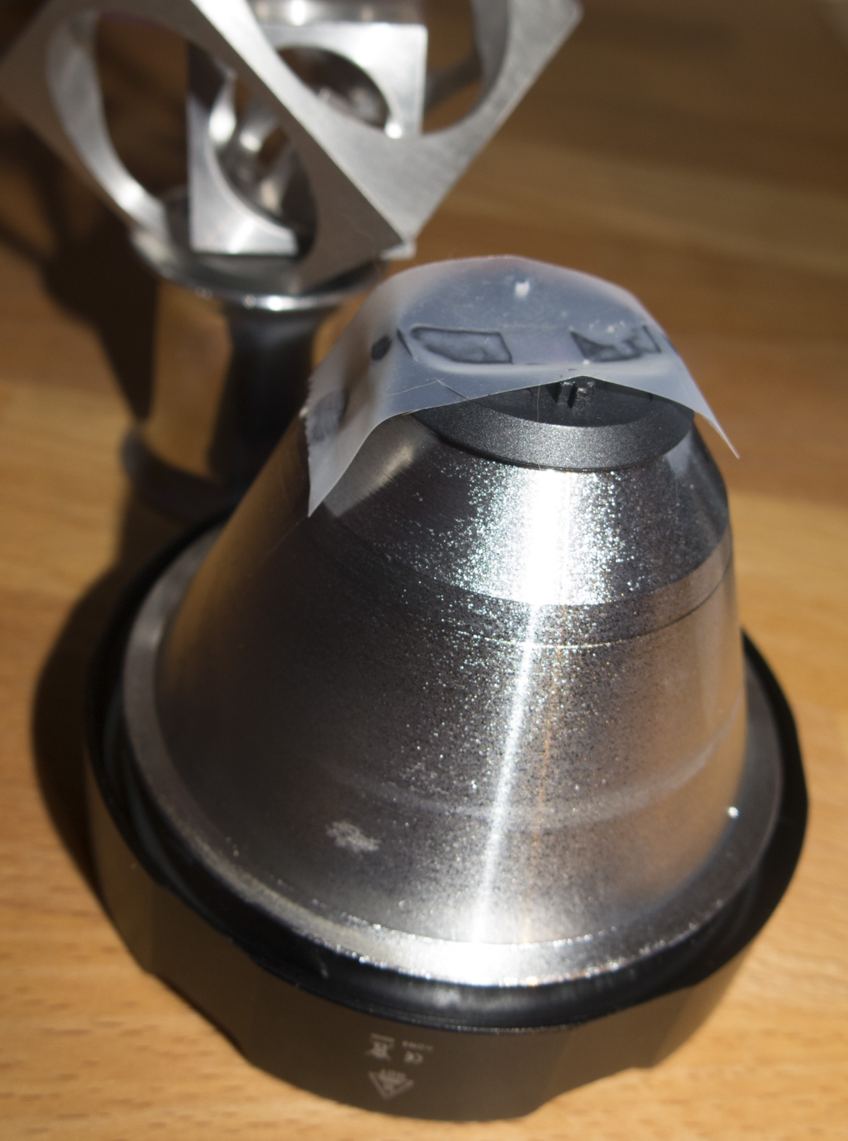

The lens is really big and thick, and coated
The head has a diameter of 77mm and 60mm visible reflector

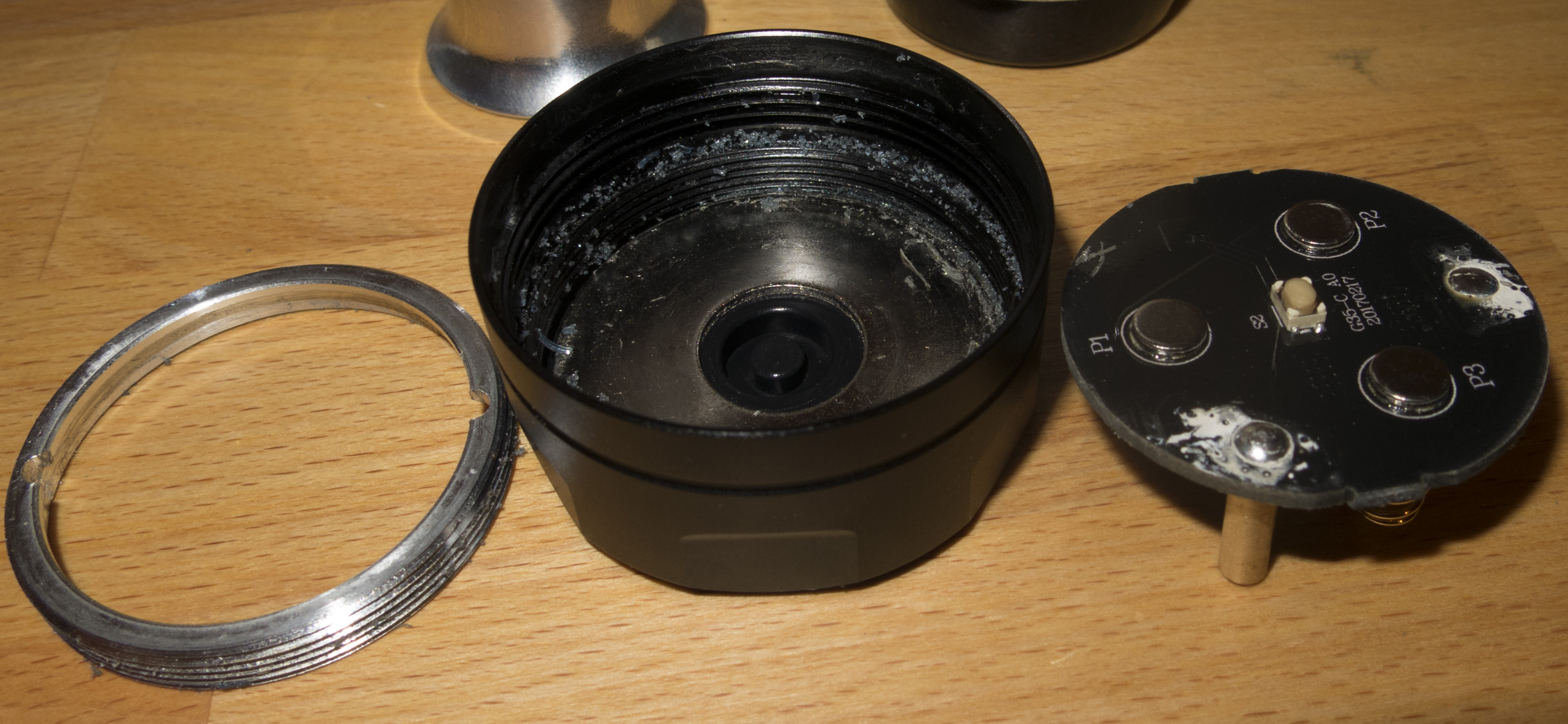

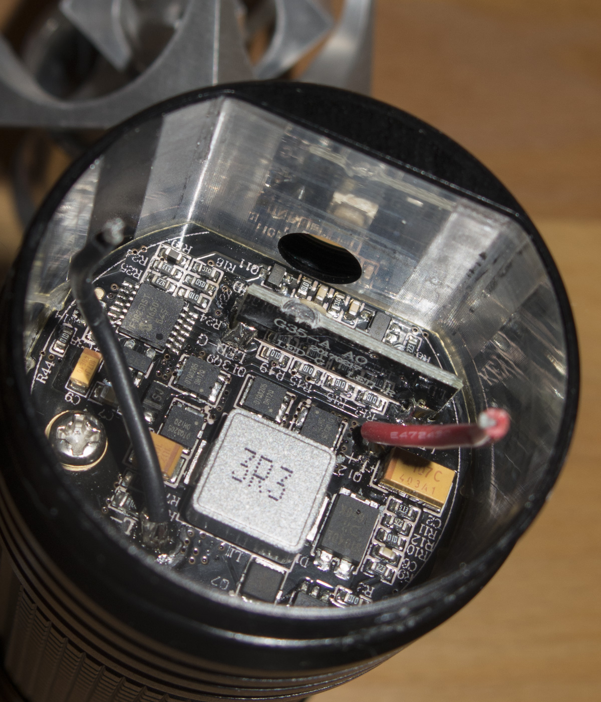

The driver is the hardest thing to get to, first the head is heavily glued to the tube
And the LED shelf is press fit inside the tube

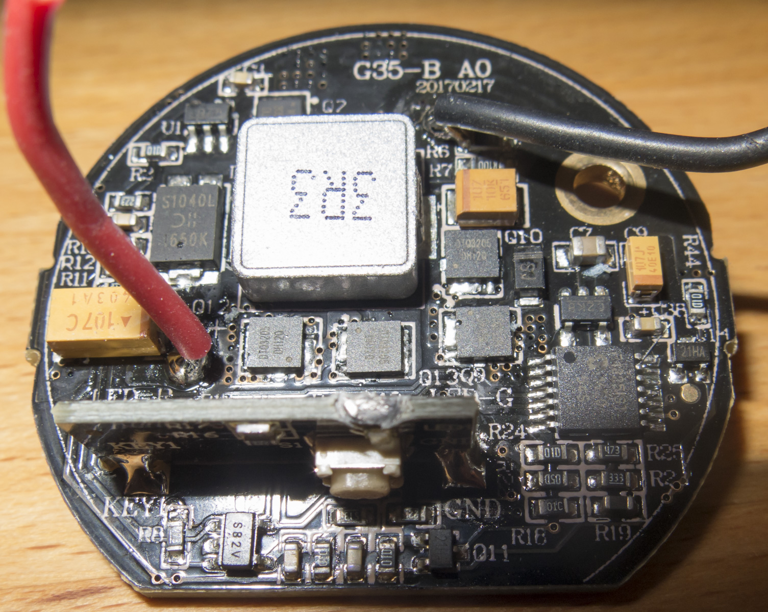

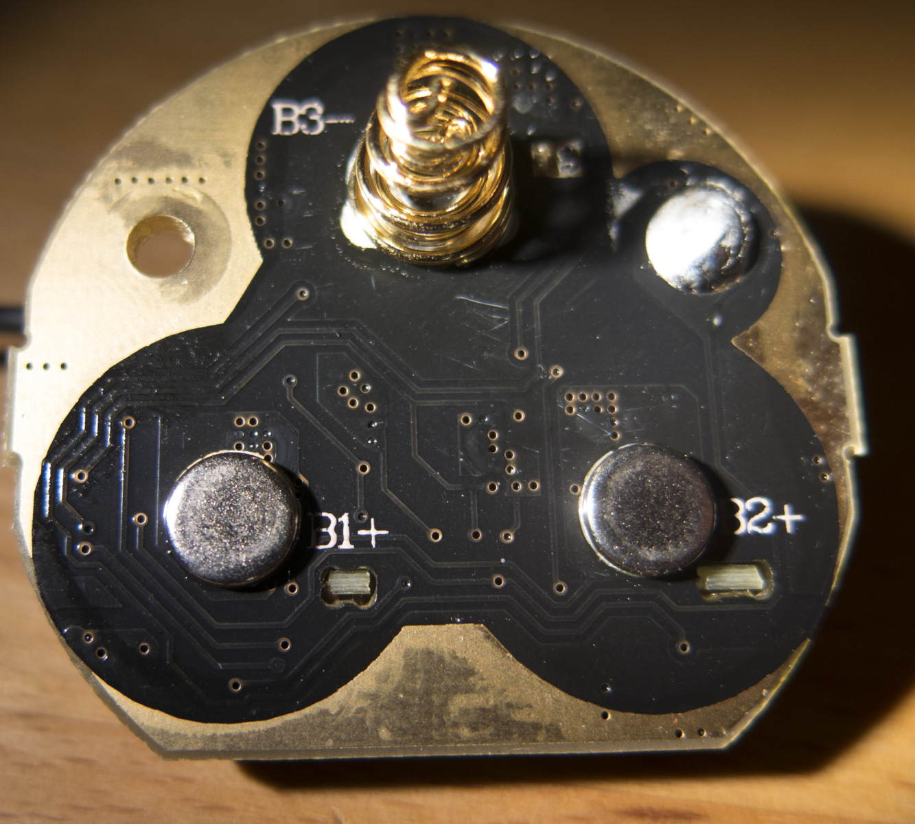

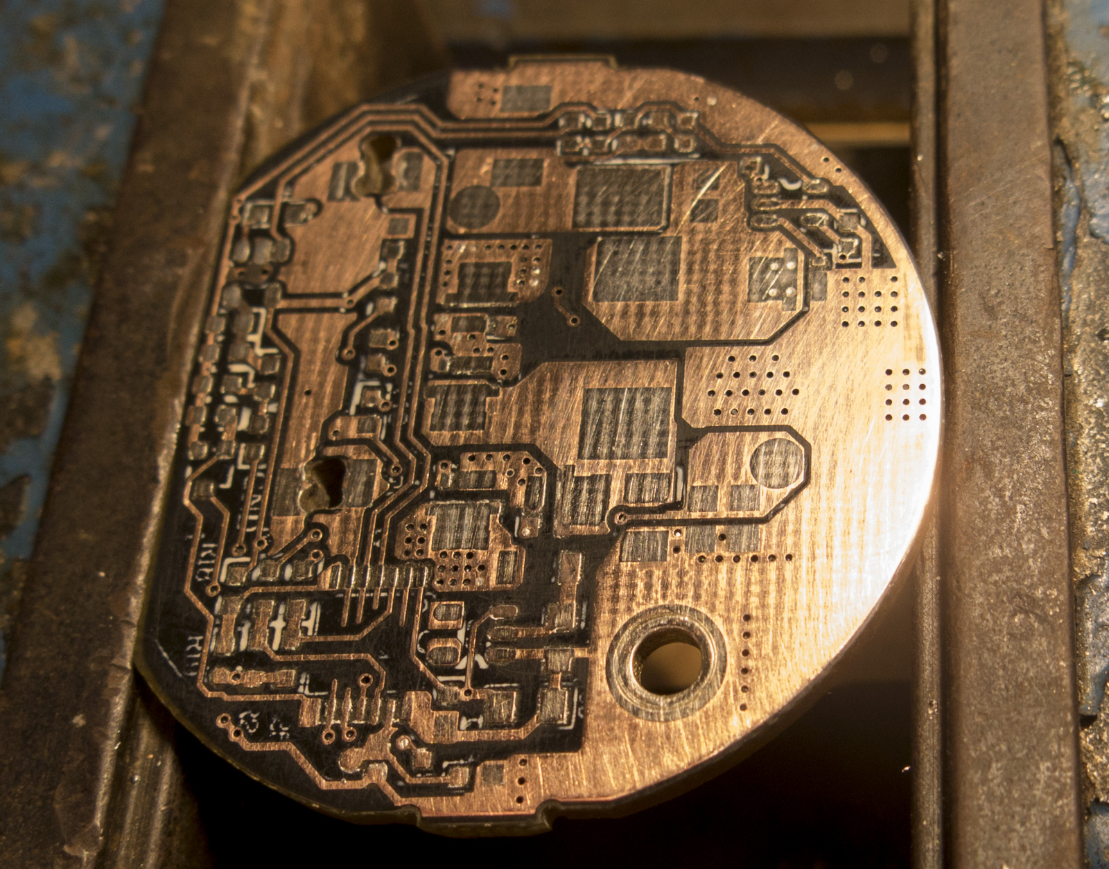

The driver has total of 5 FETs with a single coil on the driver, likely to run from the different battery channels
I can’t test if the light can be locked out with the tail cap
The Head
The big reflector with a single LED gives a lot of throw with a pretty small hotspot
The slave board for the switch has a green and red LED

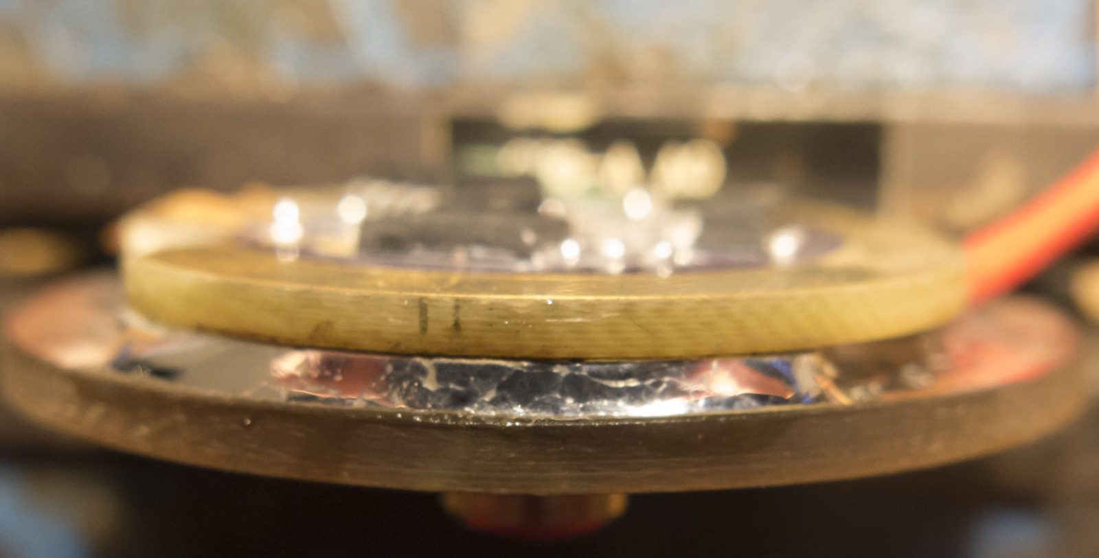

The shelf is 3mm thick and the really big 1mm thick copper MCPCB does a good job spreading the heat, can’t say how the light gets hot as I killed the driver
The MCPCB is s true copper DTP, the back of it is bare copper
The MCPCBs back is perfectly flat
The light is waterproof, the tail cap and bezel threads are lubed, but the amount is a pretty low
The lens is hardened AR coated glass

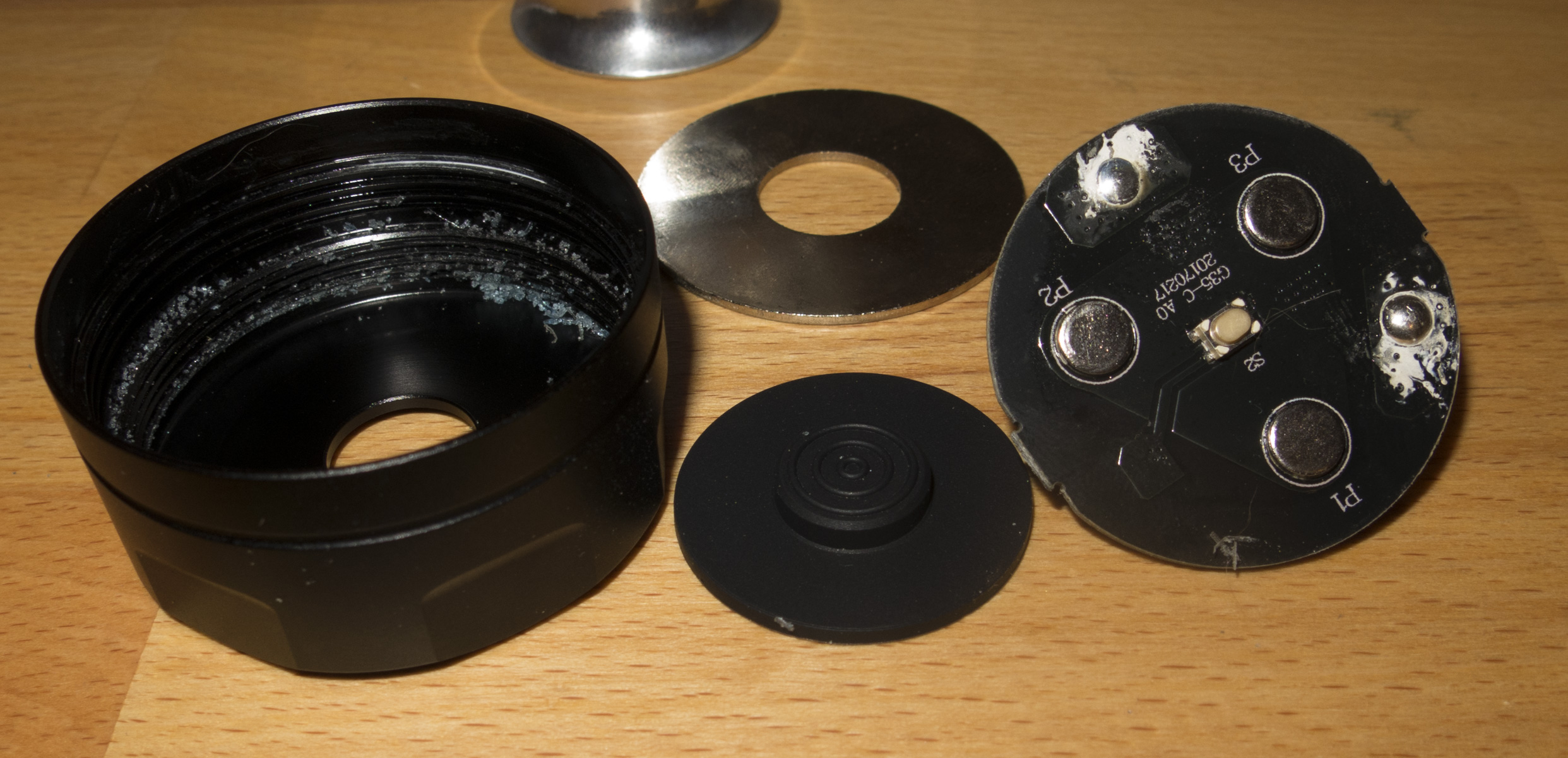

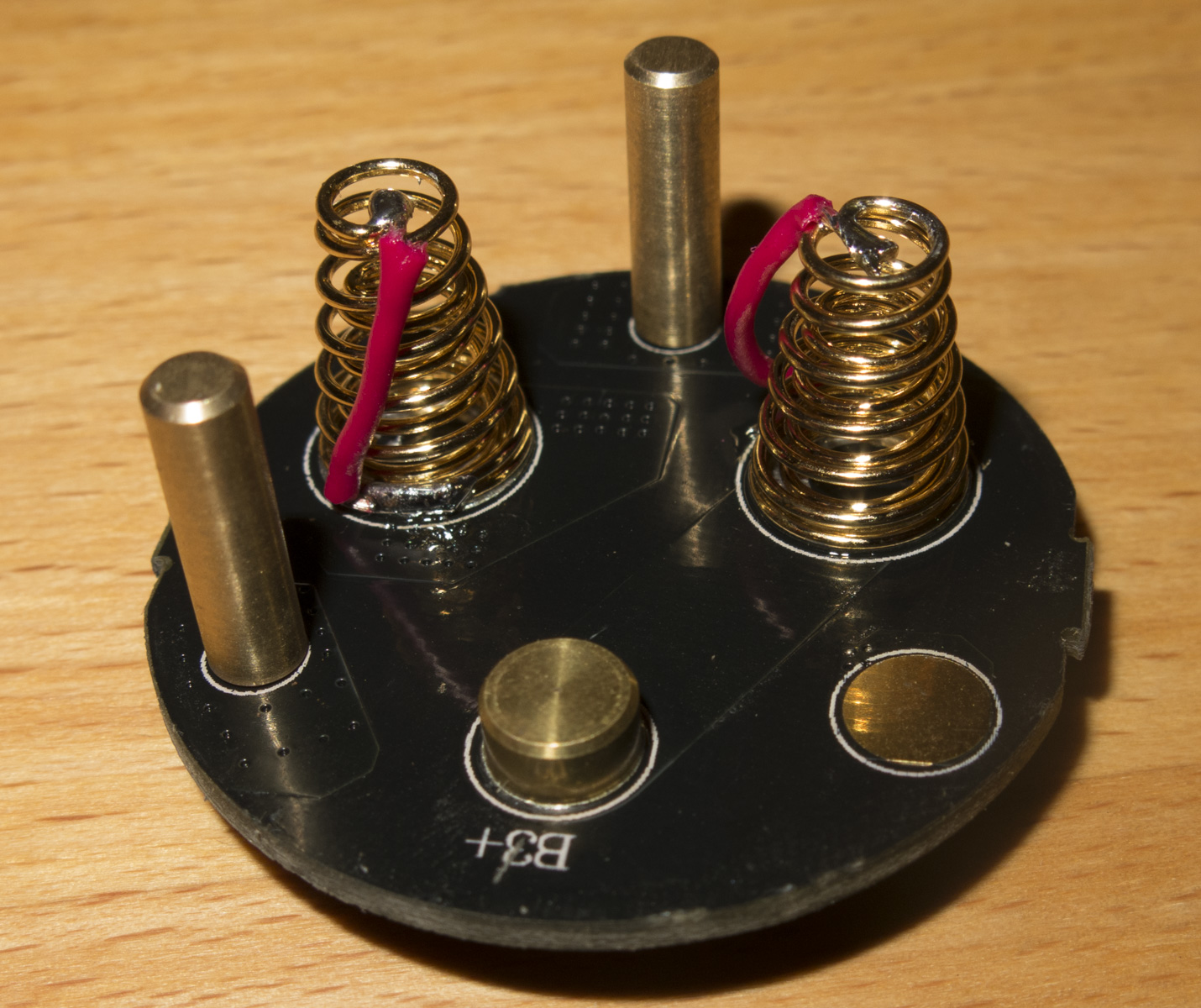

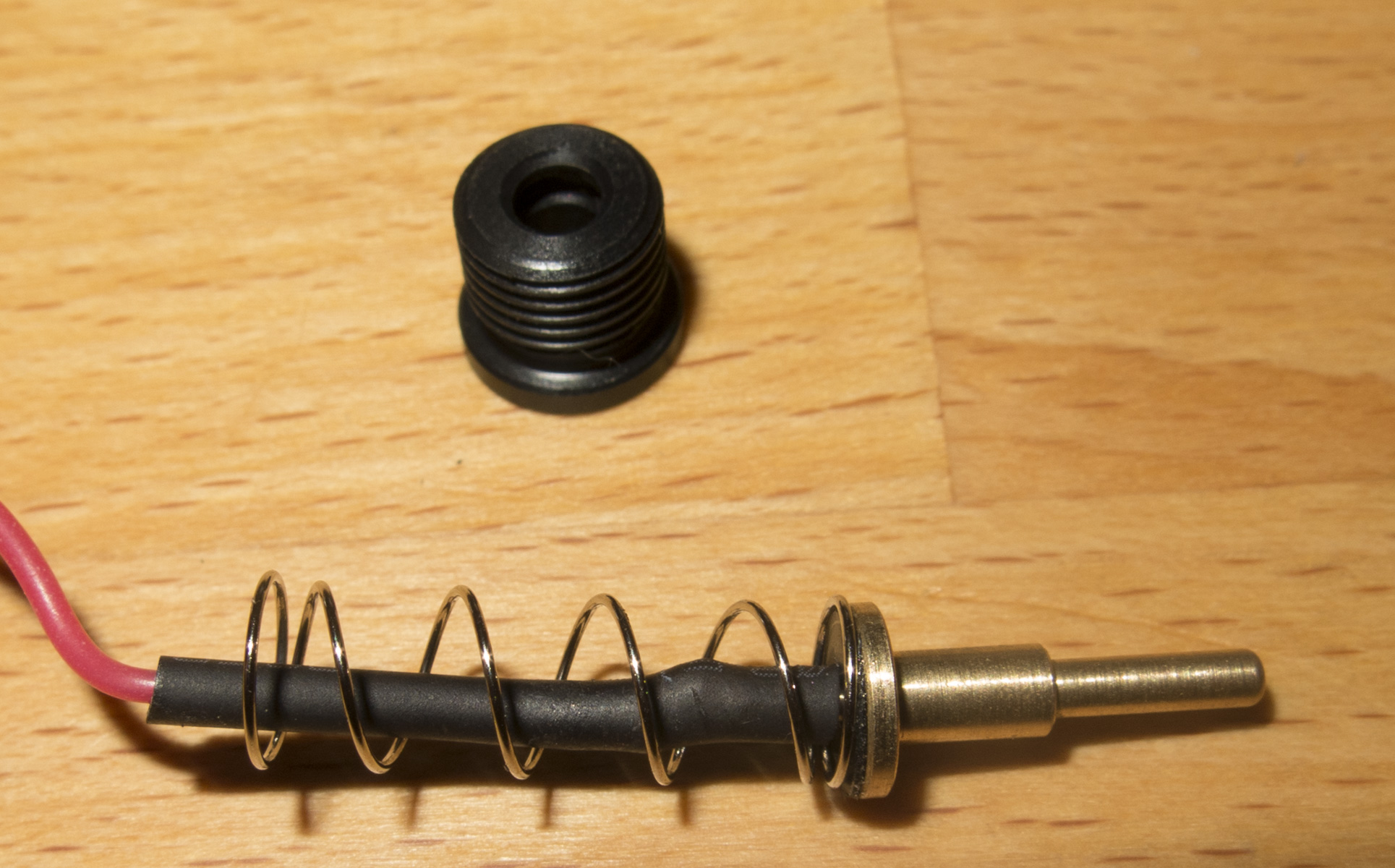

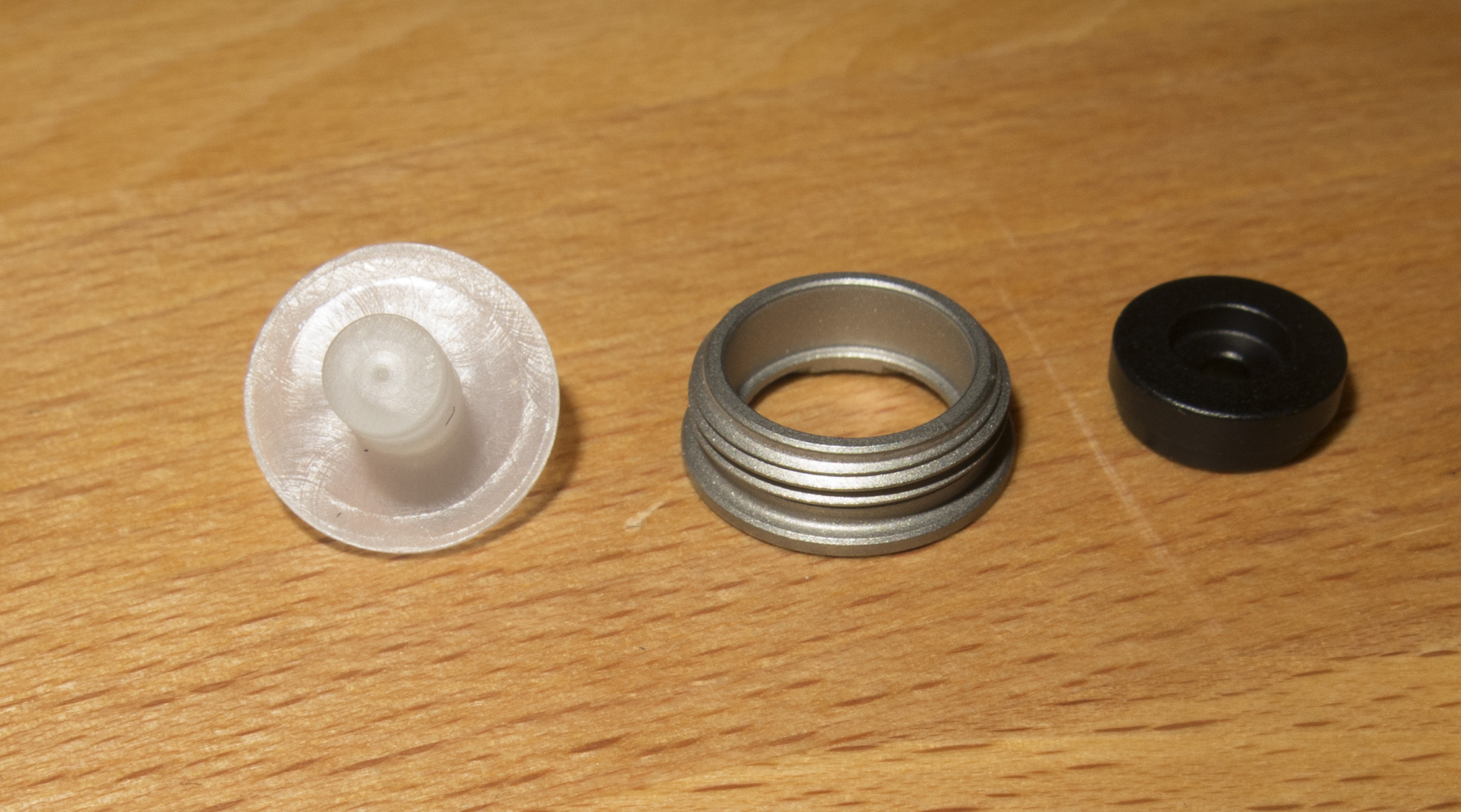

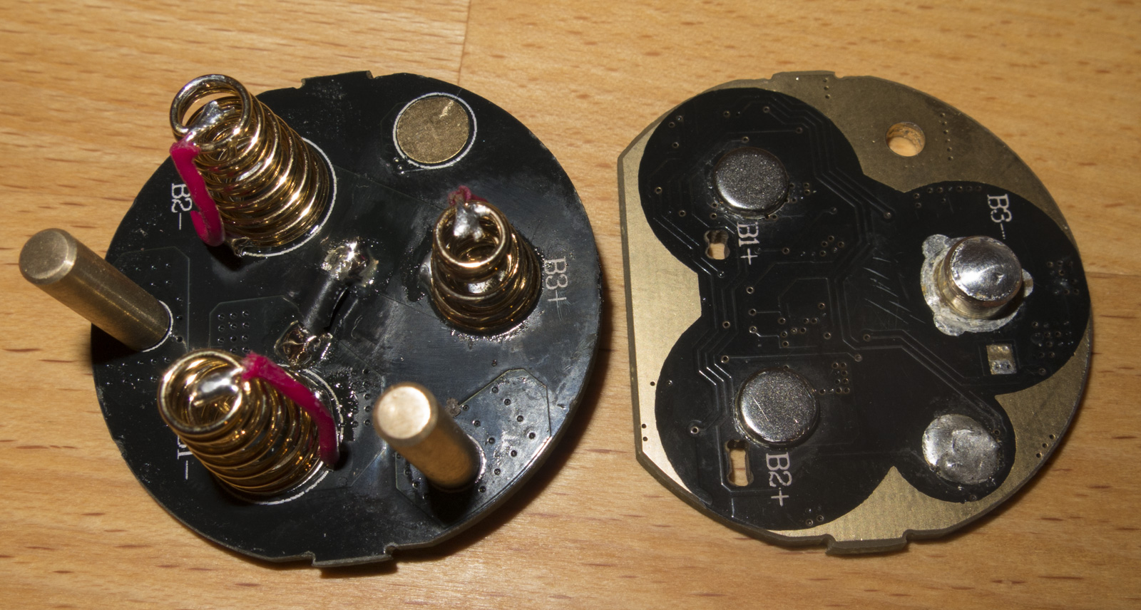

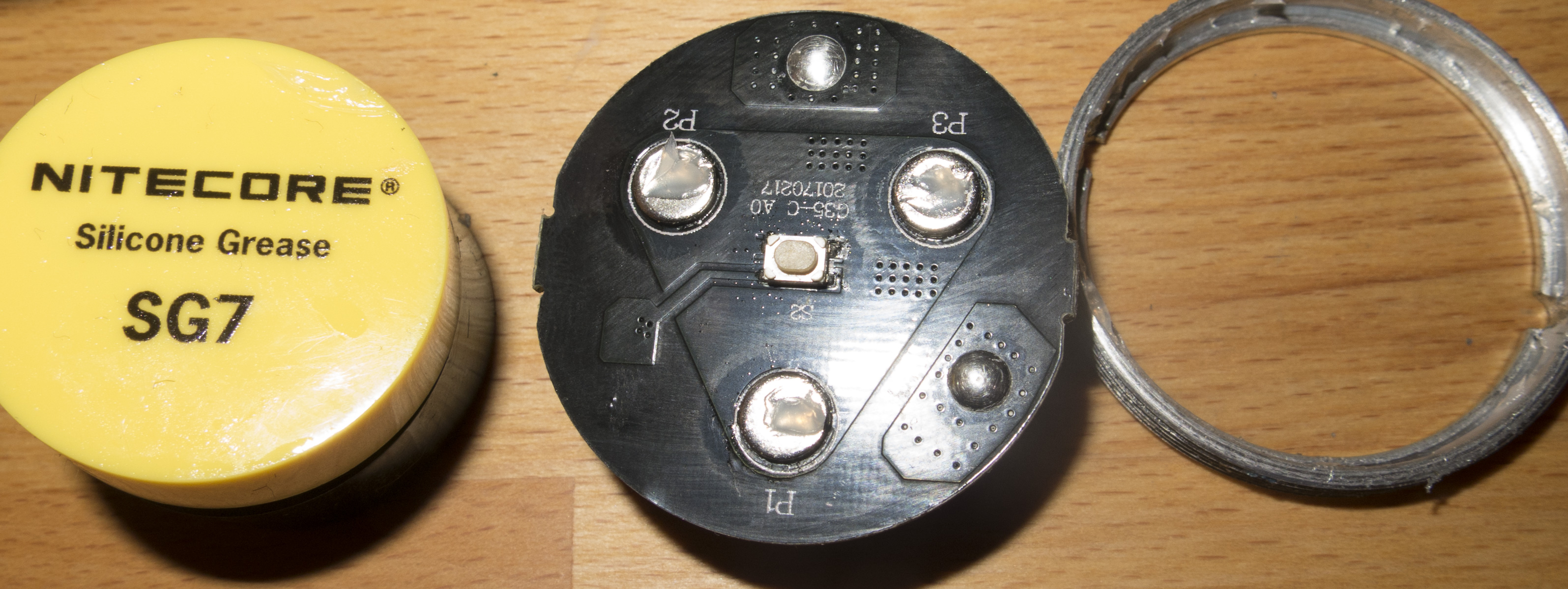

The tail cap is fully anodized, the tail PBC contains a switch, and 3 battery contacts and can freely rotate and is lined up with 2 bolts, I wish they would have put a little grease in there so it rotates smoothly
The switch cover is screwed in and almost identical to XT11/12GT lights

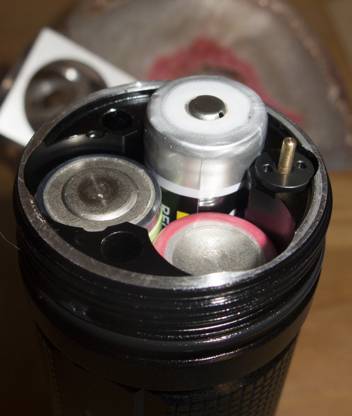

the tube is build for 3 batteries
with unprotected flat tops the spring force is really low they easily rattle inside
The tube threads are square cut and fit nicely
The tail switch uses a single contact

The light is build for protected and unprotected batteries, unprotected are very loose and rattle

The light uses a boost driver and has 2 0.1 Ohm sense resistors
no current measurements as the driver is dead

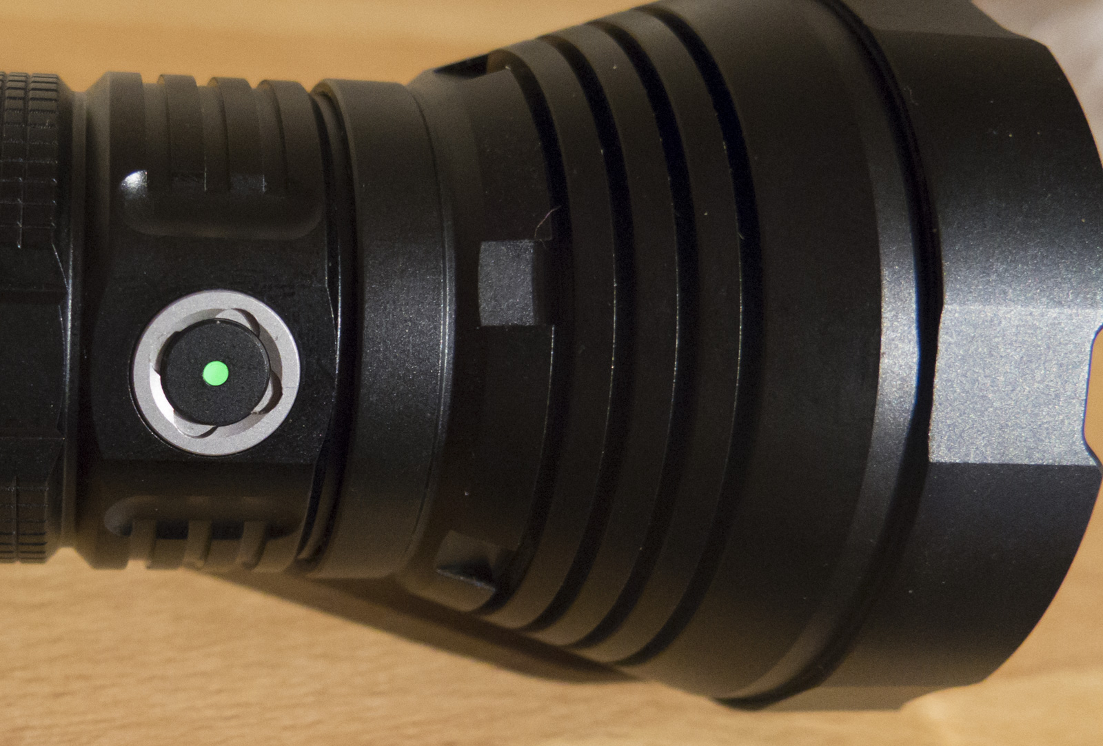

The side switch status LED shows the battery level

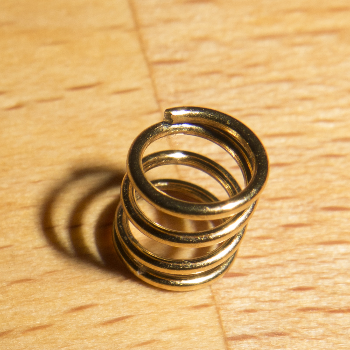

First thing was to bypass the springs on the tail cap
Using heat for the head to get the glue melted
For the tail PCB acetone was enough to soften the locktite

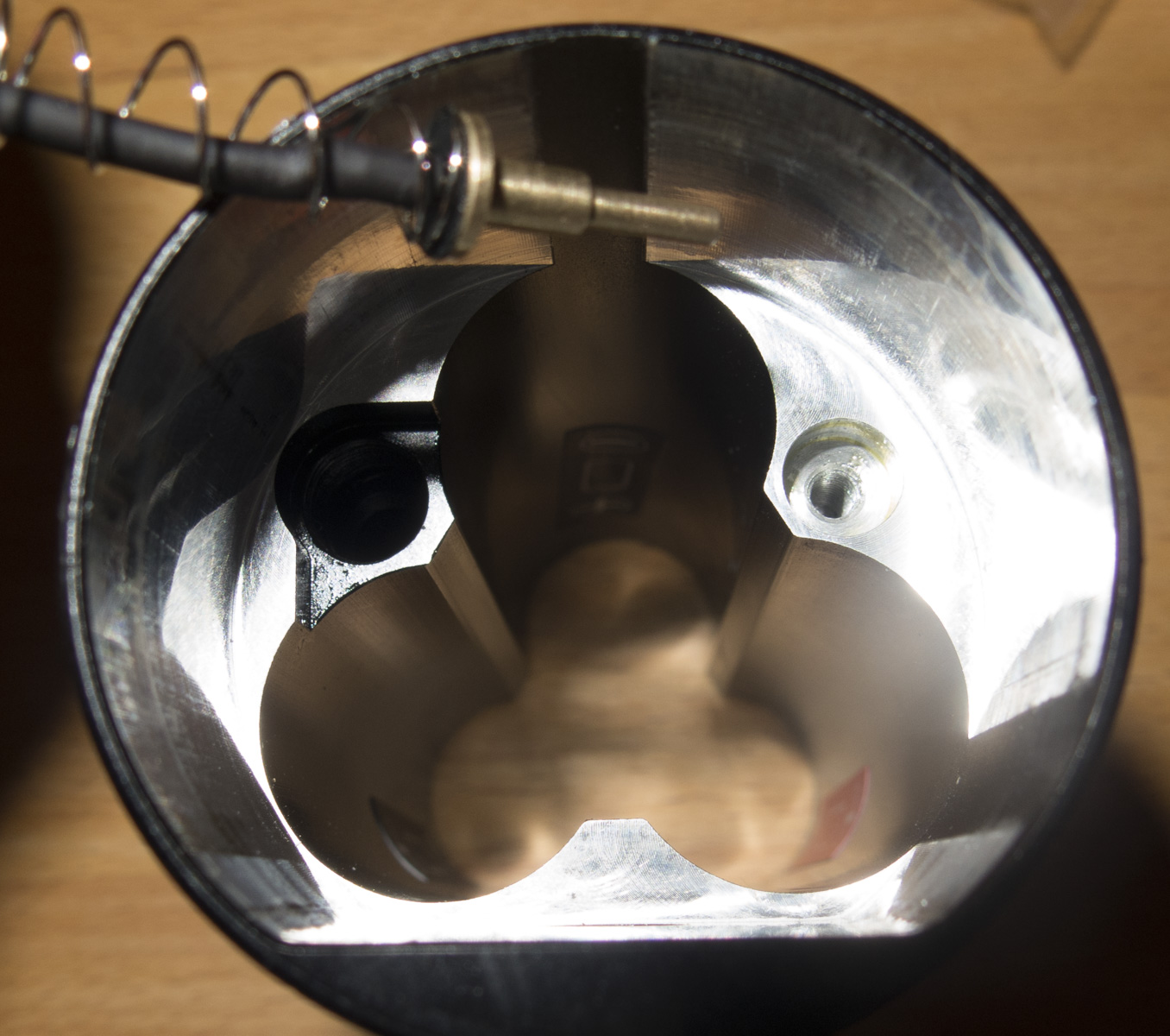

You can also see that I cut threads in reflector centering piece holes to screw lift the press fit shelf from the tube
when I lifted the driver a spring fell out which is connecting the driver to the shelf, even if most of it ahs contact to it
Driver does only deliver 8 Volts when I was prepared to do current measurements I discovered the driver dead
added a bit grease to the ail cap PCB
