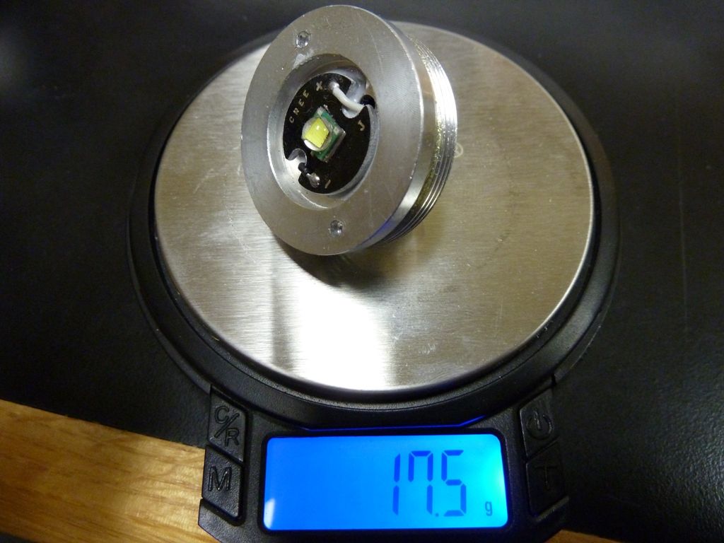

This is the emitter on the star. Without removing it, I could sneak a peek at the edges of the board by the wires and it does appear to be true copper. At some time I'll fully dis-assemble the light to confirm, and confirm it's a true direct thermal path, though there are good and bad di-electric layers, and of this has a good one, there is not much difference in performance from a direct path:

The only mod (I did so far) was to wire up the tailcap spring (below), using 22 AWG wire. I always test lights in the lightbox with a jumper wire on the cell vs. assembled with the tail and compare results. Most of the time there's loss's from the tail, and most of the time almost all the loss's are recovered by wiring the spring, and in addition, I'll clean and treat contact surfaces. Sometimes I get even higher readings with the mods than with the heavy gauge jumper wire. In this case with the 26700 cell, I picked up about 100 lumens (1,100 to 1,200), but I did measure a 130 lumen bump with the jumper wire.
