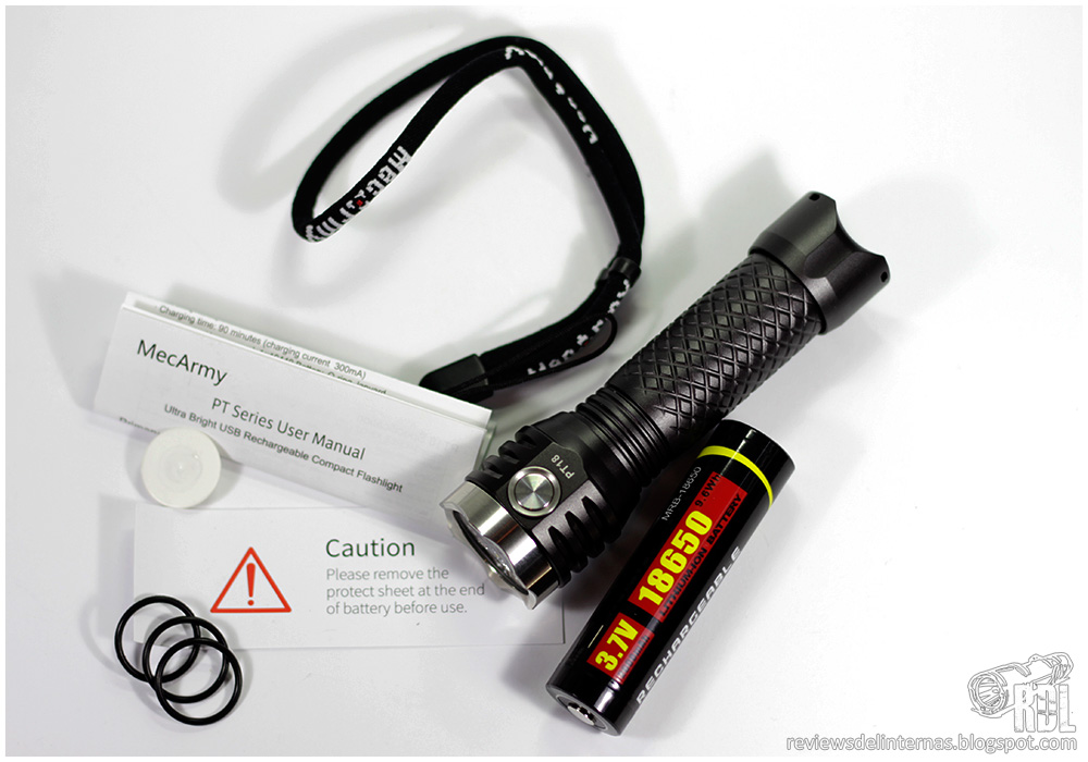

The presentation of the flashlight is very interesting. The box that comes has a front flap that can open to show, through a plastic window, the flashlight inside the packaging.
Inside we find the flashlight accompanied by a few spare o-rings, paracord wrist strap and user manual (generic for all models of the PT range) in English.

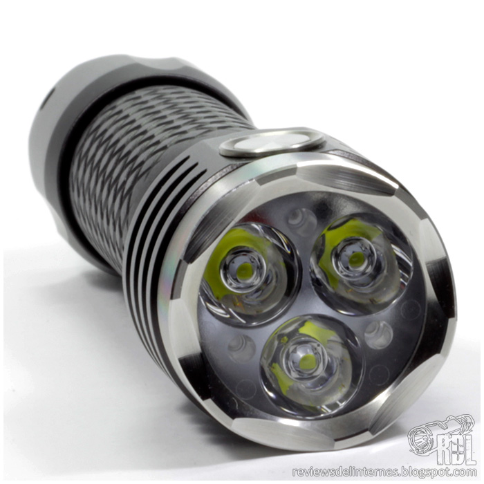

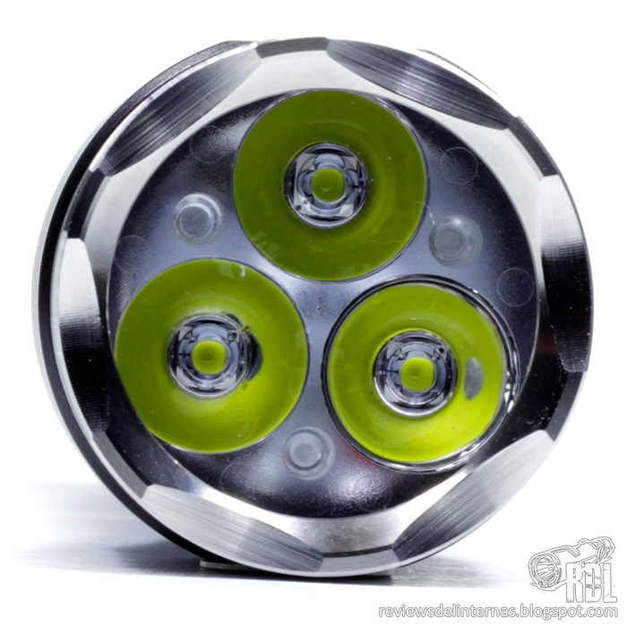

The head of the flashlight is slightly oversized to accommodate the triple lens perfectly.
It has a crenelated stainless steel bezel, which held in place a triple TIR lens for three CREE XP-G2 emitters.
The head is surrounded by discrete dissipating fins, machined with two diametrically opposed flat where one of them features the switch, which is finished in stainless steel matching the bezel finish.

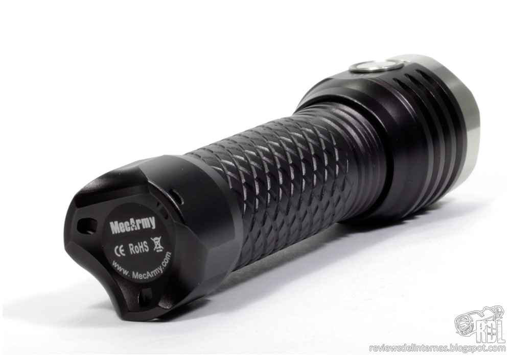

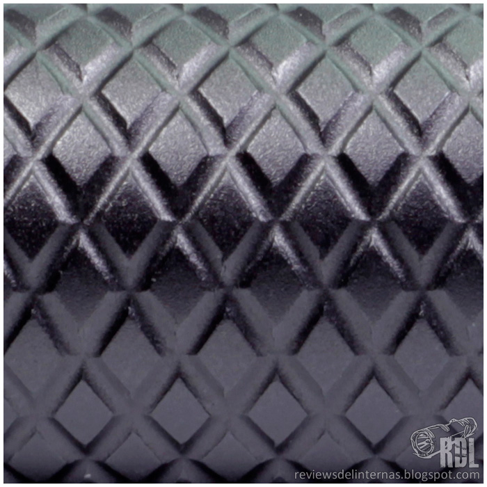

The tube has a rather peculiar finish with a smooth and not very aggressive rhombic knurling.
The tailcap of the flashlight is also slightly oversized, and has a stable base that allows us to put the flashlight in tailstand safely. The three tailcap battlements are perforated to provide an anchor point for the lanyard.

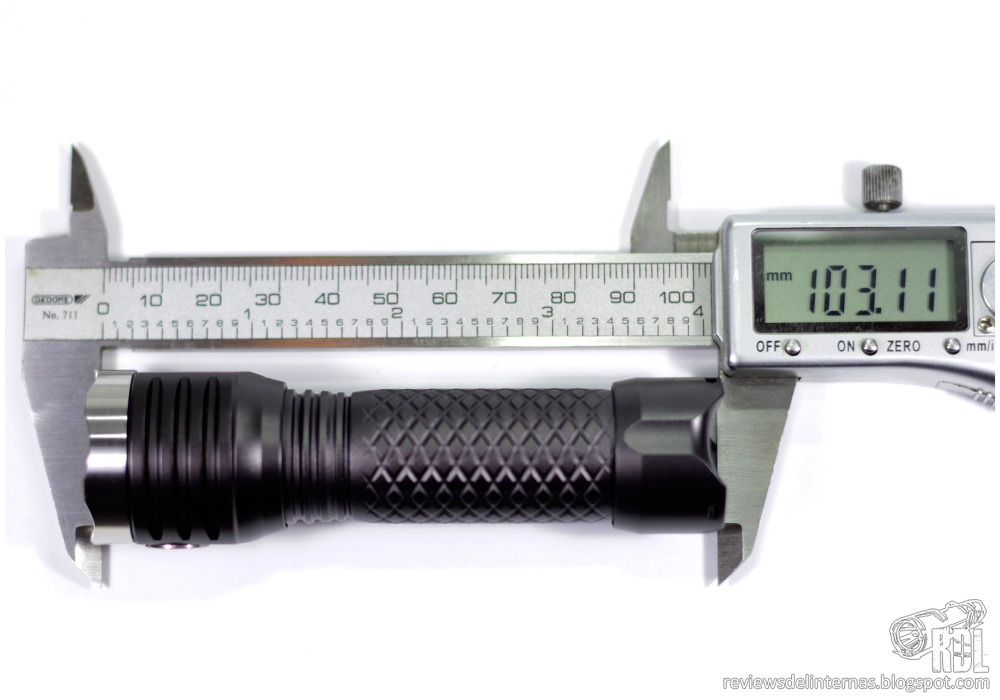

The dimensions and weight of the flashlight are surprisingly low considering that it is a flashlight with built-in charger.

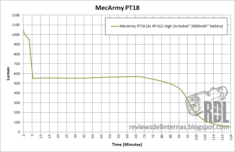

The distribution of intensities is good, with 10, 100, 330 and 1000lm spec’d lumens. The Low mode, with its 10lm, is really suitable for a default on indoors. Turbo mode has a time-controlled stepdown, coming down from the initial value to about 550lm. The correlation between specified by the manufacturer and measured in the integrating sphere is very good.
Unlike as we saw in the SGN3, this PT18 modes are achieved by regulated current with no signs of PWM.

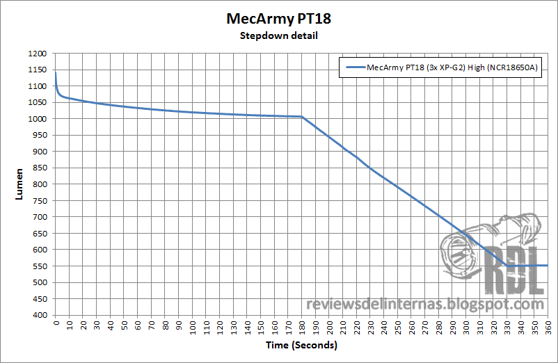

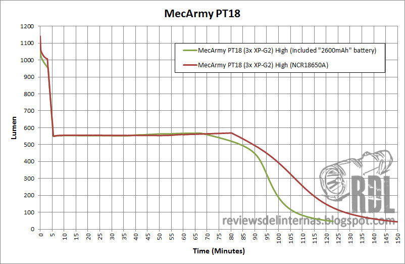

PT18 performance in its Turbo mode is pretty good. This mode has a time controlled output stepdown which reduces the flashlight output past three minutes from ignition to protect it from overheating damage. Once reduced, output is maintained until the time when the voltage is insufficient and starts a gradual drop in performance without turning off the flashlight abruptly.
To check the difference between the supplied battery (“2600mAh”) and a NCR18650A, and incidentally to compare equal this flashlight I repeated the test but this time with a Panasonic 18650 (“3100mAh”) obtaining a slight improvement in the runtime, what let me think that the included battery, even when labeled with “only” 2.6Ah has a certain quality.
The stepdown is gradual, not a sharp fall, so it is unnoticeable to the human eye. The stepdown employs about two and a half minutes to perform the progressive descent.

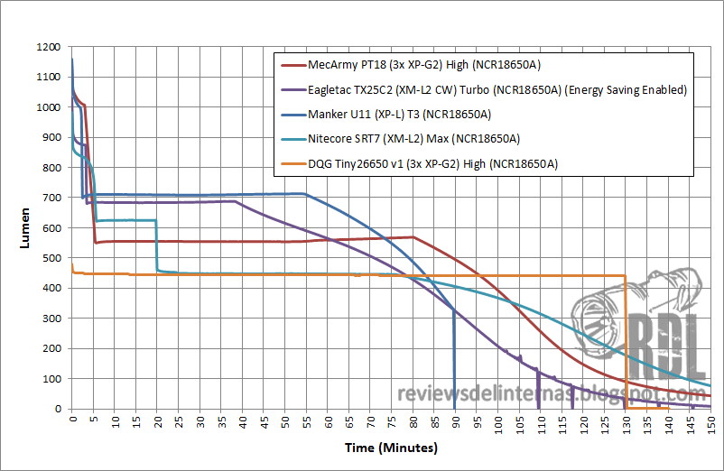

Finally, we have a comparison with other flashlights, although the nature of the PT18 I doesn’t have many really comparable alternatives.
As stepdowns are heavily concentrated in the first minutes of the comparison, I’ve crop the same graph to get a better appreciation of those first important minutes of each flashlight.

The projection of this triple XP-G2 is clearly floody, with a wide and generous area illuminated by the spill of nearly 180 degrees, while maintaining a well-defined big spot, making it very practical both indoors with low modes and outdoors with higher modes.
One of the star features of the TIR lenses is their superiority when it comes to obtaining a uniform tint. The PT18 is no exception and in its beam one can only identify a single tinted light, cool white without the classic distortions seen in parabolic reflector optics and last gen CREE emitters, especially in the area surrounding the hotspot.

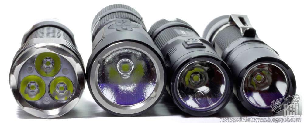

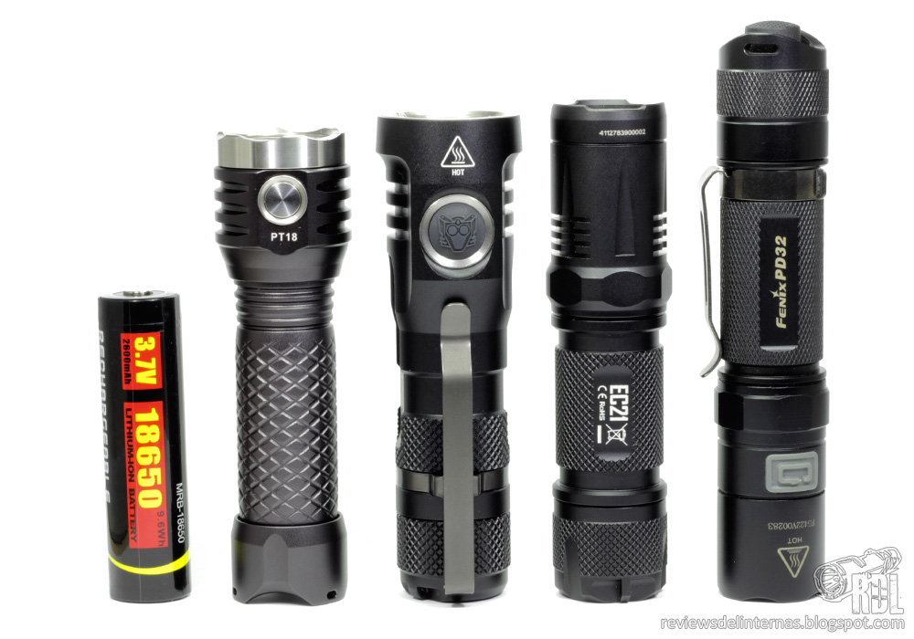

MecArmy PT18 · Manker U11 · Nitecore EC21 · Fenix PD32
