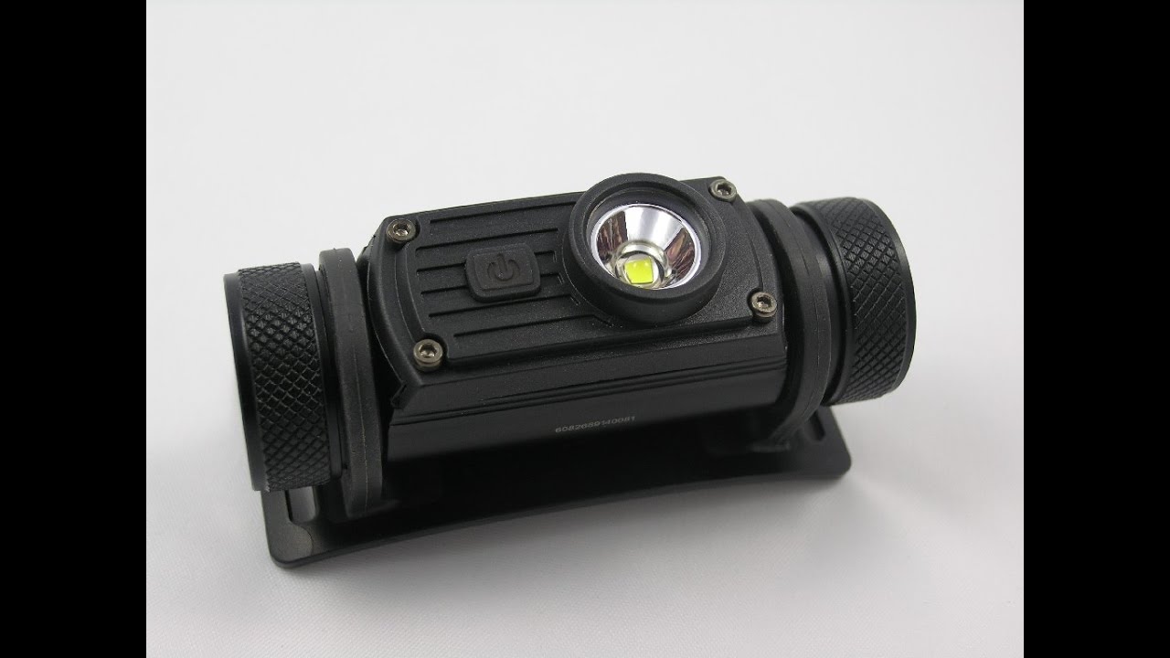

The HC60 is made mostly out aluminum, there part where the switch resides is made out of plastic/rubber. The two parts are connected by 4 screws.
Even the light holder has the same kind of construction: rigid plastic for the part that rests on your head, soft rubber for the 2 parts holding the light.
The switch is slightly raised, and has a LED underneath it.
XM-L2 CW emitter under the glass with AR treatment, inside a small and smooth reflector.
Anodized threads and squared o-rings at both sides, so the water resistant feature is not an issue even for the presence of the micro USB port.
