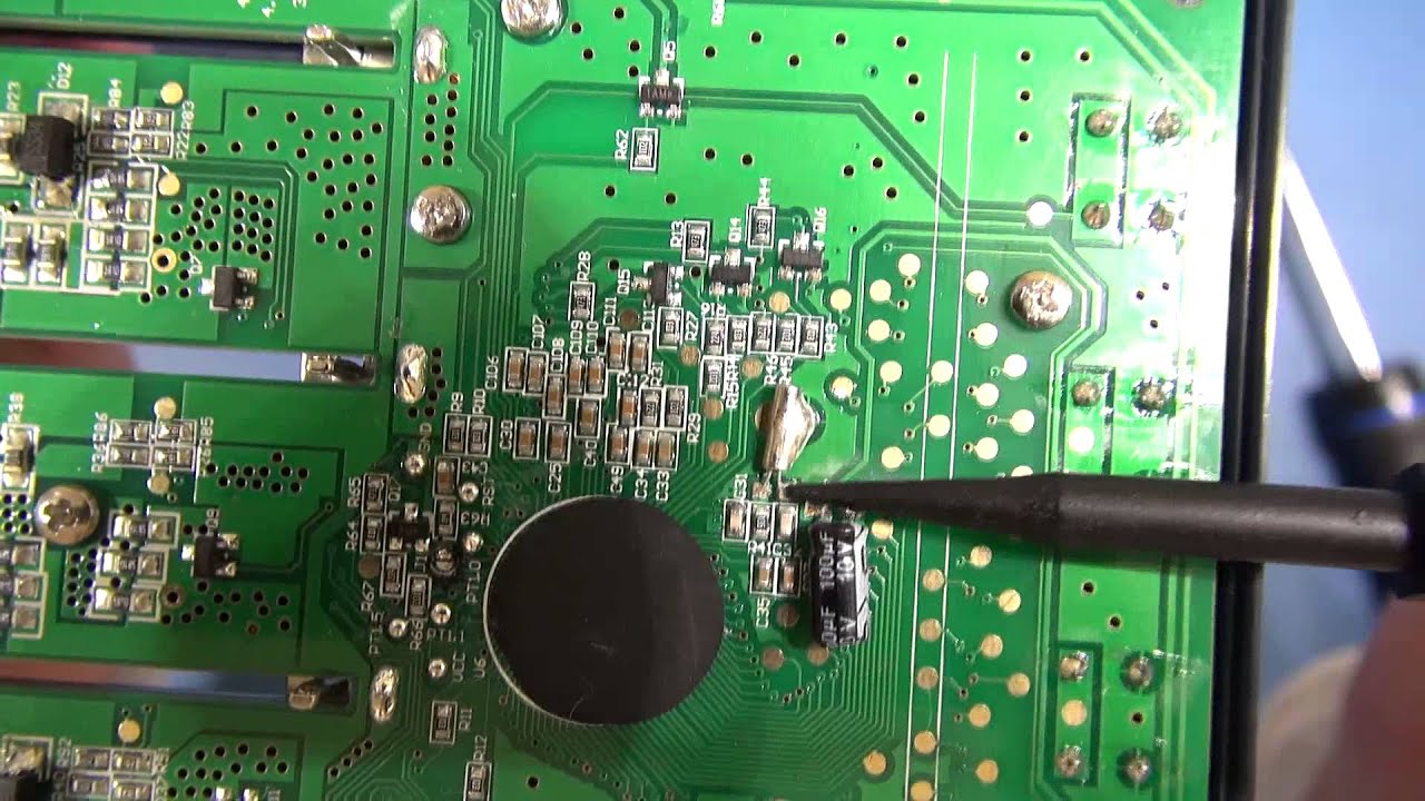

With back removed:
Most notable is the 3-way slider near the edge of the PCB (top in the above picture) for an undocumented adjustable termination voltage set to 4.2V position, with option for 3.7 and 4.35V termination. More on this later. The two pin fan connection is also accessible.
On the inside of the lower casing is black tape sealing the vents. My guess is these cutaways were unnecessary:

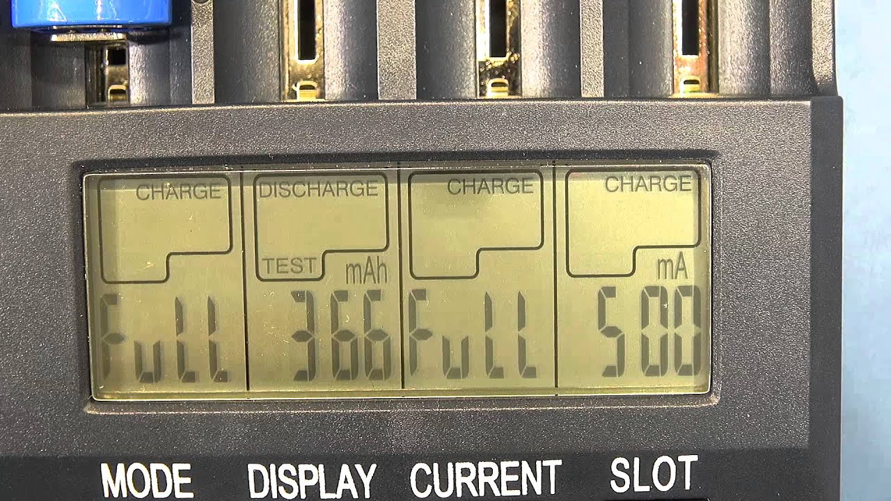

Plugging it in, white LEDs illuminate a familiar display. You may recognise it from the IQ-328. To be honest, I found this screen a little difficult to read at first. It takes a little getting used to (only a little!).
At power up, the display briefly shows all whilst it initializes. With backlight active, all display legends remain clear to read.

Below the display are four buttons to program the charger. Pressing the Mode button cycles through the modes in the above order.
Pressing the Display button cycles through the information displayed:
| Legend | Description |
| mA | Charging/discharging current |
| V | Charging/discharging/termination voltage to two decimal places |
| mAh | Capacity in milliampere-hours |
| h | Operation time in hours and minutes, updated every minute |
Lastly, pressing the Slot button selects the slot to alter its mode, in this order: 1, 2, 3, 4, all, exit. The corresponding LCD legends begins to flash like a cursor. After ten seconds of no further input, this flashing ceases and the selected mode begins operation.
