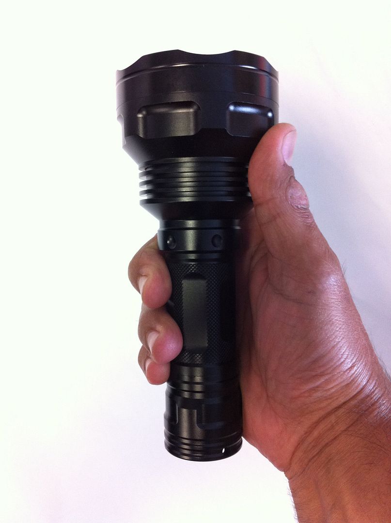

- Good build quality (heavy & thick walled)
- Very nice anodizing and machining (other than threads)
- Nice size in the hand

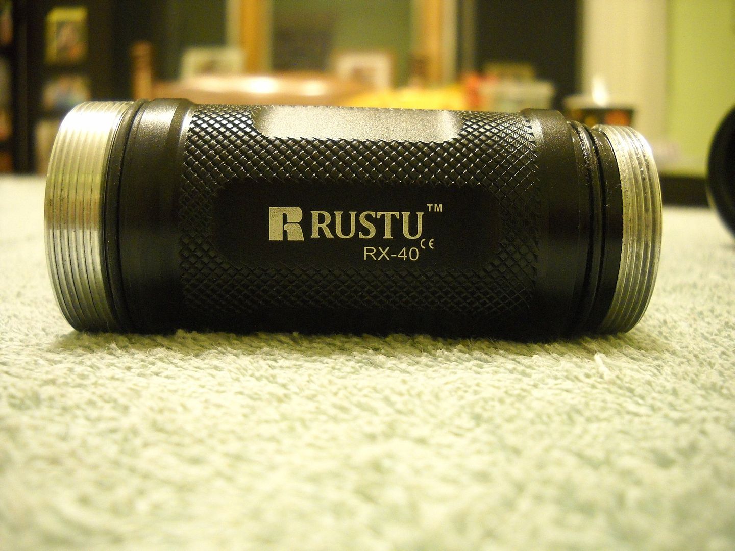

- Threads were dry upon arrival and squeaky. Rougher than average.

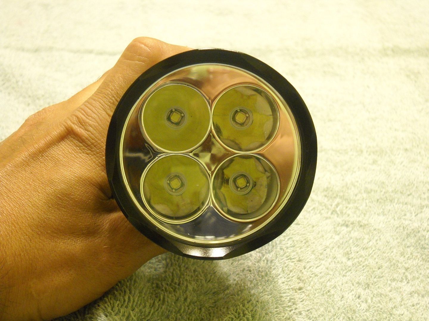

At first appearance this light looks and feels really great! It has great machining and anodizing, has some serious heft to it, and just plain feels good in the hand. But that’s pretty much where the good ends and the bad begins.
The threads arrived dry, are gritty, and squeak badly. I’d say the threads are slightly worse than the average budget light. Each 26650 battery I tried (King Kong INR 4,000mAH raised-top unprotected, King Kong ICR 4200mAH flat-top unprotected, and Trustfire Flame protected) rattled a good bit. Even with the KK raised-top, a severe shaking of the light will cause it to change modes.

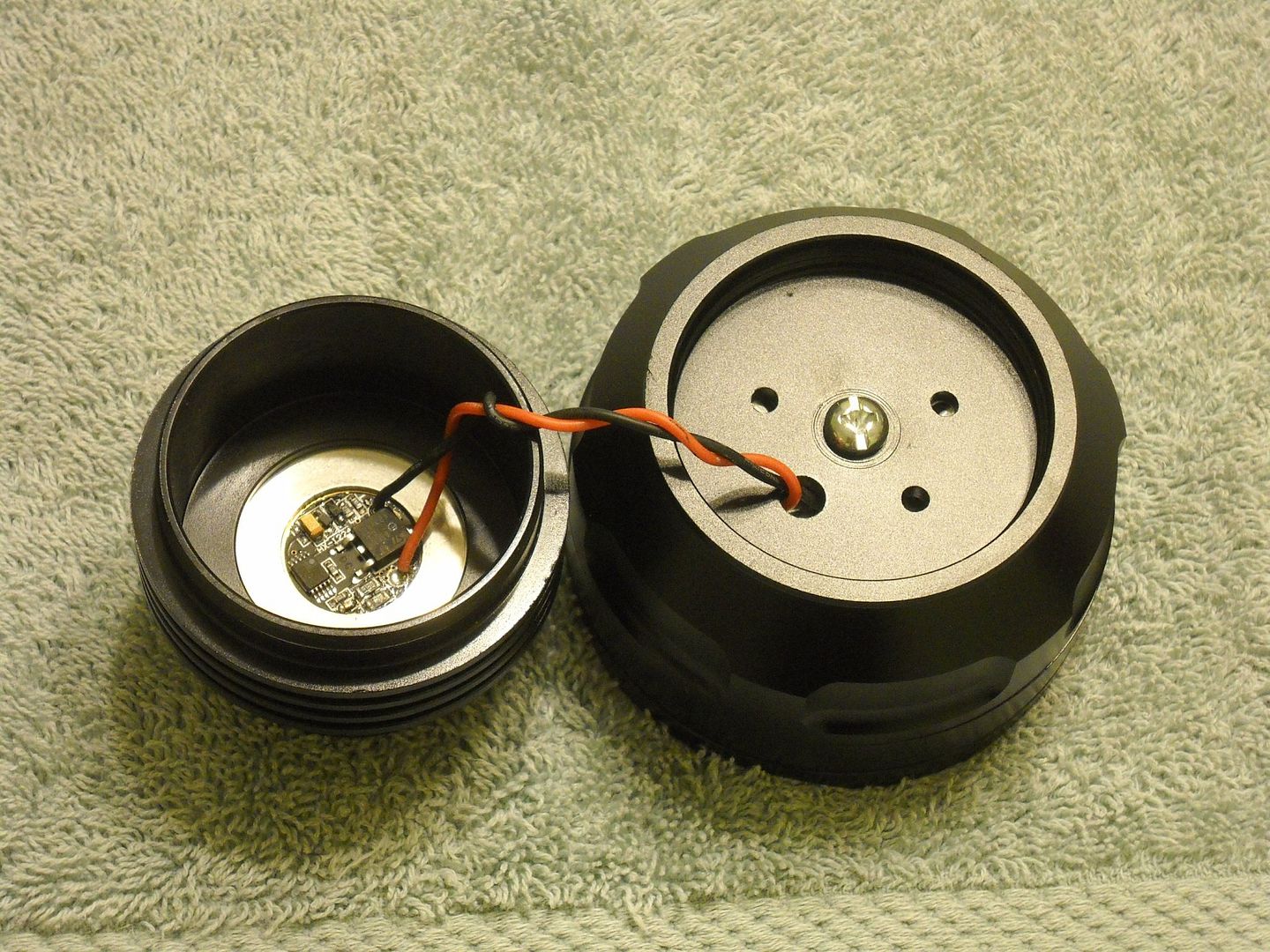

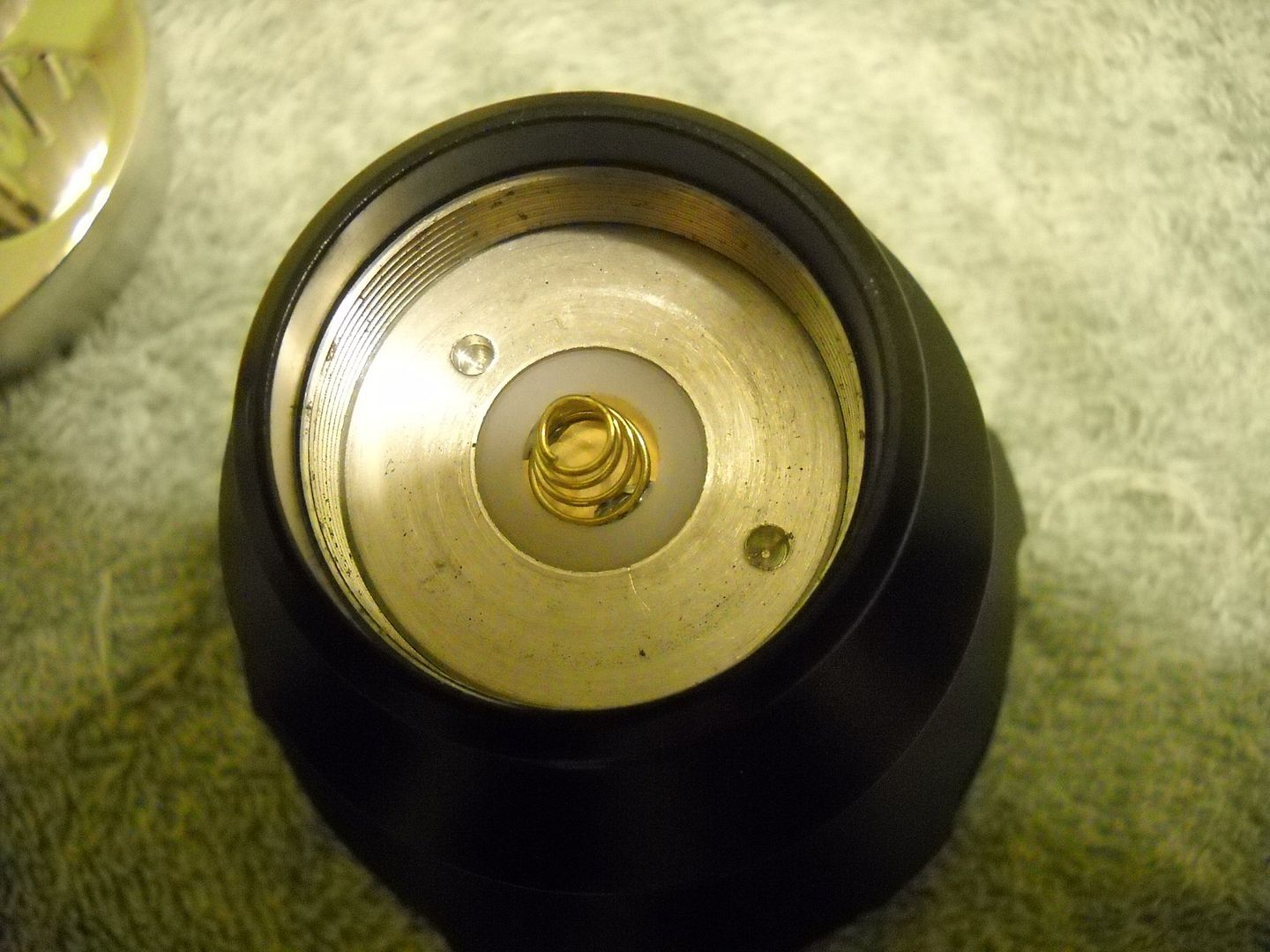

Upon disassembly you see that the “heatsinking fins” are really just for looks as the area where the LED’s are mounted in the head do not make direct contact to them. Heat must be transferred from the head through threads to get to these fins. After leaving the light on for about 5 minutes I noticed a lot of heat at the glass lens and the bezel, but almost none at the heatsink fins.
Light Output:
Generally speaking the output on high is quite nice with a very nice wide floody beam pattern. I was impressed with the beam. It still has a very distinct bright hotspot, but yet a bright wide flood. Going through the modes I quickly thought “what the ???” until I realized there is no medium mode but rather a second occurrence of high and then a low that is almost indistinguishable from high. Of course there is the typical strobe and SOS mode following, with the strobe being what I would call medium speed. One surprising feature is that the driver has good working memory which remembers your last mode so long as you leave the light off for three seconds or longer.

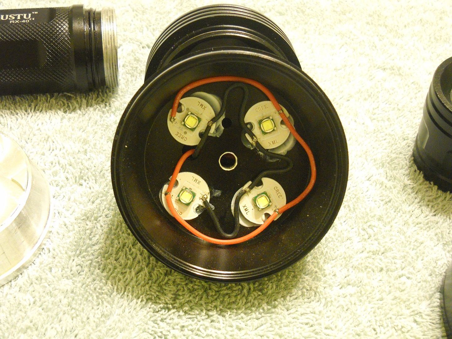

The LED’s are wired in parallel and the driver is neither a buck or boost driver so the approximate current to each LED with a tailcap current of 4.27A would be 1.07A though that assumes 100% efficiency. A well driven SkyRay King will easily beat this light for output.

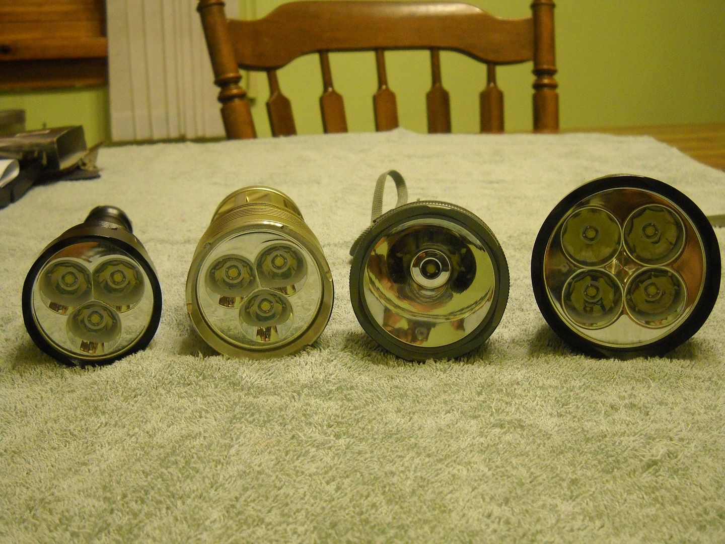

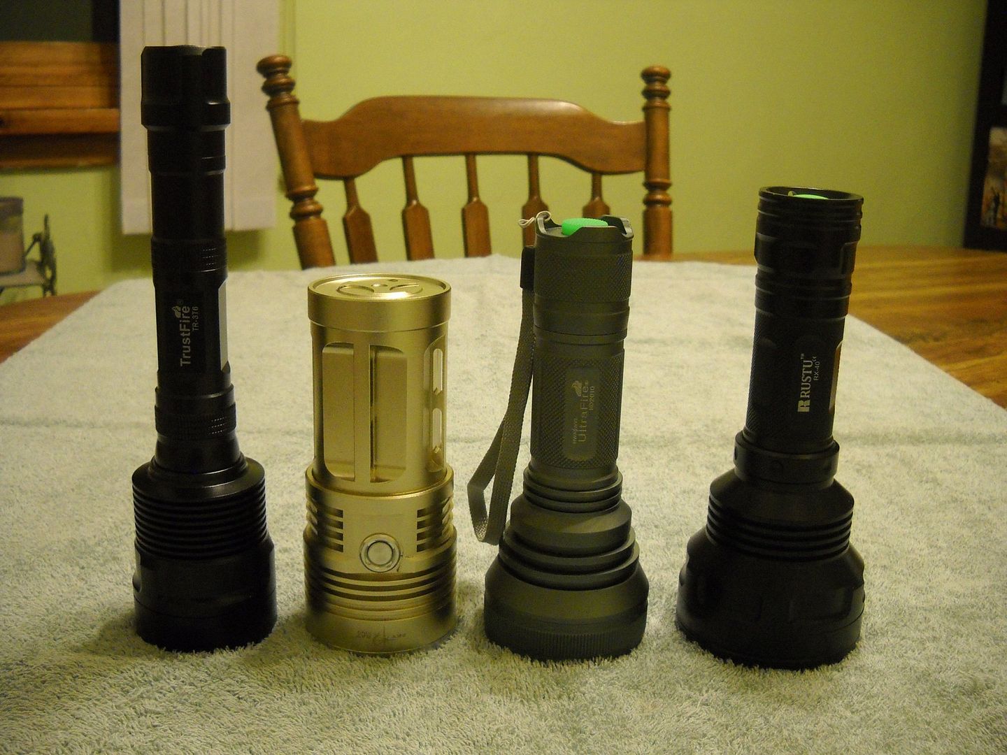

Size Comparison against other known lights (left to right:Trustfire TR-3T6, SkyRay King, HD2010, Rustu RX-40)

Emitters (wiring seems to be of good sufficient gauge - 20AWG?):

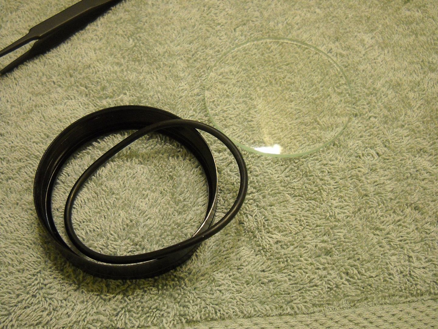

Thick glass lens and thick o-ring:

Showing the poor threads:

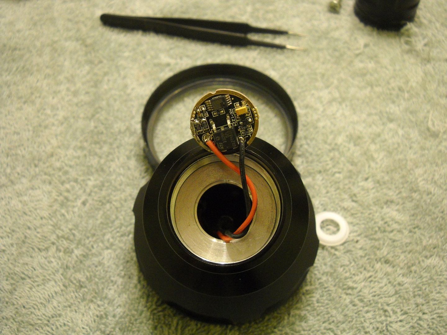

Driver mounting:
Cavernous driver cavity (notice how the head is not directly connected to the heatsinking fins):
Driver removed:
Closeup of driver:
