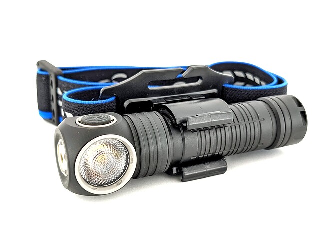

[Review] Skilhunt H300 Nichia 144A Review – The Best Headlamp I’ve Used
Skilhunt H300 Review – The Best Headlamp I’ve Used

A few comments on review:
  • While i agree on lower turbo being useless i do use higher moonlight. It is handy when using moonlight and slightly higher brightness is needed. Switching to main group is inconvenient and results in going to last memorized more (so potentially to high), so higher moonlight is actually useful to me. This also highlights (subjective) downside of the UI - memory which can not be disabled.
  • I’ve tried unprotected button top vapcell B30 and it did work without issues. So few millimeters are sufficient compared to standard flat top cell.
Also i still prefer 519A tint a bit compared to 144ART, so for me H04 is still a good option, especially since it is cheaper, has 18350 variant and has reflector variant (at least when i bought H300 144ART + reflector combination did not exist)…

On the issue of the secondary moonlight mode, the situation you described could also be solved by including a way to go from Moonlight to Low mode, ideally via 1H. That brings you into the main mode group in a convenient way and it starts on the lowest level.
The tailcap needs to be redesigned to accomodate a 3mm or thicker magnet. The stock 16mm x 2mm isn’t strong enough to hold the light on some surfaces, the light slides down.
I removed the spring and glued in two stacked 1.5mm N52 magnets, and glued the spring in place on top of them. The light won’t take a protected cell now though, but works perfectly with normal flat tops.
