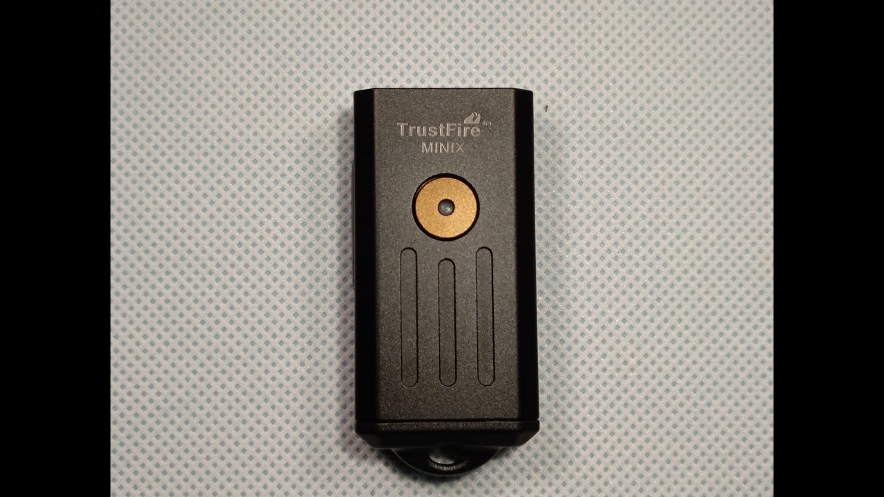

Talking about the flashlight, here’s what it is:
- it is a small, compact and lightweight flashlight
- there are no machining flaws that can be seen and everything seems to be well put together
- most of the body is aluminium, except for the front (TIR) and the back (lanyard hole), which are plastic or other non metallic material
- in the front there is a TIR optic sitting above the 2 LEDs
- the TIR optics are not completely clear as the center seems to be a bit “frosted”, eventually to avoid beam artifacts
- below the TIR, there is a red o-ring that helps on water and dust proofing
- there is no information about the LEDs used, if on the Red LED I would bet on Cree XPE, I am not sure about the White LED (I can only say it seems to have a white part on it, like Osram Leds or XP-L HD) [See some ongoing discussion on this thread: Trustfire MiniX $15.70 on AliExpress ]
- in one of the smaller sides, there is the USB-C port, covered by a silicone cover which stays in place and is not removed easily/accidentally
- on the other side there are the engravings of brand logotype, CE, disposal, battery size (3.7V 300mAh) and also the Serial Number
- on the top side, there is the engraving of the brand/model and the switch button, which does not protrude that much
- there are also 3 small grooves (let’s call it “knurling”) that can be used to distinguish the top side from the back, and that also help on the grip
- on the back side, there are only 3 longer grooves that help on the grip
- the tail of the flashlight is made of plastic, it is not flat (so the flashlight doesn’t tailstand), and it has a hole for a split ring or a lanyard, also serving as the “cover” to hold the internals in place
How do I feel about these “physical” features?
- the grip is good, not slippery, although the light feels small - as it is - in the hand (I am using a lanyard for better support
- although the switch button only protrudes slightly, it can be “easily” found either with the thumb or the index fingers (depending on how you hold the flashlight, of course)
- it would be nice to have it tailstanding, but that would make the light become a “brick” without forms, so that “protruding” part on the tail is not a bad design at all
- I do like that the silicone cover on the charging port is not accidentally “removed”, so it stays in place very well and the port is not exposed
- given that there is no glass above the TIR, the TIR optic is prone to scratches, which already happened in mine, without major consequences on the beam, though
- my light already felt to the ground some times (from above 1m) and the only damage it took was a slight bruise in the corners of the head, provoked by the impact
- concerning body scratches, so far, there are none.
