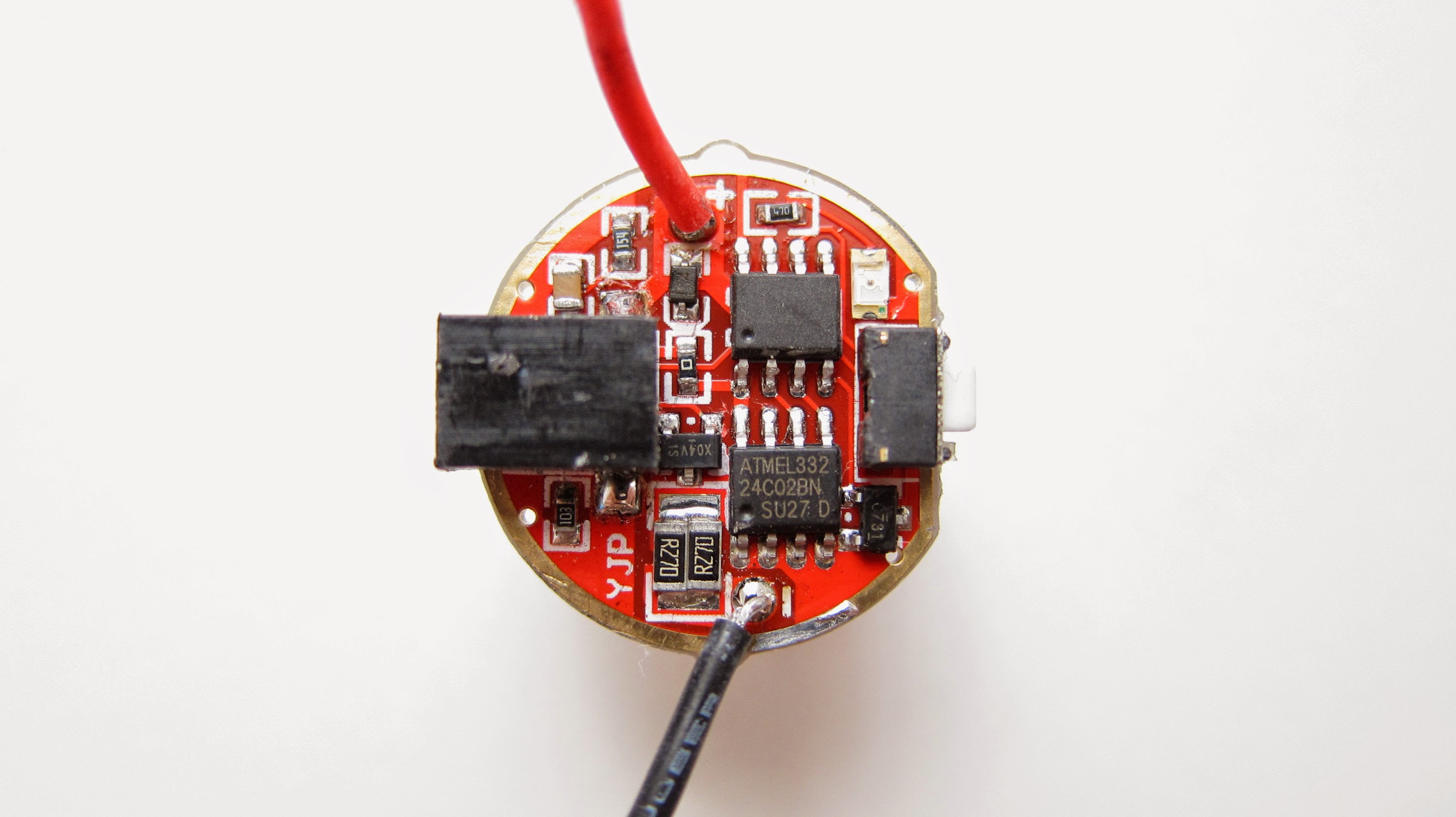

To remove the driver one must desolder the star and unscrew the side switch bezel. The side switch has a thick clear silicone o-ring surrounding the button which makes it harder to press (it still has click action).
This is good for users that want a switch that won't turn on easily.
Warsun driver, Atmel 24C02BN (click for hi-res):
Above the switch (right) is a red SMD LED. I tested it and it does not seem to be bi/tri-colour. Maybe this CT9T driver is an earlier version. Silicone wires are used to connect star to driver.
With driver removed (there is no centre hole, only two smaller holes for wires):

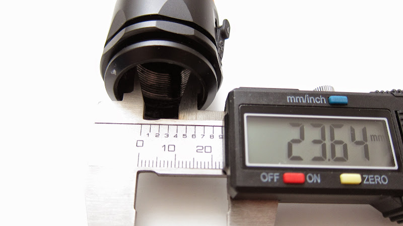

Max diameter for driver board:
