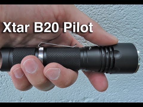

Review: Xtar B20 Pilot
First off, if you want to skip the text here’s a full alternate video review. Complete with cheezy music!
I want to thank Ken at Xtar for the opportunity to review this light. I’m still fairly new to this, so bear with me. I don’t own a lot of the high tech stuff that some of the awesome reviewers have, so I’ll just try to take a lot of interesting pictures and test the light thoroughly- and hopefully you can decide if this light deserves your hard earned money. Anyway Xtar seems to be releasing quite a few new lights, and their new 18650 light had me interested because of it’s claimed output, nice runtimes, that and it being relatively compact. And as far as I know, since this light is so super brand new (released late last month), I think this is the only review of it right now. Since I go backpack camping several times a year I like bringing along a nice variable output light to use at night while doing chores around the campsite- because there’s no source of artificial light in the national forest. It also needs to be tough, relatively compact, resistant to the elements, and reliable. And according to the initial specifications it seems to fit the bill.

Ok, so what about the light?? How big is it? Here are a few shots that give an idea of scale.
Next to a Convoy S6/Xiaozhi.
Next to some of my EDC stuff.
For my tastes it’s slightly too big for blue jeans style EDC. Some people think that the S6 is even too big for EDC, so it’s a fair point. If you wear cargo pants and jackets or use a holster then it might be an EDC for you. I walked around with it in some shorts (with cargo pockets) and I barely noticed it. I used the clip. Which brings up something I’ve been thinking on. This would make a great general purpose light for bike commuters. It has a ton more runtime than some of those 4x18650 bike lights- and it can be removed easily at the end of the ride. The slight downside is that it doesn’t put out as many lumens as some of the scorchers do, but in my opinion a well made light like this- given the runtimes is a much better choice. It is plenty plenty bright for a bike light. It combines the right amount of spill and throw to light up what’s directly in front of you and what’s further down the road/trail.
Check it out.
Also, who cares about rain when it’s waterproof down to 2 meters? Seriously, let it get soaked.
Ok It has a removable stainless-steel clip, that’s fairly strong.
Here is the light without the clip.
Next to the EA4W, something I will use as a benchmark in this review- mostly because it’s popular.
The light fits nicely in my hand, and has depressions around the diameter to rest your thumb.
