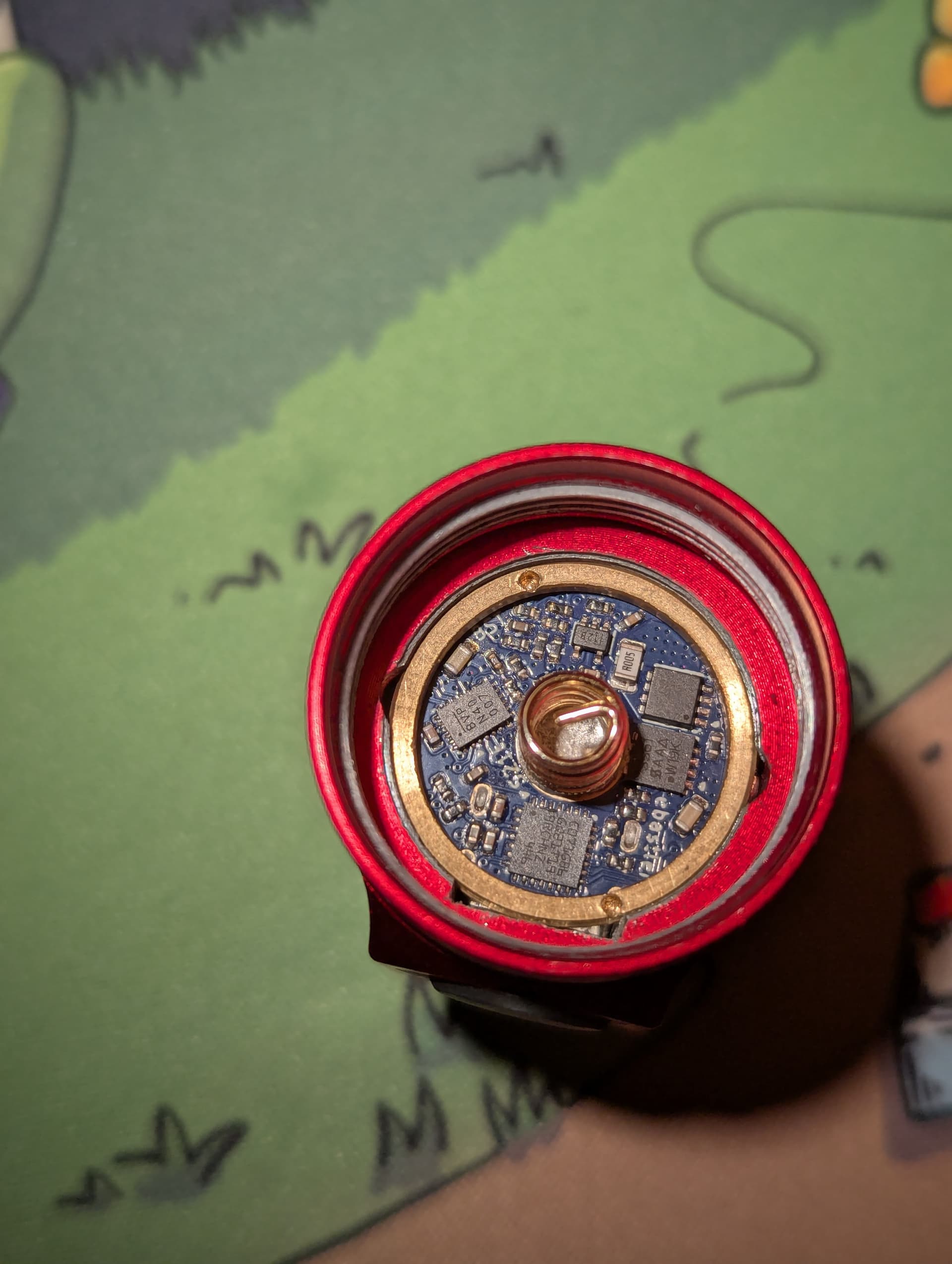

The bad news - I messed up the measurements of the USB port somehow and had to file for half an hour on the inside of the host to fit the driver. I think I still have enough clearance on the PCB to fix this without too much hassle in a future revision.
The good news - it charges with up to 15W as planned, and it shows up as a STM32 DFU device on the computer.

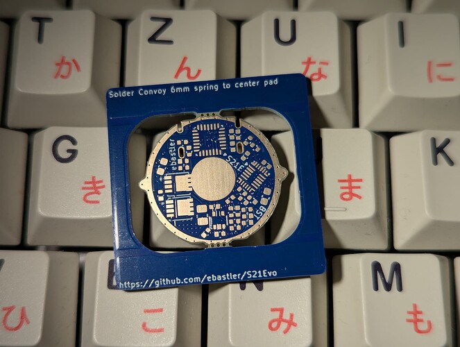

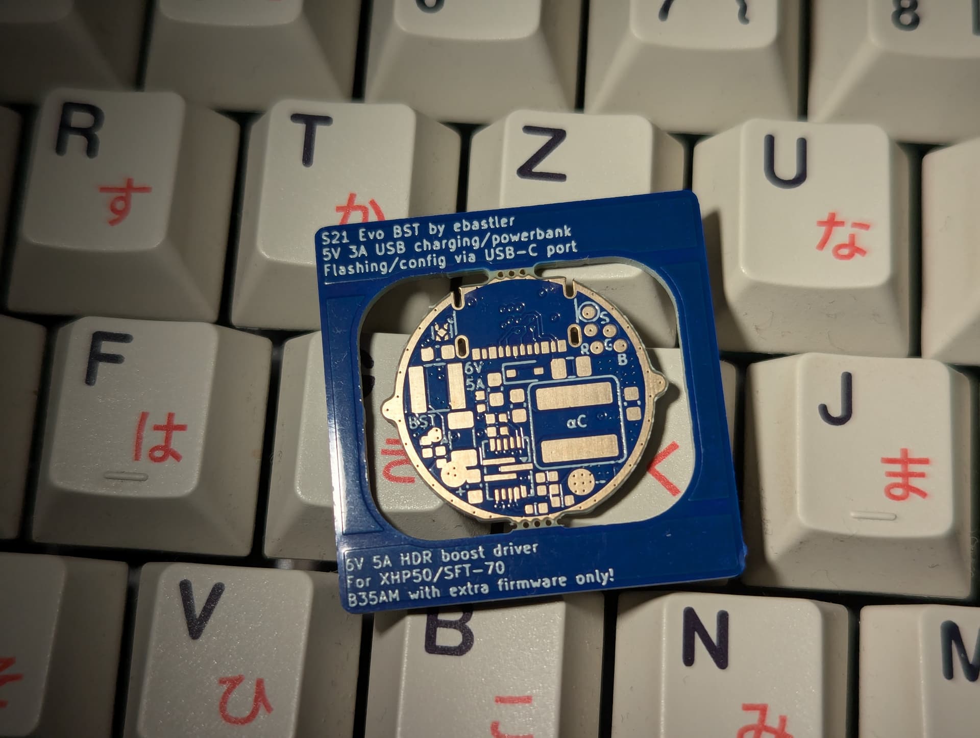

I just realized I forgot to share some pics. This is seriously tight, but works fine. I only have to move the USB port so I don’t have to file down the inside of the head…
Pcbway also included some unassembled boards. Not entirely sure why, as I did not pay for them - I guess they wanted to produce some extra because I was quite pushing the process I paid for so they were not sure if all PCBs they made would work.
Edge plating would make the thing a whole lot cooler. Maybe for the next rev :wink:
