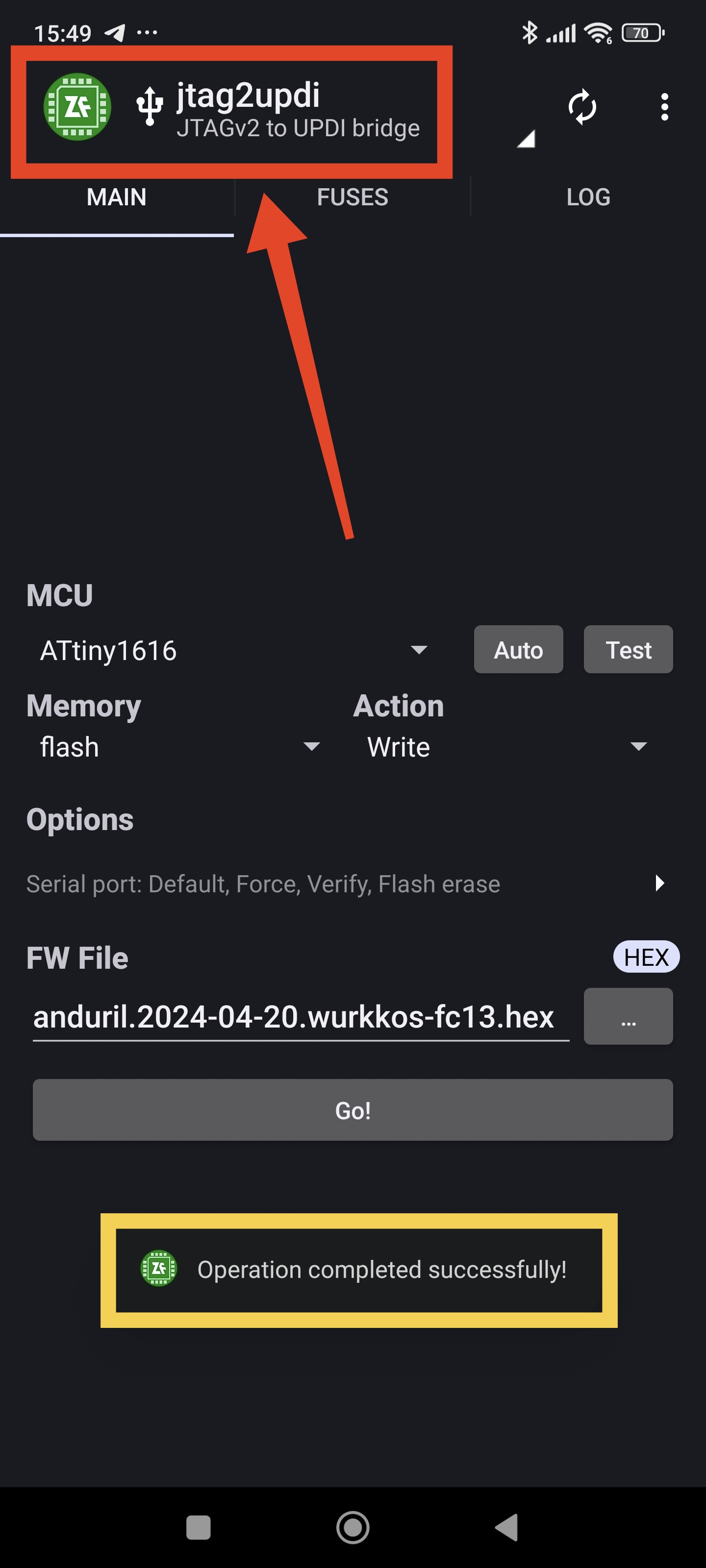

I am using this tutorial to be able to use this programmer.
Then I understand that once programmed it uses the serialupdi protocol. Please, if this is not the case, someone can correct what I am saying
Anyway, as soon as I can, I’m going to try what you mentioned because I may be confused since my knowledge is quite limited and it may work. Thank you very much and best regards
Good morning.
Thank goodness I listened to you because it worked perfectly. I don’t know why I was so determined to put serialupdi and not jtag2updi as you told me because when modifying the programmer firmware the protocol was also jtag2updi. Thank you very much for your contribution, without your help I would still be mulling over the issue. The resistor is not necessary and the programmer is cheap and works perfectly. Once the whole process is done it now seems very simple to me.:slightly_smiling_face:
By the way, if anyone is interested in using this programmer and has questions about the process, feel free to ask me.
