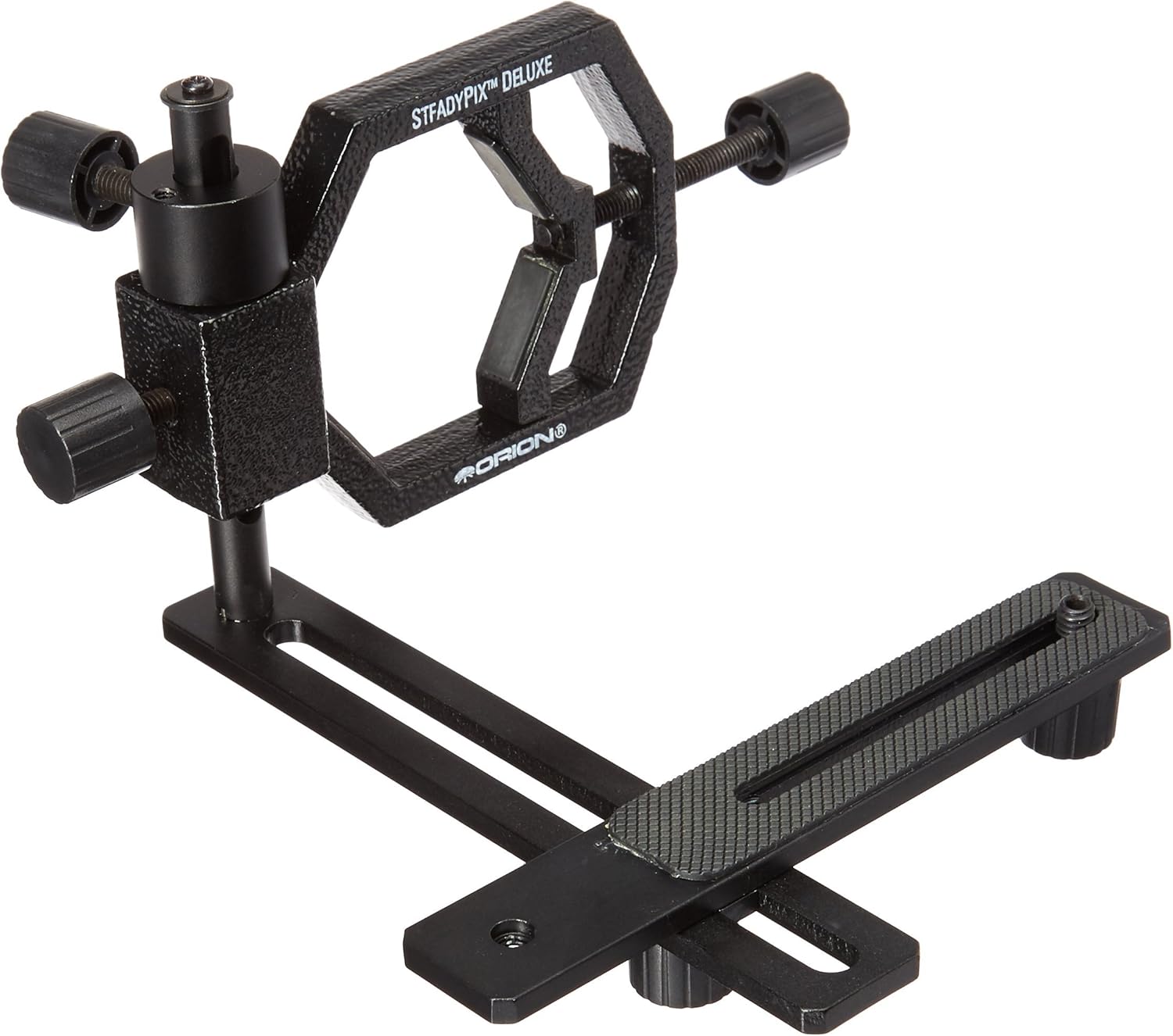

My guilty pleasure is watching Ted’s Holdover he has a collection of awesome pre-charged rifles and a camera attached to his scope that is a cool combination. The rifle in the video is about $1500 more than I’m willing to spend.
Yeah, I have seen that guys video’s, love watching the trajectory of the pellets as it hits the targets
Does he list his camera mounting equipment to his scopes?
YUP
I can’t count the times I have followed his links and dreamed of winning the lottery. Sorry Hesbech, that isn’t helping but the mount for the camera might be helpful.
